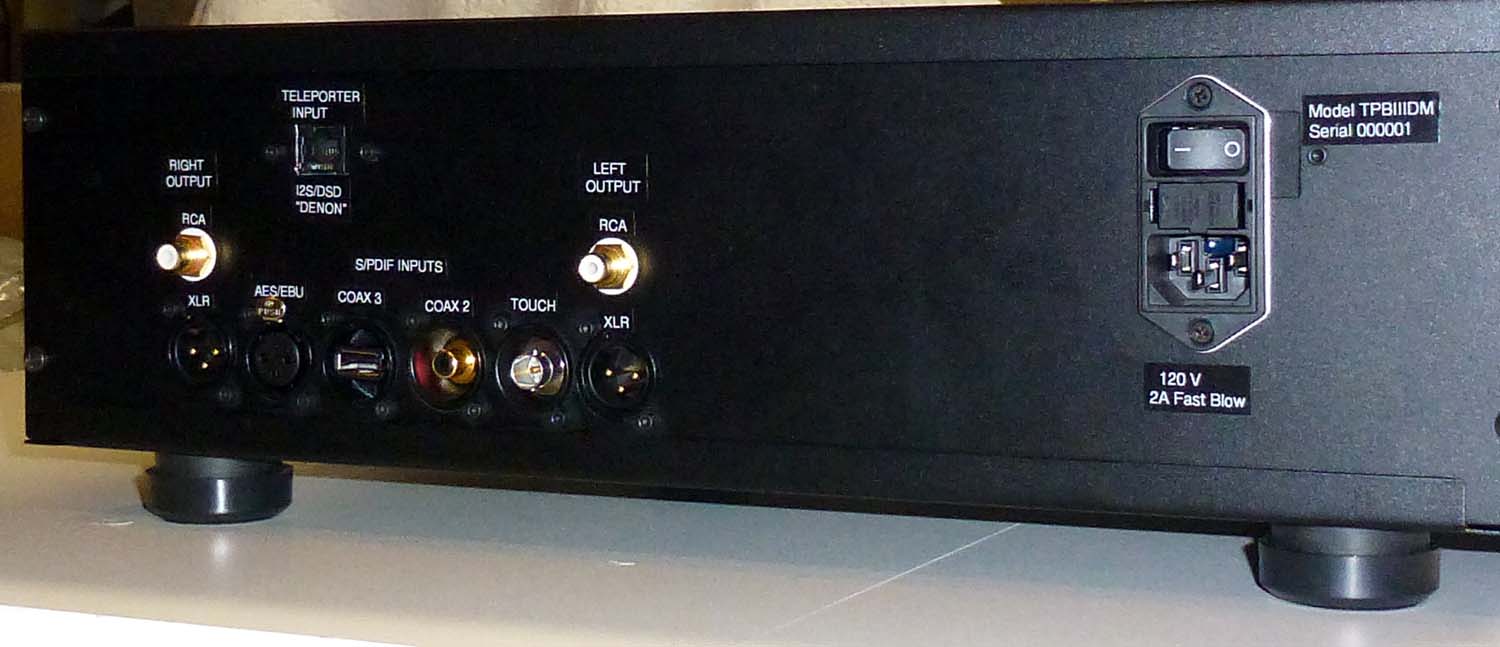

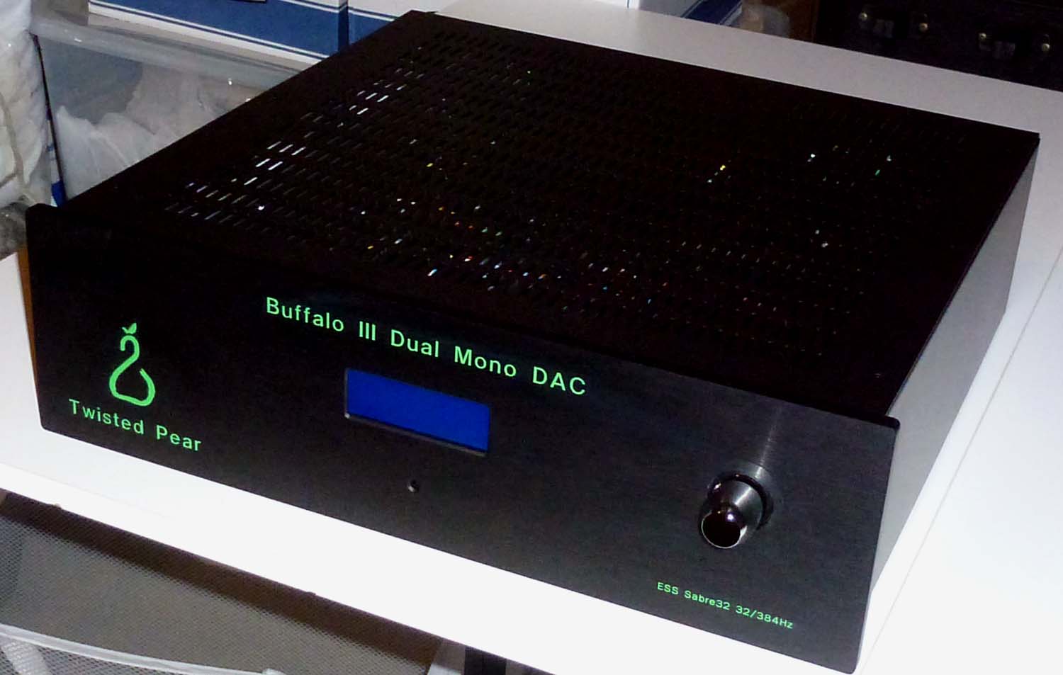

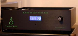

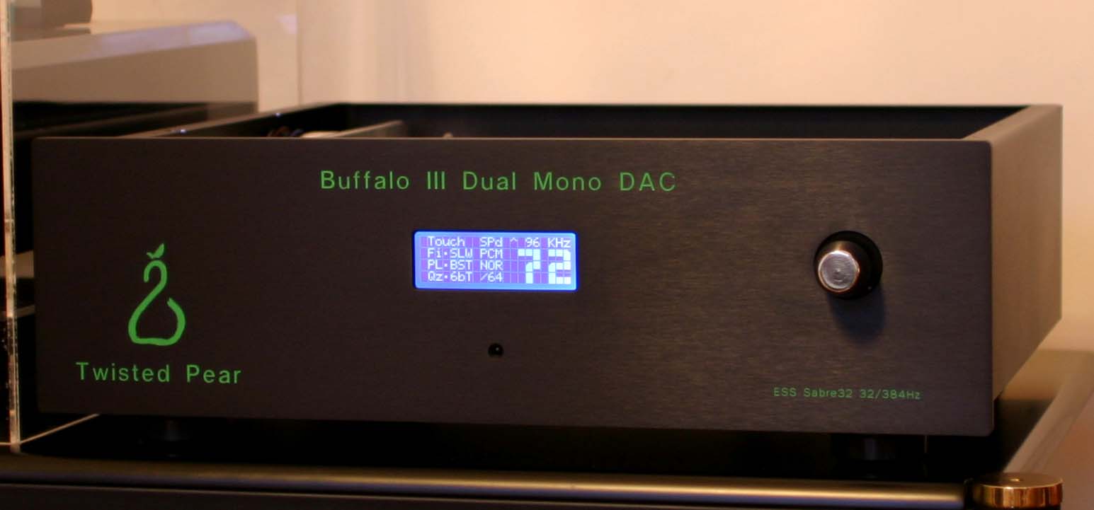

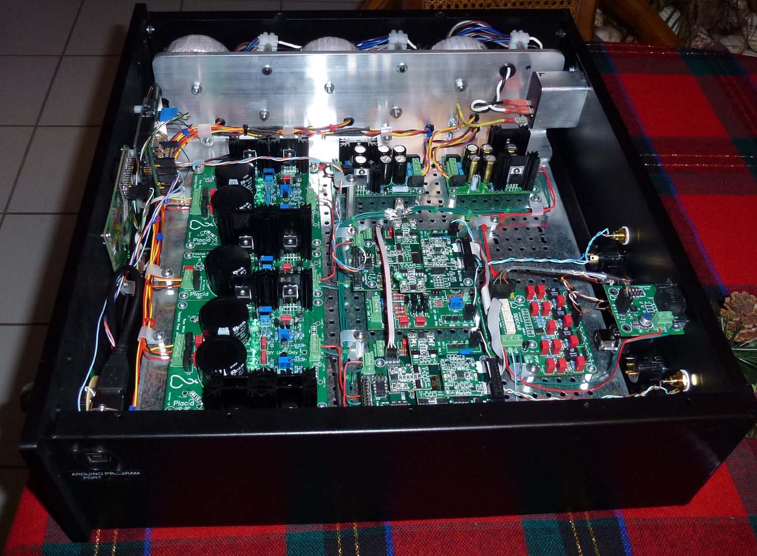

I finally finished my dual mono BIII. Waiting for my GB Amanero USB/I2S module, and I have to finish wiring the remaining inputs.The USB input is just stuck in there as a filler. The blue LCD will eventually be replaced by a green one. Enclosure is a Hi-Fi 2000 Pesante 3U. Machining/engraving done by Hi-Fi 2000/Modushop. I did the color fill using Testors enamel.

Nice. Did you mean 32bit/384 kHz on the front panel?
Best,
Anand.
The "bit" part was not my concern. My concern was the part after that.
384 Hz
vs.
384 kHz
:D
Anand.
I'll have to go back and look at the plan........:eek: OK, I can tell you how it happened, but it still ends with it being my fault. I had the wrong front panel size at first, started over and screwed up. I been lost in the woods and didn't notice....
It looks great, I had a similar thing happen recently, too deep in the forest to see the trees:D
Nobody else has a 384Hz model
That is a nice looking build. Can you give a little information about the display. I would like to have some for the next one I do for myself. I would love to be able to use a VFD for the display. I just like the look.

The LCD is an 20x4 white on blue display with a Hitachi HD44780 LCD controller. He uses it with 'LCD ExtraIO' from electroFUN. This is basically an port extender allowing one to control the LCD using the "two-wire interface" (I2C). The controller is an Arduino Uno.
Thanks for the kind words. I was just getting to enclosure choices when I decided to add the Arduino/LCD display. I was overwhelmed by it all and followed HiFiduino's recommendations for the HD44780 protocol displays.
INTRO H i F i D U I N O
Some folks, like DQ828, Corpius, gwiske, and bigpanda that can do code used different type displays. IIRC VFD displays will require external power due to the high mA requirements.
I had this big rats nest of wires on a breadboard with my Arduino/LCD until Corpius put me on to the electroFun LTD I2C LCDextra IO board. That reduced number of wires to run LCD. You do have to replace the Arduino LCD library with electroFUN's for it to work and add some lines to the code. Not sure if that works with VFD displays, but anyone that goes the LCD route should look into it. Not very expensive, like $9 US.
