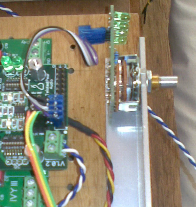

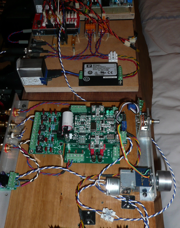

At the moment I use the 4 way Switch module to select between sources as per the photo.
I want to use my Arduino to switch sources using the same inputs that the Switch Module uses being (pins B0=6 & B1=8) I have tried what I thought would work but it clearly didn't so I expect my understanding of how the switch Module works is defective 🙂
Can anyone advise me how I might do the switching with the Arduino via the Switch module input.

I think that is just a 4-way spdif to ttl level converter. It is not a switch module. In Arduino you will need to program register 18 to select the corresponding spdif input pin

This is the input selector I'm referring to, I was hoping to finish climbing my low tech mountain before climbing your high tech mountain 🙂

I started this journey before I found out about HiFiduino & I would like to finish it, if nothing else I will learn lots on the way. I'm almost there, if my source switching had worked I only had 1 thing left to implement, the screen.

Oh, I understand now. Basically it is a two bit switch: either pull the bit high or low with arduino. I just read your thread over at TPA and your logic is correct. If you use the level converter you need to connect GND from the level converter to GND on the i/o connector (I think pin4)
I did that but when I power up the Arduino all the lights on the BIII can on even thought it was turned off, which freaked me out😀

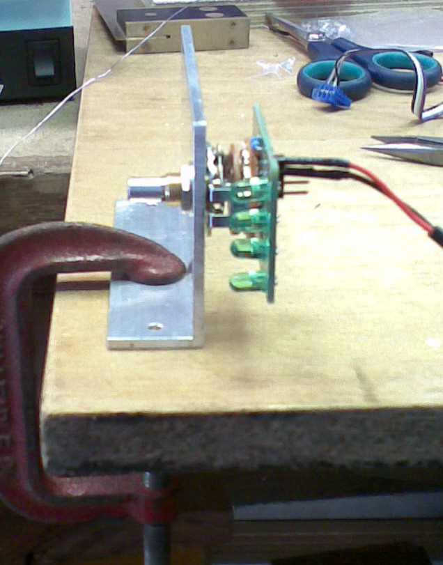

Iv'e done a bit of testing on the switch unit, I connected a voltage source to the power inputs of the switch module & then read the output pins that go to pin 6 & 8 on the BIII.
I expected to see the output pins vary from High to Low, I tested between the power ground & the output pins. The pins go low to ground but at no stage does a voltage show on the output pins, the reading I got went like this.
Input 1 No reading & No reading
Input 2 To Ground & No Reading
Input 3 No Reading & To Ground
Input 4 To Ground & To Ground
I haven't had a chance to test the BIII inputs
