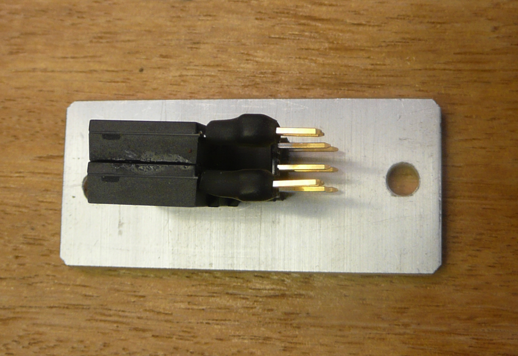

According to the schematic of the switch, that is the correct behavior. The power is only to power the LEDs and not needed for switching.
The switch basically alternates between open connection and gnd. If you want to mimic this with arduino, then
Open = set the pin as input, write LOW to disable the pull up resistor so that it is basically an open circuit
Gnd = set the pin as output and write LOW
In this case, since you are not applying any voltage to the pins, you might not need the level converter (there are no levels to be converted)

I had just come to the computer to report the same thing, as I just had the opportunity to test the 6 & 8 pins & as you already know they have 3.3v on them.
My plan was to (because I'm coding challenged) use a couple of tiny solid state relays I have as switches, & trigger them with the code I have already written.
I have no idea how to change an Input to a Output mid code, I thought they where either set as one or the other in the void setup and then left that way.
I am a carpenter so I can read plans, not schematics 🙂 which is only too evident by my reading of the switch schematic.
Bye the way, thanks for your help.
I may have upset things in the BIII with my little mistake, because after the mishap I reconnected the switch module as before & Input 1 was connecting when the switch module was on Input 1 & 3. Also Input 2 was connecting when the switch module was switched to Input 2 & 4, which means I dont have access to inputs 3 & 4, Input 4 is the one I have been using for the Coaxial SPDIF and it was very stable, where I have my toslink on Input 1 & it has lots of dropouts.

Everytime you power cycle the DAC it will reset. That is a strange behavior. There is no way to combine the inputs unless you tell the microprocessor to combine the inputs. Check the other switches especially switch 8 of SW2
Iv'e done a bit of testing on the switch unit, I connected a voltage source to the power inputs of the switch module & then read the output pins that go to pin 6 & 8 on the BIII.
I expected to see the output pins vary from High to Low, I tested between the power ground & the output pins. The pins go low to ground but at no stage does a voltage show on the output pins, the reading I got went like this.
Input 1 No reading & No reading
Input 2 To Ground & No Reading
Input 3 No Reading & To Ground
Input 4 To Ground & To Ground

That is why I wanted you to measure it before connecting it to the EXT_IO at the BIII, so you would not apply a voltage when you should not. I have never worked with the selection switch, so I had now way of knowing that Pin 6 & 8 only go LOW or Break the connection. I did also expect them to go HIGH at a certain point. Sorry I told you to buy the level converter 🙁, but you'll need it anyway when you are going for the HiFiDUINO approach. 🙄
To set a pin to an Input: pinMode(pinNumber, INPUT); (where pinNumber is the number of the pin you want to use)
Set it to an output: pinMode(pinNumber, OUTPUT);
You already know how to set the pins HIGH or LOW

Thanks again for your help I have installed the relays that I had sitting around doing nothing & now everything works. I can switch between the the sources (must buy more sources or build some sources 🙂) and I am back to the SPDIF Coaxial which appears to be working fine, unlike the toslink.
All that's left to implement is the screen.

You have to make sure pin 6 and 8 are pulled up. (say with 10K) That is normally done by the controller. With a stock B3 this is done by the on-board controller. You your case you need to be sure *your* controller does the same thing, or do it externally.

Thanks. The spdif input for the sabre32 should be rock solid. One idea is to directly connect the toslink output to the input of the BIII and avoid all the "unnecessary" level conversion. One way to do this is to tap the ribbon cable. Another way is to solder to the pins at the bottom of the pin header
