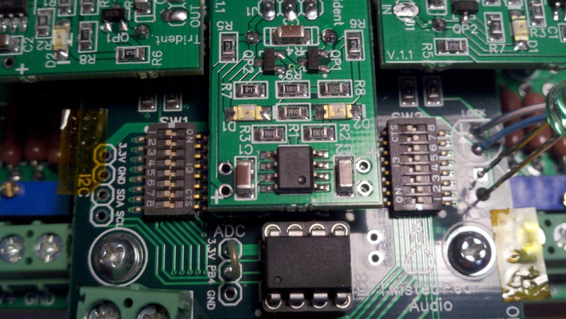

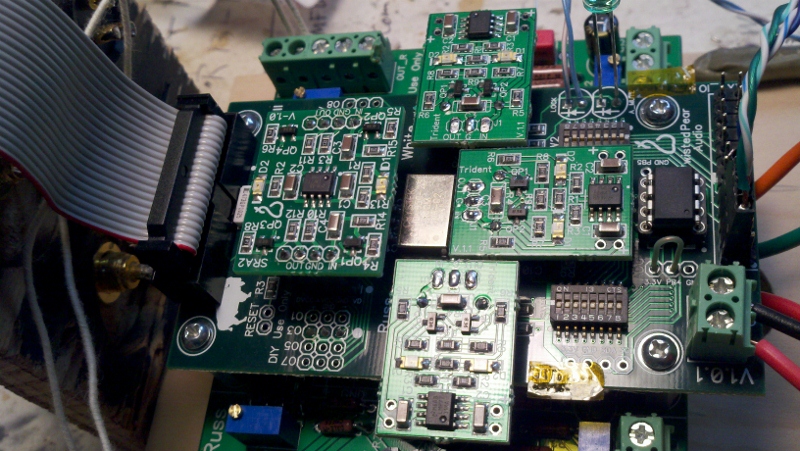

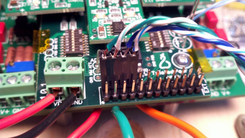

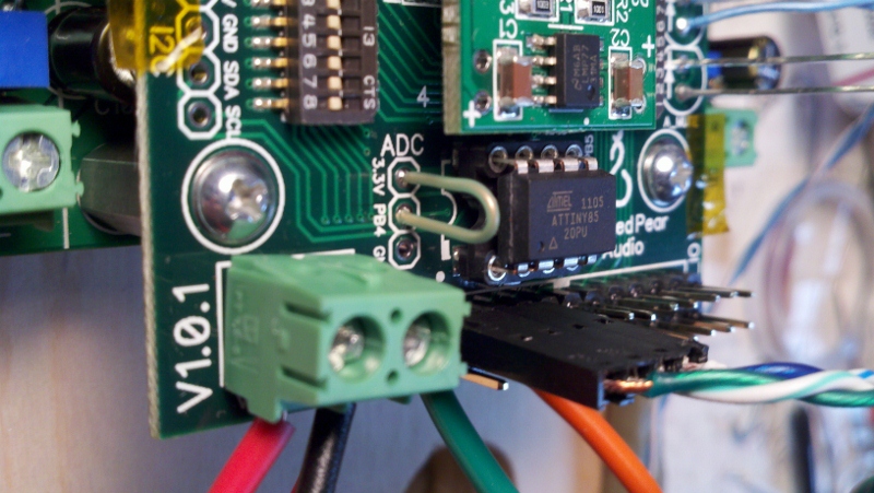

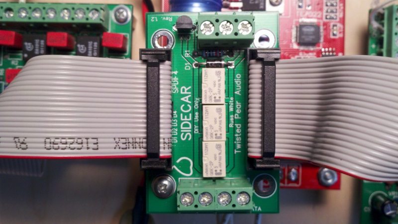

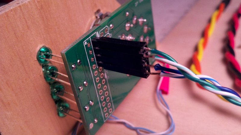

I have been assembling the buff 3 kit with the sidecar, mux and no volume pot. I cant get a signal lock. The mute led is on always. Jumpers 1-12 installed, switches set off except sw2-8 is on. Jumper to bypass volume control. 75R on mux for spdif. I'm not sure of the input selector wiring, no manual. The input selector changes the leds but no sound or lock.Theres some pics. Any idea what I am forgetting?

No I didn't. The guide said not to connect ground on Spdif. Man I'll feel really stupid if that's all it is! I'll try it to now. Thanks.
That is correct. It says you need to connect the SPDIF wires to + and - on the module. For SPDIF you do not use the GND connector on the module.The guide said not to connect ground on Spdif.
If it is ordinary S/PDIF I think the manual say to connect the second wire to "-" and not to ground. At least that is how I understood it.

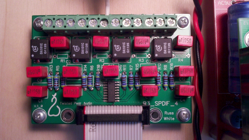

Don't you need to mount termination resistors (R1-4)? I cannot see them even if you write that you are using 75R.

That was it. That's what happens when you work way too late on a kit trying to get it up and running. I thought it was weird to not have a second wire on the Spdif. I am listening to the buff 3 finally. Sounds great. Thanks for pointing me in the right direction. I have the 75r on the bottom of the mux to make it easier to change later. The legato 3 plays fine without caps on the output with the pass labs aleph 30 amp.

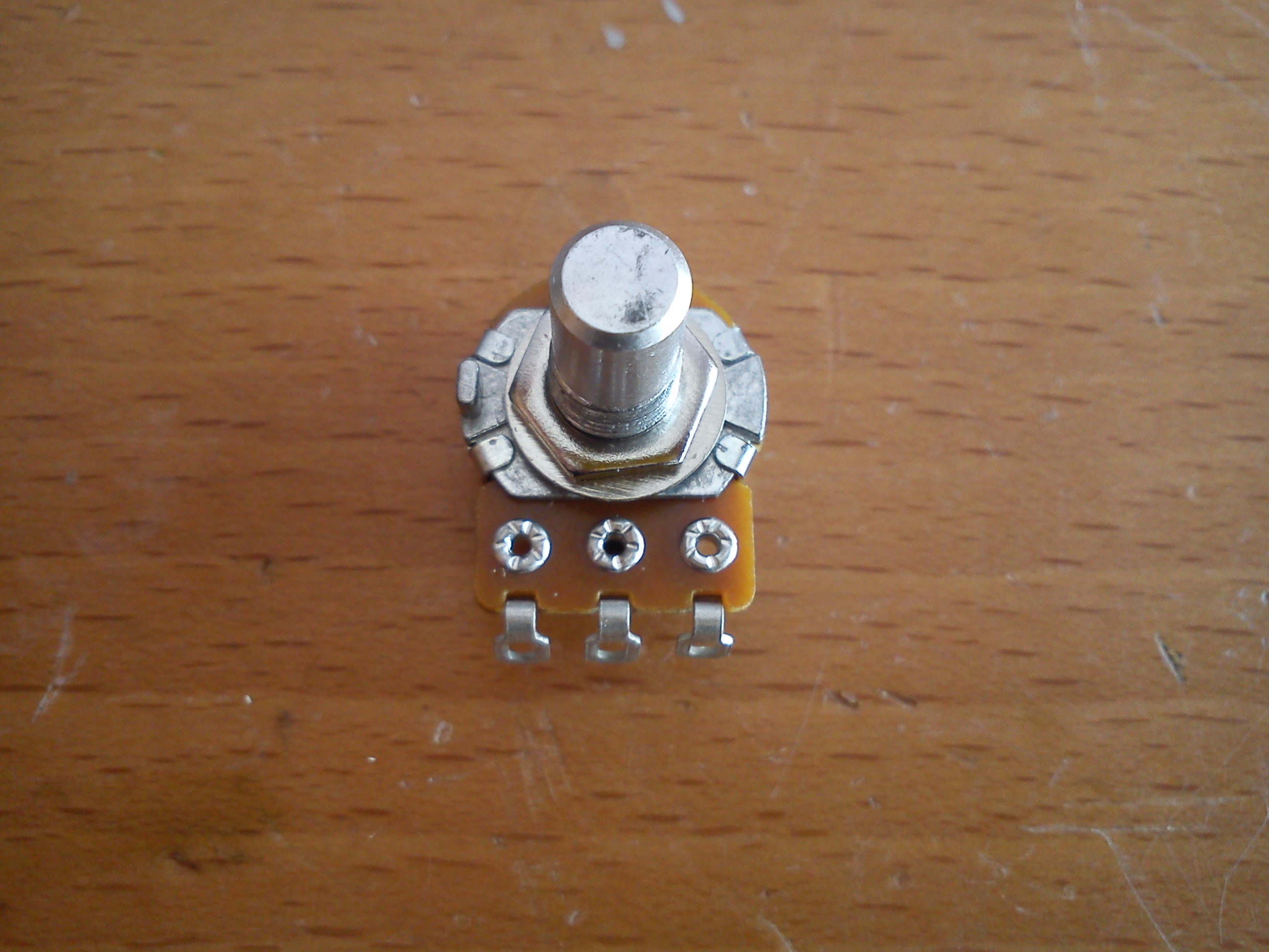

Finding which pot connection is CCW and which is CW is pretty simple. Just turn the pot completely one way or the other. Then measure the resistance between the wiper and each side. The lowest resistance matches that direction's extent. Easy right?
Thank you Russ
