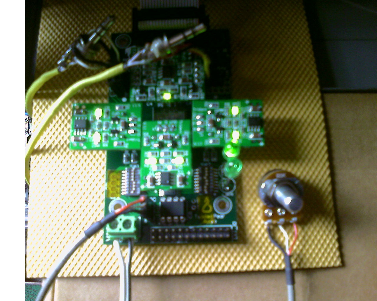

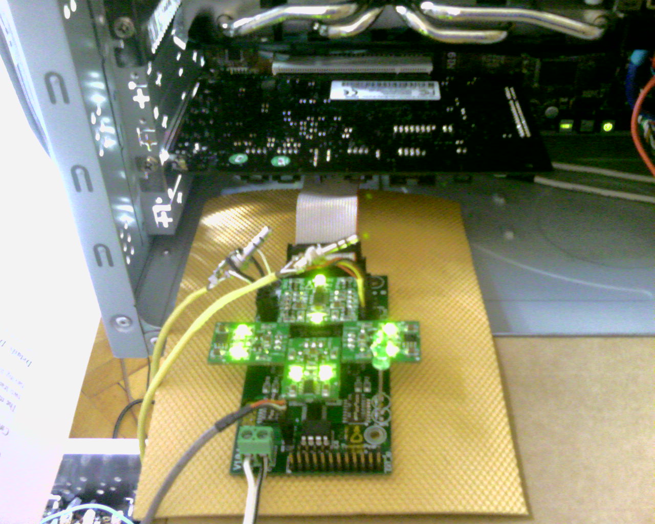

I have successfuly running BIII playing mp3, flac, dts-hd msr, mlp files.
However there are some problems.
Don't know why but pot isn't working, when I turn the pot cw sound disappear imediately and BIII needs to be turned off, windows volume control is working.
In my BIII only two channels are working. I switched DIP input remapping setting to Off, diff. mode - true, didn't install any jumpers.
Also have a turn on-off thump, but it can be from sound card as was before.
Any thoughts how to make it work as intended?

AndriyOL,
Good work so far!
I am sure we can sort you out, but lets move the conversation to the support forum so as not to spam the thread with help for your specific build.
Thanks!
AndriyOL,
Good work so far!
Thanks!

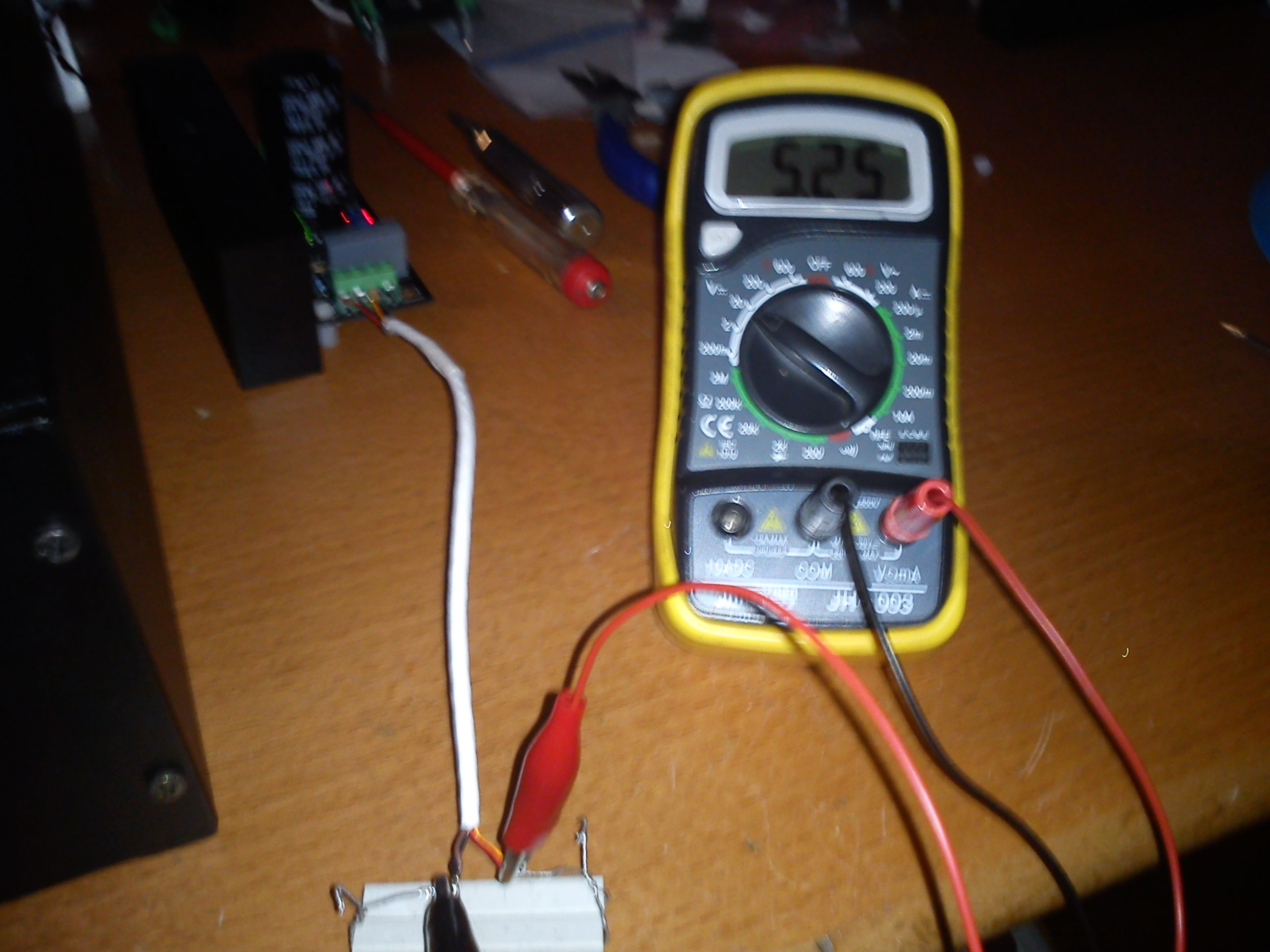

Extracted from leon van Bommel B3 manual in your web site:
"The standard board requires an input voltage of 5.25V and it draws approximately 440mA when one is using the recommended set of Trident shunt regulators"
Are you sure the B3 draws 440mA with combo Tridents connected?
merlin...
Why not measure yours? I have been following your problems on the Salas Bib thread, and it appears to me that you have some kind of problem, as over 700 mA in the reg should be plenty. I have found the Bib regs to work great with only 100 mA shunt current, and I doubt the B-II is drawing more than 500 mA.
If I were you I would measure the current draw on your B-III with your meter.
The reg was going on perfectly for BII 5.5V I only changed the 5.25V for B3 & doesn't work?
I have sold my old B2 so can't measure.
That's the measurement of Russ and at least 2 other users. Russ' initial estimate was 350mA, but that was a bit optimistic.Are you sure the B3 draws 440mA with combo Tridents connected?
As a sidenote: one of my BII's with the Tridents, Mux and Toslink module pulls 450 mA from a Placid (CSS=+50mA), the other side with just Tridents uses slightly less.
Measure the B-III, that is what you need to know. Just hook up some other supply, and measure the current draw, any 5 volt supply with adequate current will be fine, then you can use math to get the current draw at 5.25 volts, or any other voltage.
With a dummy load 11 ohms (two 22R in parallel) reg gets 5.25Vout so 0.5A😕
