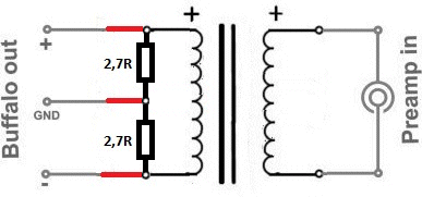

Got a bit confused now:
Output of buffalo is loaded with either 2pc of 2.7Ohm or one 2.7Ohm wire with ground in the middle into the transformer, yes?
This is the best way, linestage not involved in the 2.7Ohms?!

Output would be loaded with 2 x 2.7R resistors (one for each phase), and GND in between them.
How i come up to approx 1.85K impedance is because i have calculated it.
LL1933 should work according to Lundahl (up to 50mA) and does have primary impedance of 0.8R per winding, and 85R on secondary.
So on the primary side i have 5,4R + transformer 1,6R. Transformer ratio of 1:16 equals 256x impedance ratio. so 7x256 = 1792ohms plus the impedance from the secondary 85/2=42,5R (since they are paralelled) so in total 1834,5R simple as that.

No, both are not good. The second is worst as you will get DC through transformer.
Only connect the Ground to the centre of where the resistors meet.
Connect nothing to the transformer's centre tap.
You do not want any potential DC to go through the transformer - the DC resistance of the Primary (or any part of it) must not be in parallel with the resistors, or else some DC current will flow through that part of the Primary. You was all the DC current to go through the resistors, to ground.
If the two resistors are well matched, then both extremities of the Primary will sit at the same voltage. That means no DC current through the Primary of the transformer.
Is that clear enough?

Yes, i think so. Like my second example, but remove the center tap from the middle/gnd between the resistors.
But what is the cap for, the 0.33uF one you had between positive and negative phases?
Also when running primary side this way and you look from the secondary side (1:16). Does the reflected impedance look like (2,7+2,7)x256=1138,4R or (2,7/2)x256=345,6R - that is, do they look like series OR parallel?

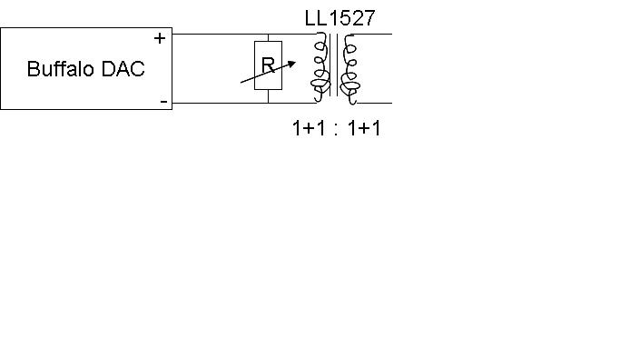

Hi Joe, do the resistors need to be terminated to ground? I have bought a Buffalo DAC, haven't assembled it yet but for an IV convertor I was planning on an approach shown in the diagram ie I will feed the DAC output into my Lundahl transformer, and as I prefer not to use a preamp, I will vary level by use of a switched resistor (24 position switch) also across the output - its easier if I can just use a single resistoer across the 2 phases rather than having 2 resistors (which then requires a double pole switch). What do you think?
Yes, in my opinion that is what will get you the max results. It does two things, converts DC voltage offset to current offset, and creates the lowest impedance possible (our topic is Txs) into the Primary.
Transformers works at their best when driven from a low impedance. The output impedance of the Sabre DAC is quite high, many times higher than voltage DACs. So the low impedance cannot come from the DAC itself, it in a sense has to come from the Ground. Simple as that. (Current type DACs like B-B does this naturally as the have a very high output Z and relies on Ground to make it low). And Sabre DACs are also at their most linear when seeing a Lo Z current mode. The usual "common garden" solution is to use an opamp with a Virtual Ground approaching Zero Ohm. But this is a feedback trick. Normally with "current" DACs with DC voltage offset, this means that the Zero Ohm has to actually float at the same DC voltage offset of the DAC (usually 1.65V).
But the Sabre DAC is very different beast, it has a fixed output Z of 780 Ohm. Paralleling four phases will give you 195 Ohm combined, eight will give you 97 Ohm. These are all relative high - not good for Txs. But ahh... that output impedance also acts as a current limiter when shortened to ground, and in the Sabre DAC means we can do something we cannot do with any other DAC: Pull it to Ground! The DC offset current is 1.65V/780R = 2.1mA per phase. It cannot go higher than that - so we use that to advantage. We can now construct a near REAL EARTH rather than a Virtual one.
The downside? Only slightly more heat generated by the DAC's outputs and that about 3.5mW phase per side. Negligible. In total about 50mW.
The DC offset current we have created must go through the resistors and not the transformers. The resistors should also be 1% or better matched.
