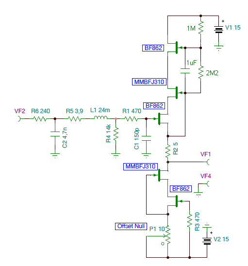

The link to the post showed two schematics and naughtily I sort of added/ameded one a bit... hope nobody is offended. This is basically a solid state version of our Super Linear Cathode Follower, so we can call it a Super Linear Fet Follower.
Cheers, Joe

Any comments on the benefits of the SLCF compared to the simple cascoded source follower circuit that I use? This is the 2nd transformer output Buffalo DAC that I've built. The first one used 1:1 transformers and a bipolar diamond output buffer. And it was based on the original ES9008 Buffalo kit with simpler power supplies. This new version has better supplies, newer ESS chip, low value resistive loading to ground (thanks Joe), step up transformers, and the FET buffer. It sounds much "fuller" than the first version. Both have great detail but the first one was a bit lacking in body. This version seems to have fixed that and is very enjoyable.
---Gary
Joe,
---Gary
Hi Gary
I don't want to draw the wrong conclusion, but if you are using the fet follower with the constant current source and not the bootstrapped device I am showing, then there is quite a difference. Essentially the SLFF (and SLCF) runs in both constant current and constant voltage modes. It is common to see the CCS - but its also important that the actual follower element sees a constant voltage. What in reality is happening is that input (Grid or Gate), the output (Cathode or Source) and static element (Anode or Drain) are all seeing the same AC signal. Normally followers are one hundred feedback devices, you are using a trick to alters that state.
This is a quote from another forum:
"Good to hear from you John. It is really fun to watch the SLCF in action. If a 10.00 Vrms signal is applied to the grid, there will be a 10.00 Vrms signal coming out of the cathode, and the plate will also be following along with the 10.00 Vrms signal. They all move together as one. There is no gain or loss of signal, from in to out.... Paul Speltz"
Cheers, Joe

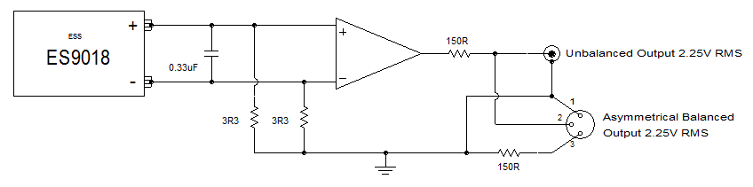

While this is about transformers, I think the schematic below works along similar principles - that you can choose a step-up transformer for the necessary "gain" or an actual gain stage. They key is to understand what is done to the Sabre DAC itself: This, in my view, is the way to get the most out of it, bring that load value as low as you can get away with.
Cheers, Joe R.

But, since my line-stage is balanced with 5,4dB gain on each phase - then wouldn't it be better to connect output from each phase with a 2.7R resistor to GND, then maybe the cap between both phases (what does this do in this specific case?) and then into the step-up transformer.
In my case the output from the transformer would go straight into the volume attenuator (50k R2-R log attenuator between the phases not down to GND) with approx 15cm wire, twisted and then maybe 15cm wire into my tube-line-stage.
Thare shouldn't be any trouble running from the step-up into the volume right? since impedance matching seems quite fine ~1.85k into 50k.
Also Joe, wouldn't it be better skipping the GND connection on the output, at least when i run transformer - to keep DAC-GND from my Line-stage GND?
Thanks alot for taking your time helping in this thread so far 🙂
