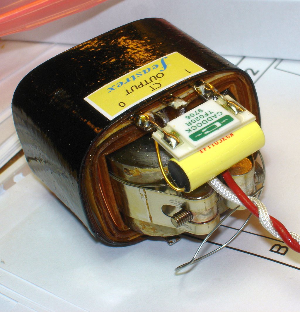

With the quality and price of the Feastrex transformers, a top notch quality resistor is in my oppinion mandatory. You might want to try these resistors:
* TX2575 bulk metal foil type
* Caddock Mk132
* Caddock USF TF020/USF340
* Tantalum by Shinkoh
* PRP PR9372
/S.

Hi, staccatiss,
I had simply inserted load resistor in secondary as their recommendation.
I used 2.4k ohm generic metal film I just found in my junkbox.
I felt "brightness" in treble decreased with Finemet transformer in comparison to previously used I/V stage. That's not always, but with some recordings.
Later I realized this kind of brighter treble of previously used discrete op amp I/V tend to have fogginess - this actually masked details in some extent - at the same time.

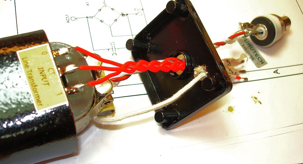

I have finally connected the synchronous Buffalo2 to the SDTrans384 running version 17 and 3.11. I am now also using the Feastrex urushi-treated transformers with the Caddock TF020 4k02 Tetrinox resistor, the Reliable Capacitor 10n Teflon and Tin foil capacitor as transformer load, cryod purest solid core copper wire, and solid core cotton insulated silver wire together with Furutech rhodium RCA connectors. The Buffalo2 has no Tridents. SDtrans and Buffalo2 are powered by separate transformers+rectifiers+regulators.
Music has never sounded as good as this before! Most notably, the music swings, that is, the music makes my feet tap automatically, and sounds organic. Stereo depth/front/sideways has increased. And, there is a blackness of the background and in between instruments that is awesome. Sibilants (for ex s-sounds) sound non irritating (when the recording is not too bad). Voices are fantastic. It is easier to hear individual voices in a choir, and the echo of Mark Knopfler´s voice in "Private Investigation" is easier to pick out.
During playback of one of my reference songs, the saxophone sounded as it stood just to the left of me - I almost fell of my chair. Almost scary.
The only weakness I find is that the bass could have a bit more weight but maybe I need to get bigger speakers instead.
Bunpei - thank you very much for bringing me the SDTrans and Feastrex transformers!
/Staccatiss
