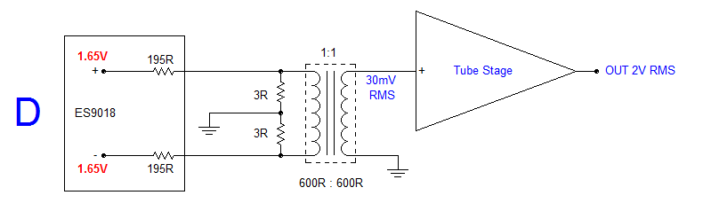

Just thought I'd add this:
This is proper I/V Converter. The input to the Tube Stage will see no DC - a variety of tube circuits could be used, but decent gain, low noise, are minimum requirements.
Cheers, Joe R.

Hi Richard
The idea is to achive current mode.
The otput of the DAC needs to see only a small fraction of it 195 Ohm output impedance otherwise it will not be working "current" mode.
If you don't ground, you would have a single 6R and it would be in voltage mode and most of the two phases would cancel out and you'd get 30mV RMS approx. Just no point doing it that way.
Note that internal 1.65V offset, the Sabre DAC is unique in that you can still ground it to 0V (don't try this with any other current DAC - it may not survive - and don't do it to conventional voltage DACs since they all have about 2.5V). So essentially shorting the output to virtually ZERO Volt, means the offset now become a current offset of 8mA.
But getting a high ratio 193R/3R = 65 - is the only way to get current mode.
Other than that, the suggested idea is pretty straight forward.
Much simpler to use twin 330R as suggested with 1:1 transformer, even if the fancy Japanese kind exotic transformer.
Cheers, Joe R.

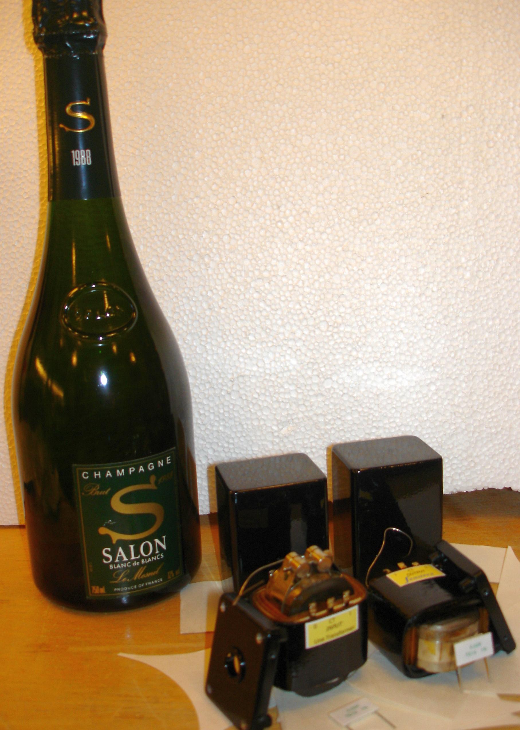

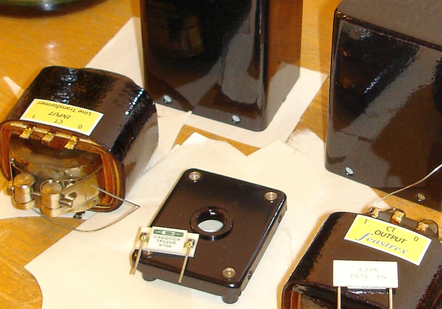

I ordered an urushi-coated pair of Feasterex transformers and they arrived a -few days ago. Attached are some photos.
I am now awaiting some 10nF Teflon and tin foil caps from Percy Audio and cryo treated mono crystalline copper wire. Then, I will hook everything up to my B2.
The champagne I have to sell to finance the transformers...

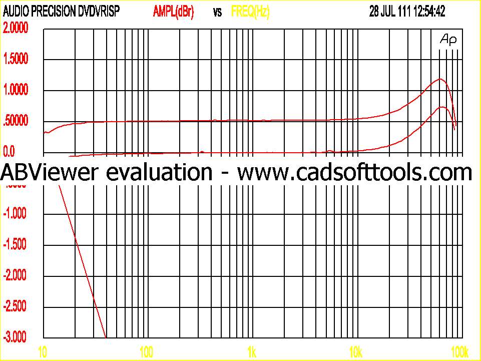

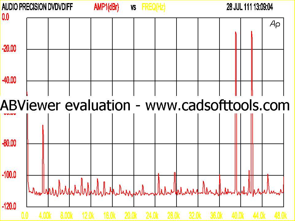

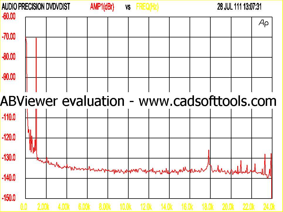

One very good solution, in my opinion, is to use the 3575 OCC from Sowter (http://www.sowter.co.uk/pdf/3575.pdf); it is 1:1.
I use the output from buffalo to feed a 15 ohm resistor (current mode) for + and -.
Then I connect each end of the primary, and the center to ground.
On secondary I put a 3k3 or 4k7 ohm in palallel, unbalanced mode, then a CF of 6922, tube power supply with a good filtering.
Trimming this resistor I can change the frequency response with a little change on signal amplitude.
In attach you can find a frequency response with a 24bit/192Khz come from a AP x585; the ressitor on secondary is 10k , I got 0,7 db of increment at 70 kHz.
With 4k7 I got -1 db about 40Kz, also good for signal at 24/192Khz.
The S192_70, is a signal 1 Khz, -70 db 24bit/192Khz; good performance
The S96_diff is a test, 24/96Kh,z with two signal at 40Khz and 44KHz, also in this case a good perf.
This before a little modification on tube power supply to have a better residual noise.
Bye
Walter
