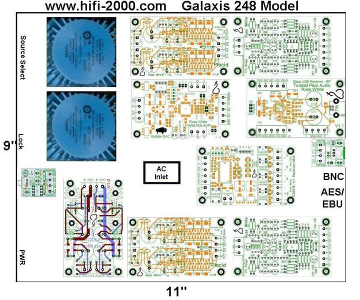

Possible boards location (boards are to scale on the drawing) into a possible nice enclosure from www.hifi-2000.com, the galaxie 248. Dimensions are 40mm height, about W9" XD11".
Naturally, the Placid and Counterpoint for each channel can be installed over each other, but the heat dissipation is probably better this way.

Algar_emi said:Possible boards location (boards are to scale on the drawing) into a possible nice enclosure from www.hifi-2000.com, the galaxie 248. Dimensions are 40mm height, about W9" XD11".
You will want to stack the buffalo with the counterpoint boards, or at least have them right next to each other. Keeping the current-output path of the DAC as short as possible is very very important.

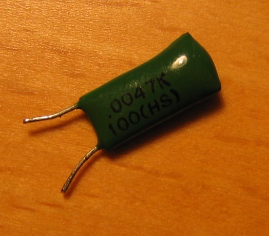

woodturner-fran said:Had a good listen there over the last hour or so and don't notice the "sch" or sibilance that you speak of AVR300. It does seem to be more detailed though if thats possible, and the soundstage is different- nicer to my ears!
Is it possible that maybe if its a bit more detailed you are getting the source material in a more ruthless fashion.
Have to say I'm all in favour of this mod.
Fran
EDIT: do you all leave your buffalo turned on or off?
I undid the cap mod, and found the system "playing" again. No sibilance. Then I redid it, this time with some well known BC polypropylene 4n7 caps. This time there was no sibilance.
Wonder what those 0.0047K things is, properly inductors or something even worse
You're right, Fran, the source material is on display here. S... in - s... out. The way I like it.
