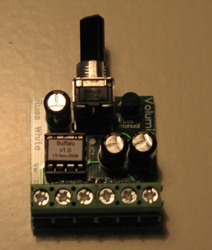

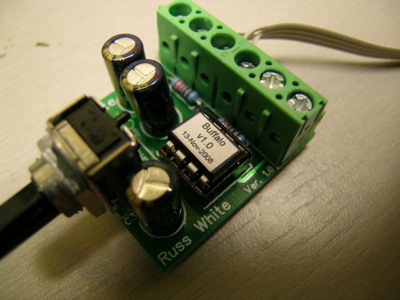

123chris said:I received my Volumite today together with the comperator. Great service!
I have one question:
Is the orientation of IC1 correct in this way?
Thanks.
Chris
Chip is backwards. I will improve the stickers.

Hi Brian/Russ,
I received the volumite today. I have a q: wil it work when using a 10k or 25k pot-meter?
thx.
thx.
dday_one said:Hi Brian/Russ,
thx.
Yes, either should be OK. But I would use the 10K.
Cheers!
Russ
