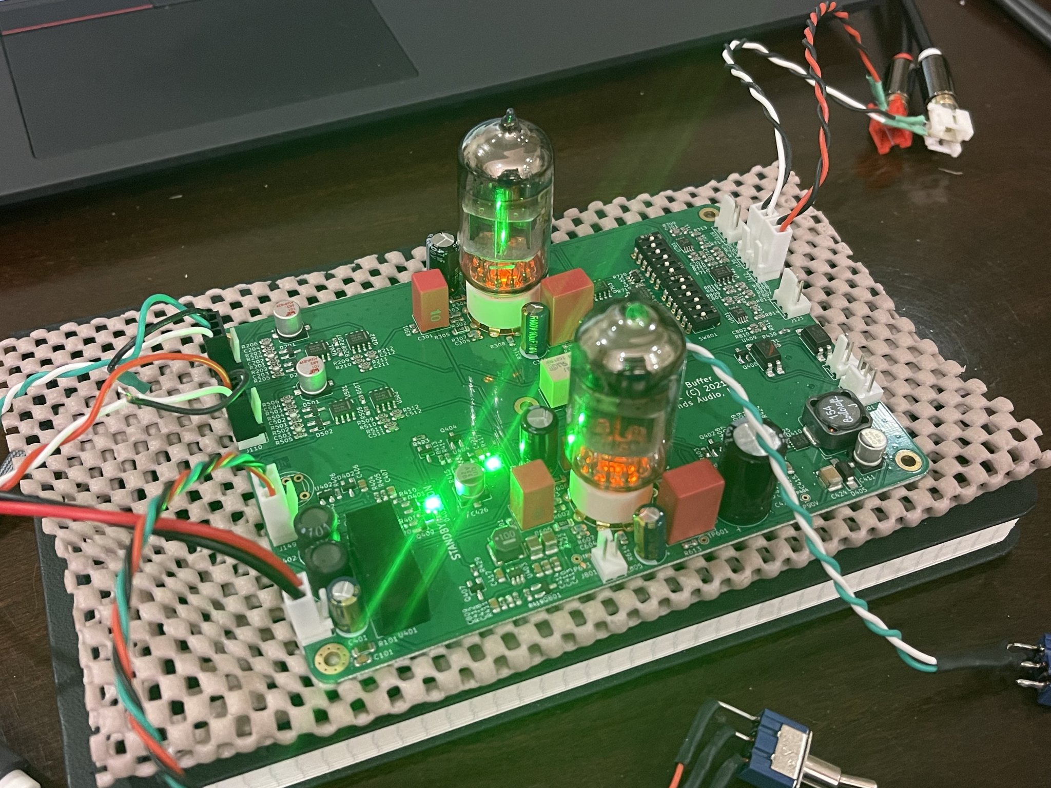

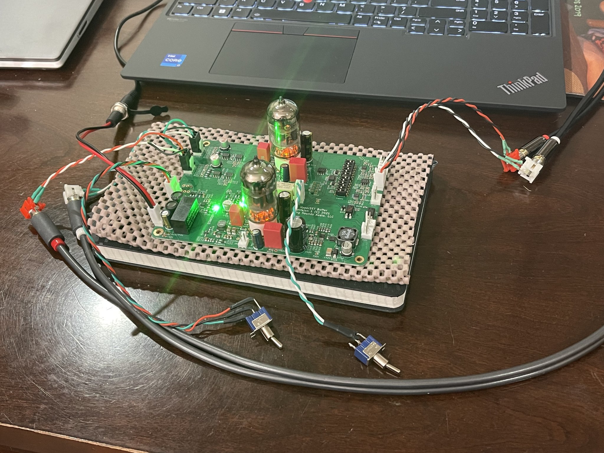

The assembled boards have arrived. Looking very good. I will setup a test rig to verify they work before shipping.
I will also need to make a quick start diagram showing how to connect everything and how the power switch and the tube bypass switch works. Plus details of how to use this to control the startup logic of an external amplifier for graceful power on and off.

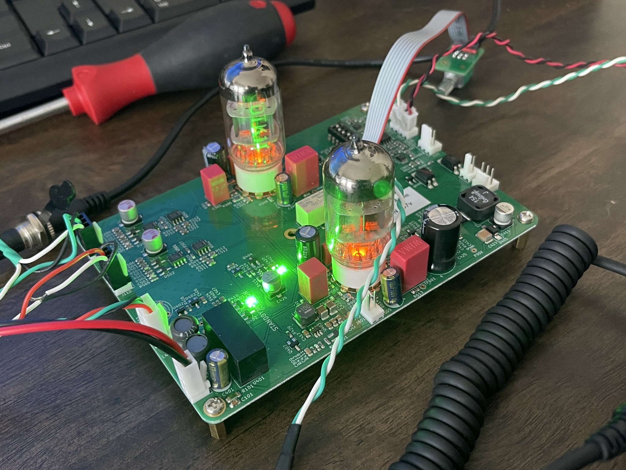

I made the connectors and testing the first one with some music and it sounds great. Don’t forget to change the gain on DIP switches from the default All ON position to desired value. 0dB is All Off, 6dB is 1=4=ON, 14dB is 2=5=ON, 20dB is 3=6=ON.
I have installed the 6N1P tubes in this case. I’ll leave it on overnight to burn in.

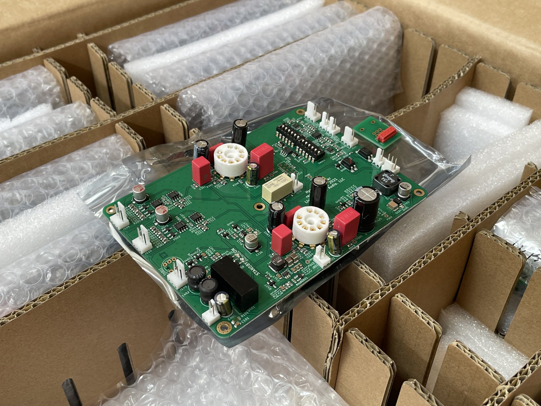

I have fully tested all boards with matched pairs of 6N1P tubes and prepped ready for delivery. Testing includes listening to audio output on balanced out in addition to sing or ended out. My shipment of Molex KK 2 and 3 pin connectors just arrived so I am going to include a full set of connector shells and crimp pins so you can be up and running right away. That’s 6x 2pin and 6x 3pin and 30 crimp pins (a $7 value in connectors).

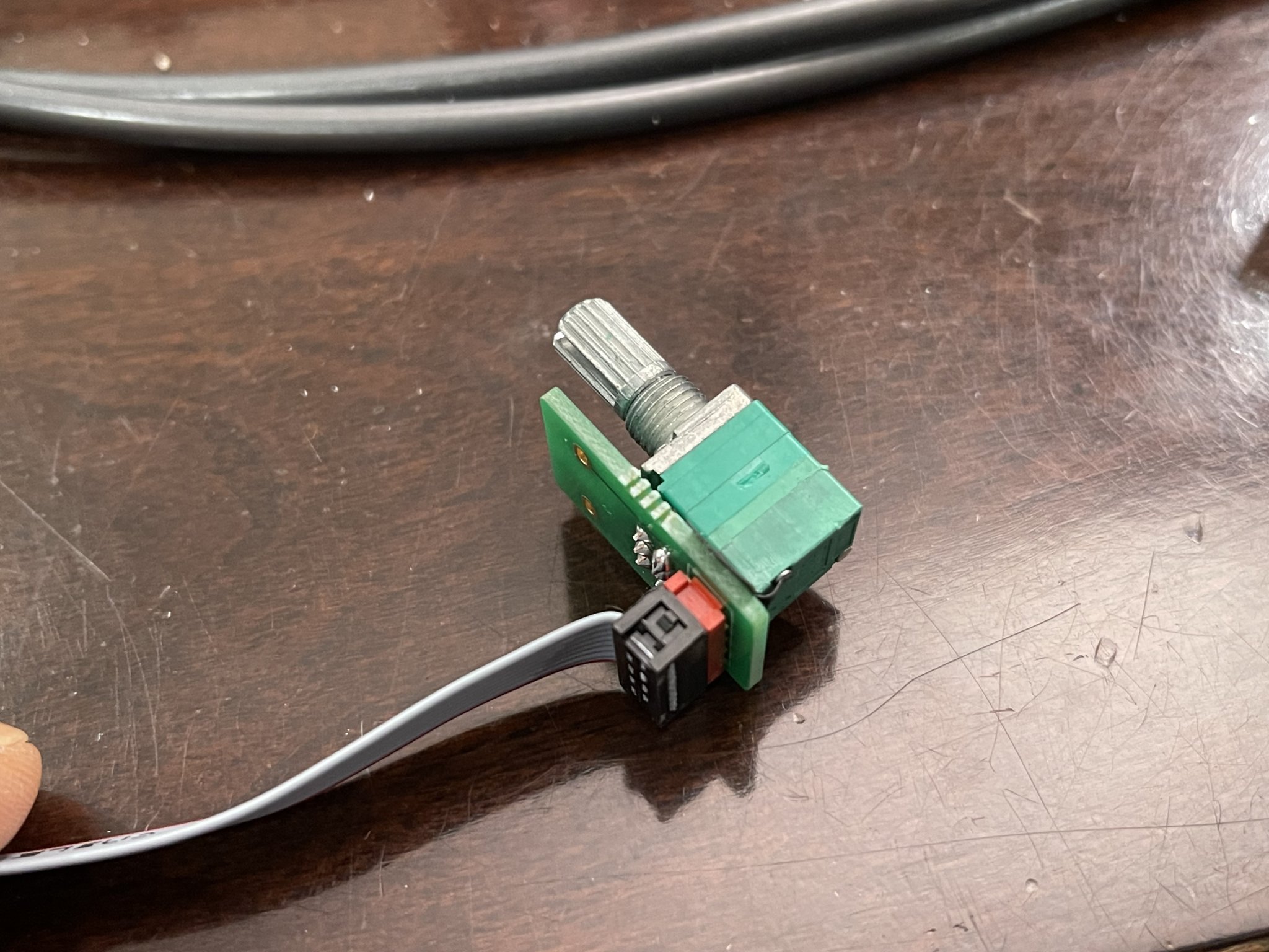

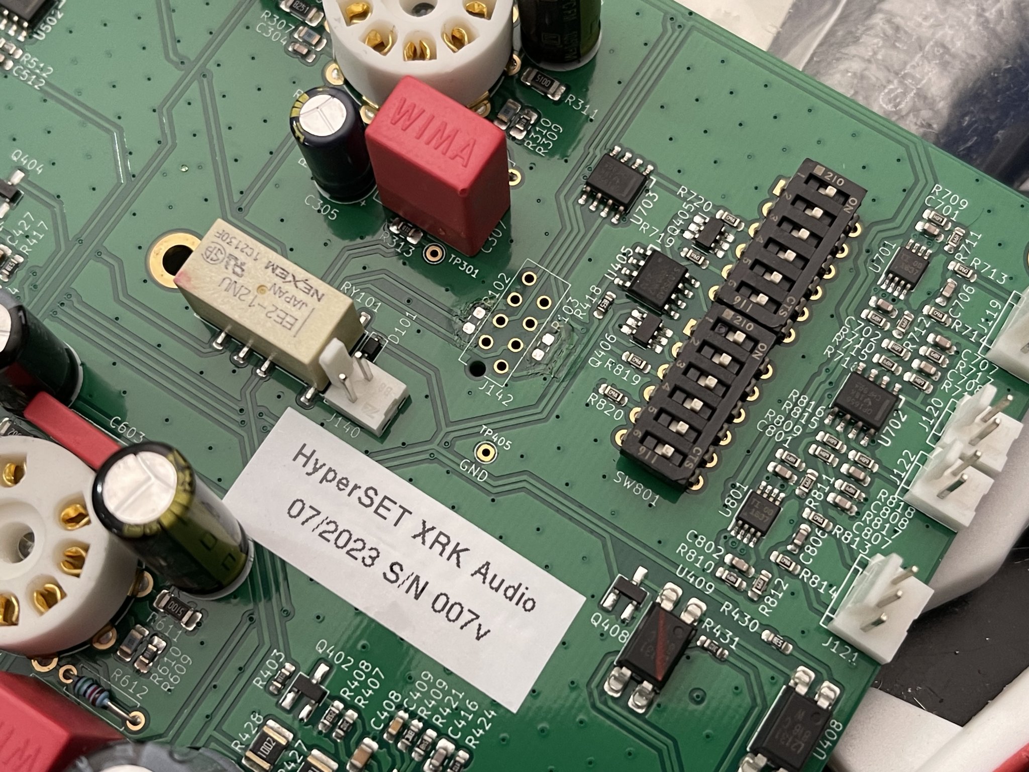

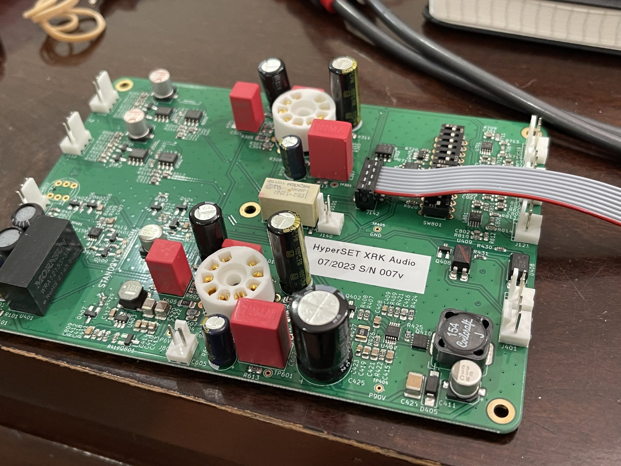

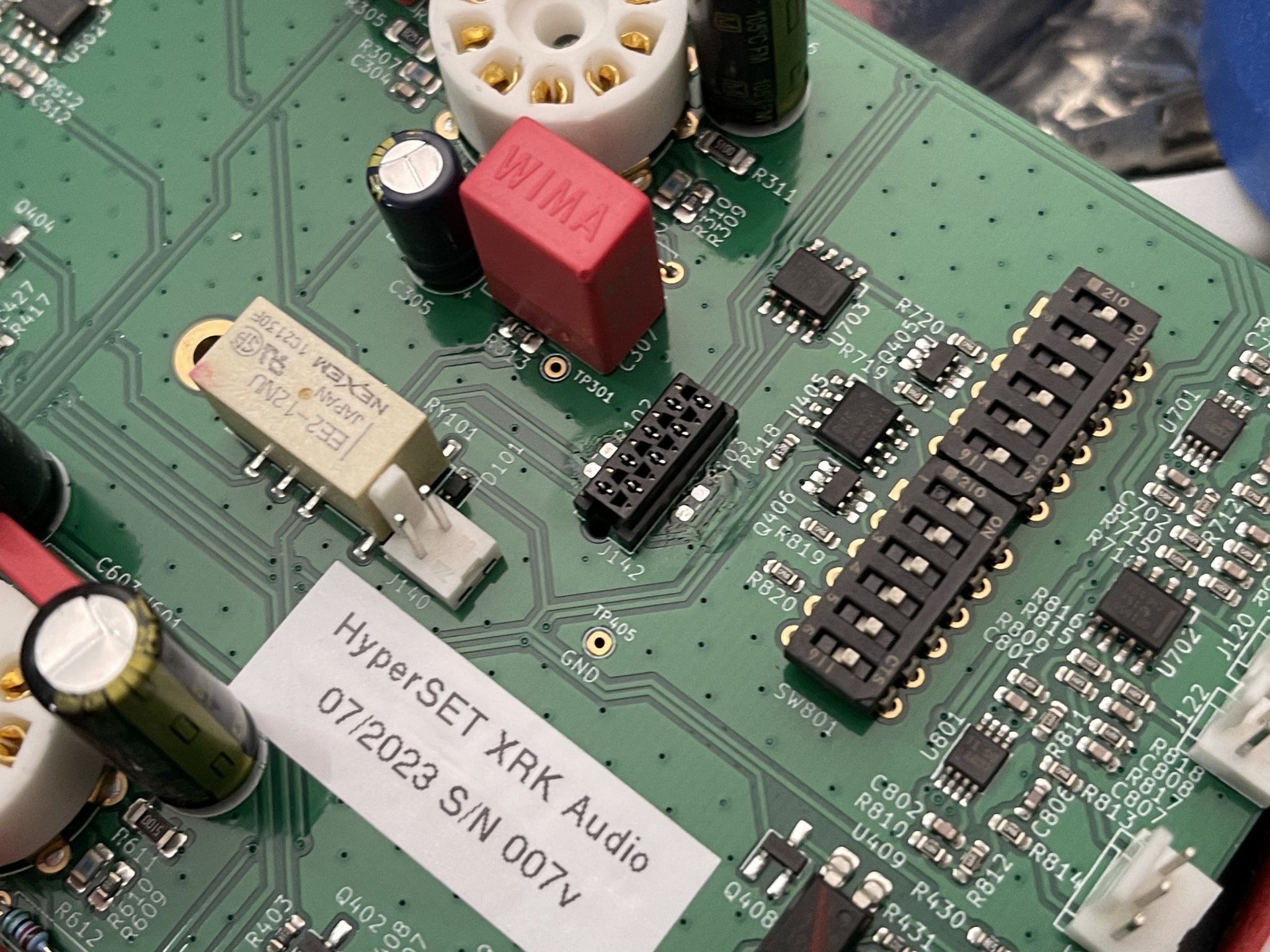

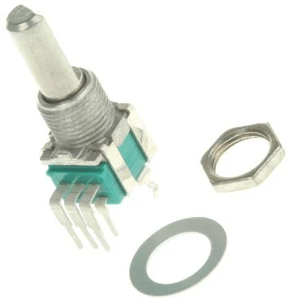

I have also modified a board to have an external volume pot. This requires removing R101/103 using a soldering iron and hot solder blob. Then install an 8pin MicroMatch connector jack (female). You will need a male to male 8 pin MicroMatch cable assembly. The included volume pot helper board accepts most 6pin Alps/Bourns RK09 volume pots. Recommended value is 10k and part RK09L12D0A1T.
Here the 0R resistors near J142 have bee removed:
The 8pin Micromatch connector jack installed:
The volume control works smoothly and scratch free. Very nice and simple. I did find one minor issue. It appear the helper PCB has the rotation sense mixed up. To fix this install the pot on the opposite side of the indicated silk screen to flip the rotation. This will make the usual CCW low volume and CW high volume.
8pin IDC ribbon cable with connectors installed:

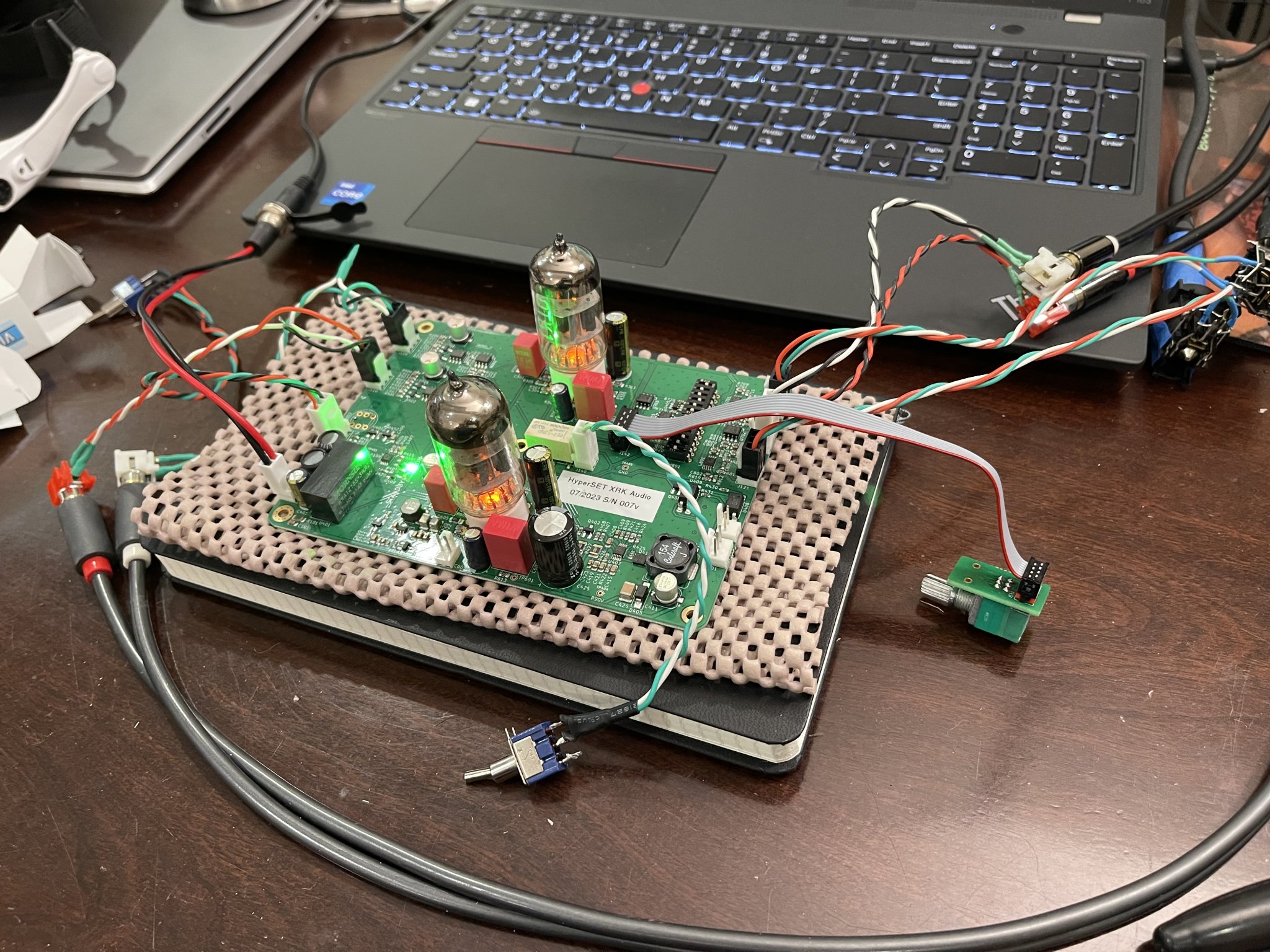

I did not have exact pot so used one I had on hand so fit is not correct:
Volume knob feature works well and allows this board to be used as a preamp to a power amp. Note that SE and Balanced outputs are simultaneous independent buffered outputs and can be used at the same time. The SE output is an OPA1656 capable of high fidelity low distortion and high current output. As shown in the BTSB, the balanced output when driven by a balanced input can be as high as 53Vpp.

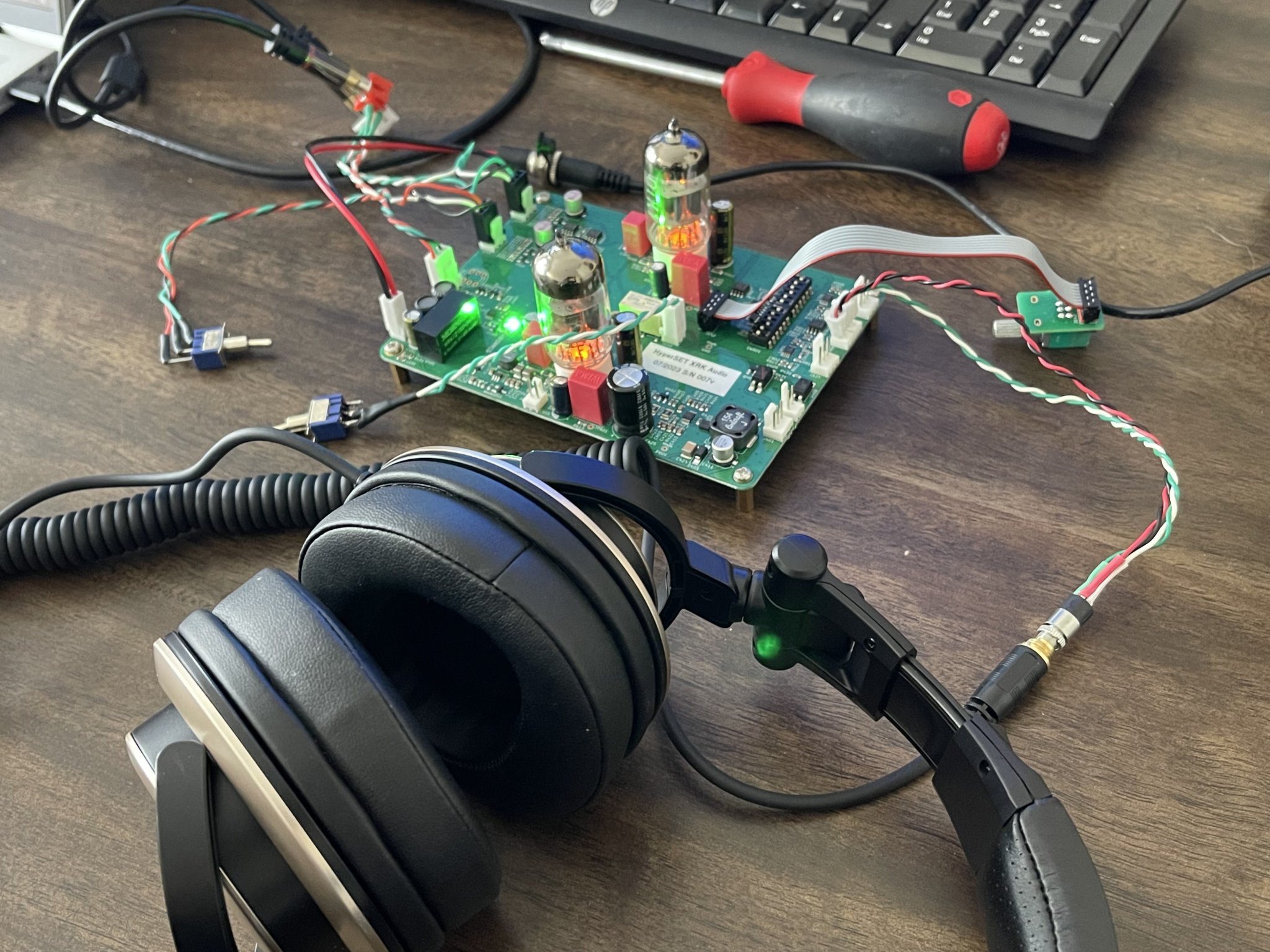

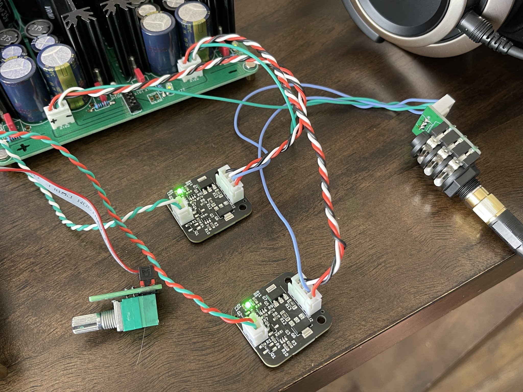

I suspected that an OPA1656 can drive headphones so I had to try. I connected my Status Audio CB-1 33ohm cans. It sounds quite good - decent bass and very clear. No discernible background noise or hiss / hum. Silence when music not playing as expected. If one adds a high current buffer to this, a very nice HPA can be made. TPA6120A2 is good.
Being able to drive 33ohms means it can drive almost any impedance amp input.
