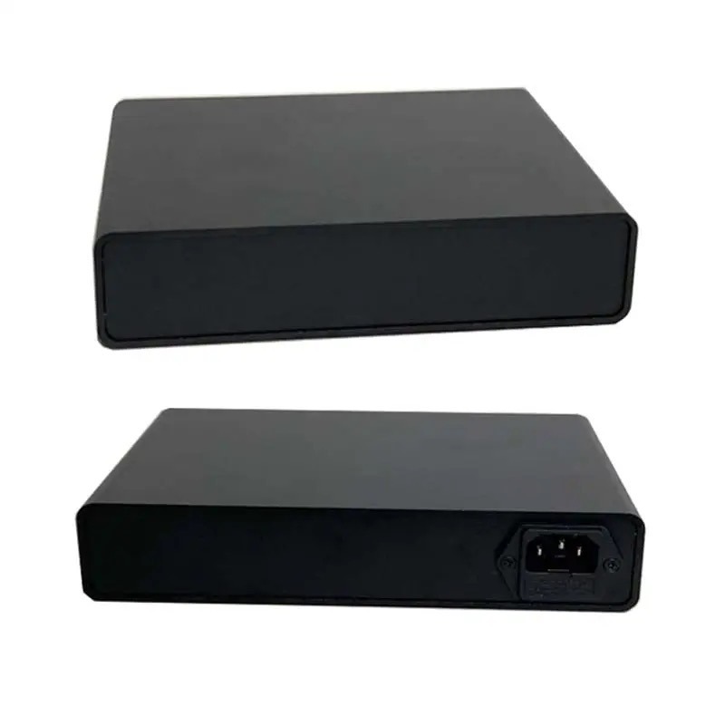

That’s a bit small X, not enough room to fit an input selection board and front panel selector switch and volume pot.
Speaking of volume pot, it would be nice if the accessory pcb would accommodate and ALPS RK27 pot instead of the RK09.

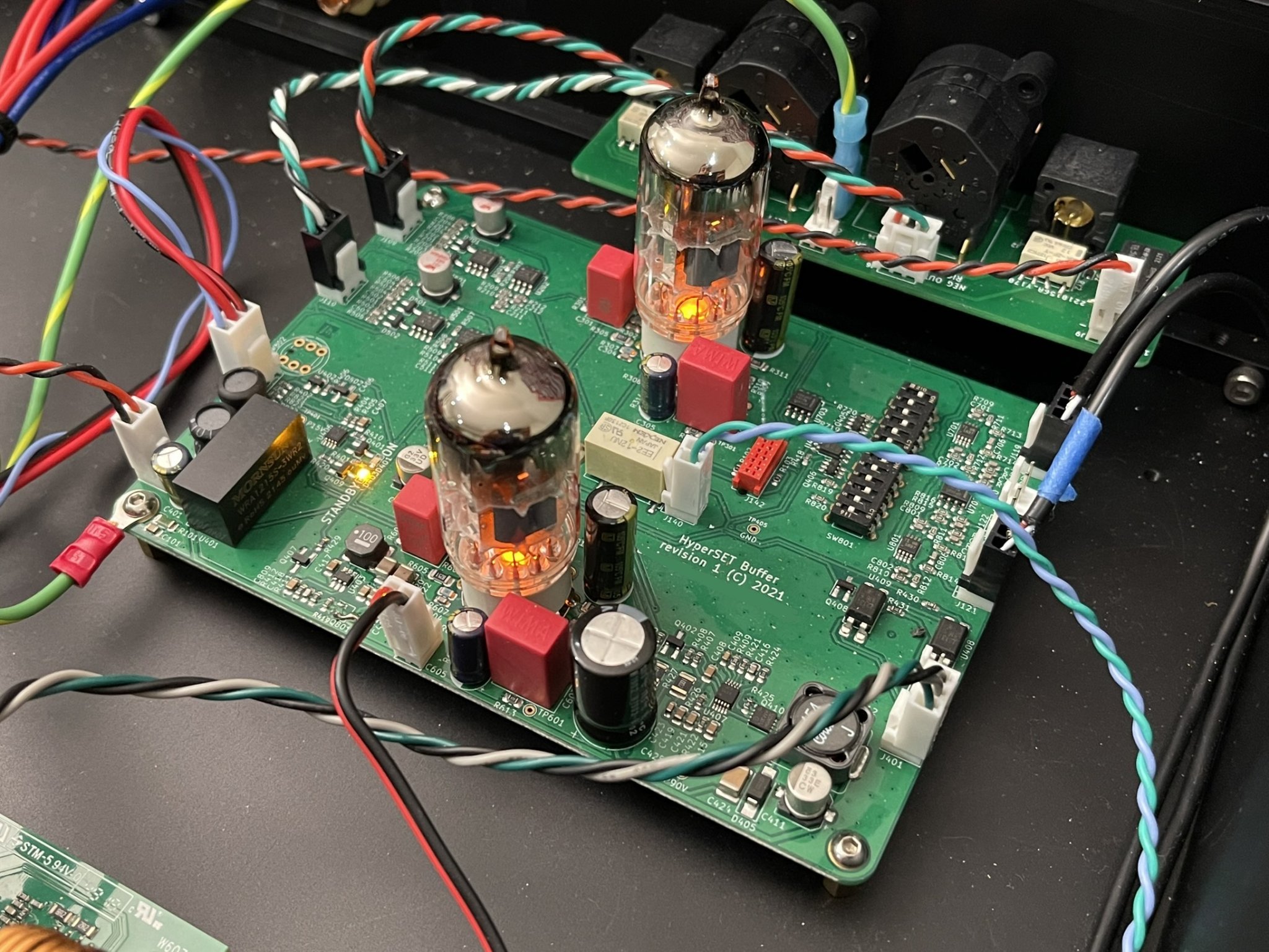

- Designed for E88CC/6DJ8 or Russian NOS 6N1P. Comes with matched pair of NOS 6N1P (best sounding IMO).
- Selectable gains via DIP switch: 0/6/14/20dB other values also possible with user mods of resistor loads.

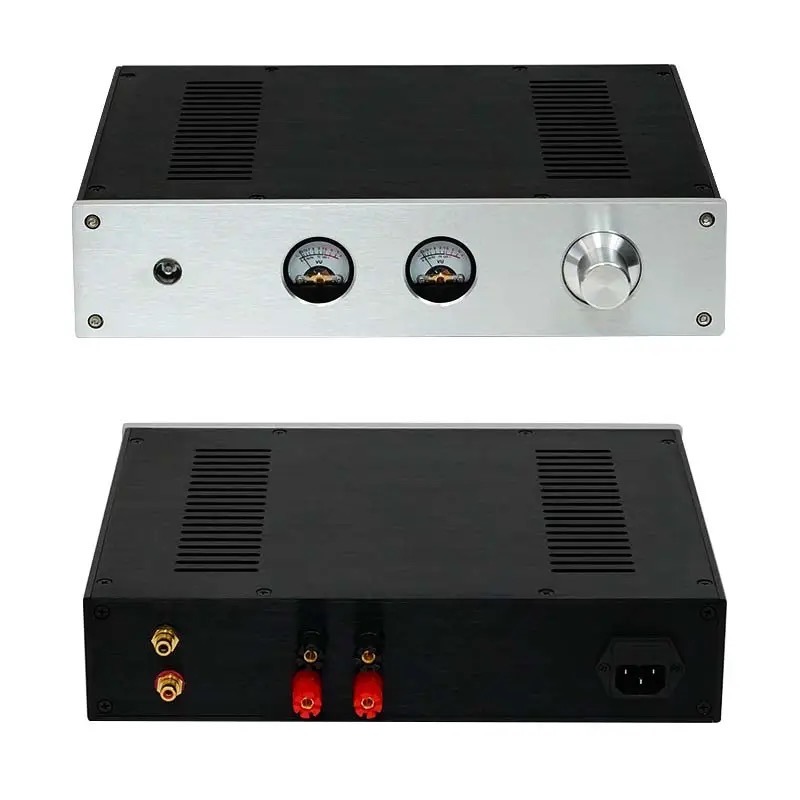

Maybe this one? It has holes for banana but could change that to RCA’s? The selector knob can go where the LED hole is on the left.That’s a bit small X, not enough room to fit an input selection board and front panel selector switch and volume pot.

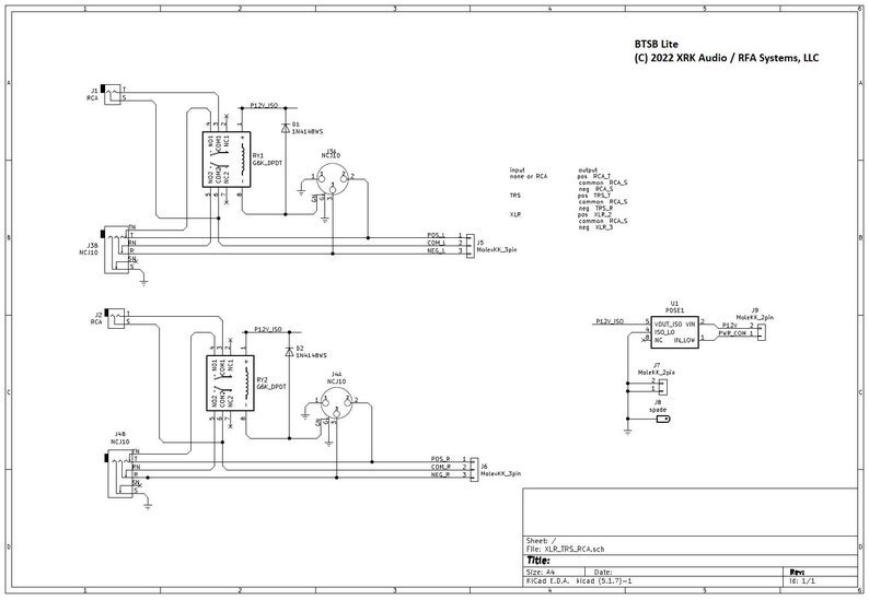

Hi X, is my assumption correct that the (light) input board is only responsible for switching between SE and XLR or is it an SE/XLR converter too? Does the tube board always get balanced signal or does it depend on what input type I use? I would install 4 inputs, two RCA and 2 XLR, and switch between the inputs via relais. Can I feed the tube board with an SE signal too, with grounding of the "cold" side? Thanks in advance.
The “BTSB Lite” only switches between SE and balanced (XLR/TRS) and the BTSB does the conversion.
The switching is sensed by presence of a plug in the XLR or TRS jack and is “balanced priority”. That is, if there is an RCA connected, it will disconnect the RCA and go only to the balanced input. If you want to use the SE RCA, you must disconnect the plug from the XLR/TRS jack.
It is auto switching so no manual toggle or button. Only way to get RCA is to remove balanced connector.
