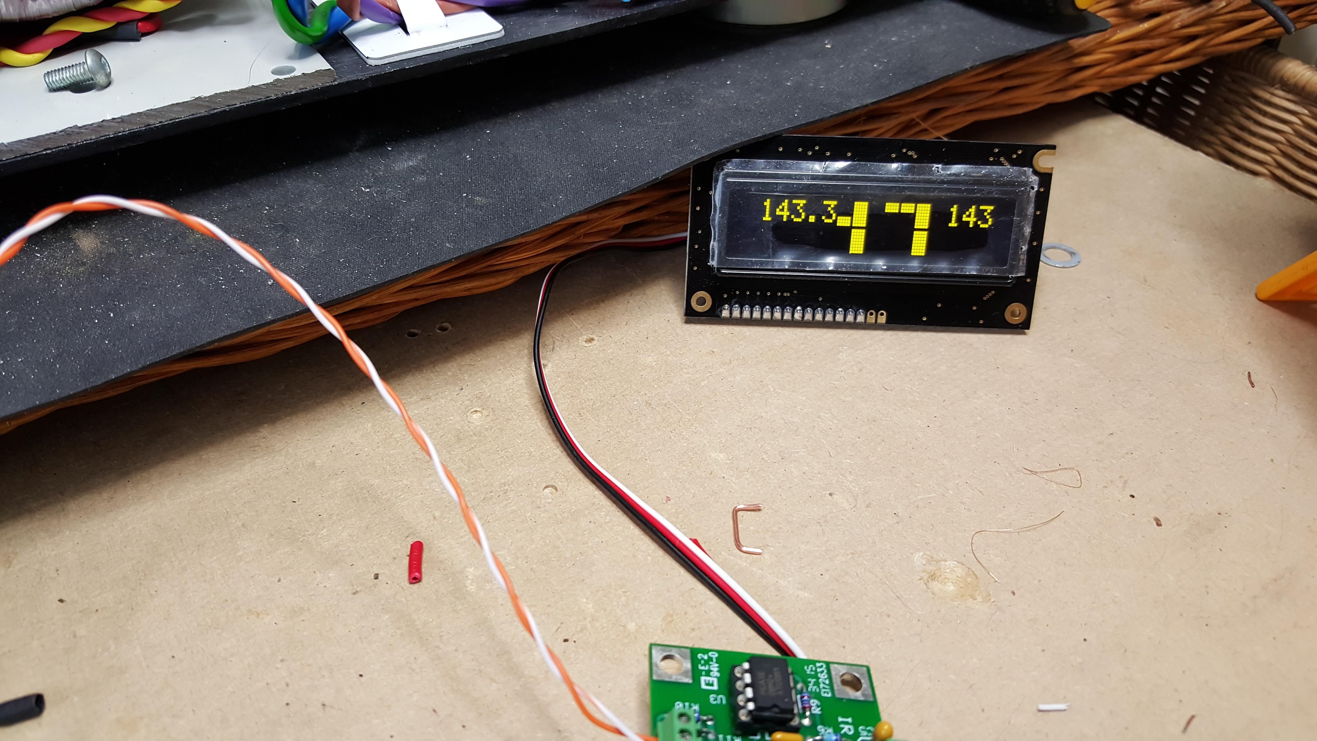

Ok ive hooked it up before i install and I have a couple of questions, as you can see from the pic the milliamp setting on the left has a decimal, the .3 is obscuring part of the volume display, is this normal? Also I cant seem to get rid of the milliamp display or switch to Balance, is this because I have no input on the board? ive tried changing the length of time to pause the push of the encoder but I can only get it to mute. (quick push) Ive also just realised that the milliamp reading is way to high!
Definitely something not right because i thought I would try calibration, the plug has no effect.... 🙁

I wish I had better news for you. In your picture it appears you've connected the 12V power supply to the 5VDC output terminals.
The +12V input terminals which deliver power to the input side of the on-board regulator are at the far end of the terminal strip and are marked 9~16VDC In. Look at the wiring schematic under the technical tab at BTFSystems LLC - BTFSystems LDR passive preamp, and you will see the error.
The 143.3 is what you get when the rotary encoder board is working properly but the LDR controller board is not providing it with any useful information to display.
You need to move the 12 volt supply wires off of the +/- 5V output screw terminals and connect them to the +9~16V input screw terminals on the LDR control board.
That will not solve your problem because you have been delivering 12VDC to a 5.5VDC MAX chip so it probably did not survive. Even if it appears to work, it is no longer reliable, so I will send you a new chip on Monday.

Yeah ive killed it, most expensive set of pcb's ive ever purchased and i hooked it up wrong, cabbage...... Oh well at least i will now get the chance to listen to my amp with a standard pot before i use an LDR, silver lining but apologies to Karl.
Thinking it through, it's possible the LDRs and the status LED are damaged because current-limiting for those devices is calculated based on a 5 VDC source. I can't be sure because current through those devices depend entirely on the output state of the chip when it failed. so if it failed with those circuits turned off, then no harm done. If the circuits were turned on, then probably there's damage.
If you can test the LDRs and status LED out of circuit, that would be useful. You should deliver about 10 milliamps at 2 volts. The status LED should light up, and the LDR resistance should drop down to 35~80 ohms.
Also, some of the tantalum capacitors have voltage ratings below 12 volts but probably are OK. The mosfets certainly are OK. The voltage regulator should be OK; if it's working, then it's OK.
IF the rotary encoder board is working OK then the data exchange wires did not deliver high voltage to the encoder board.
