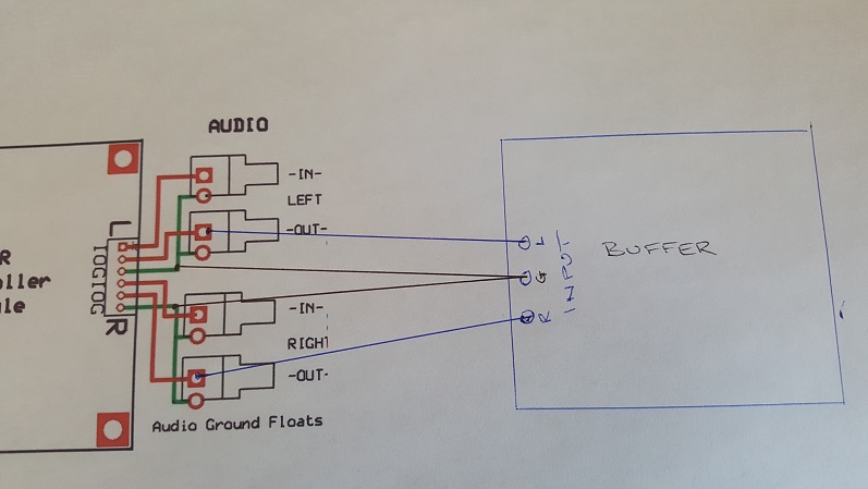

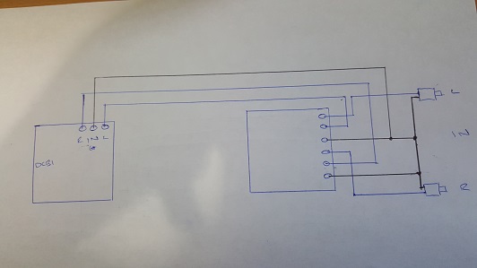

Dawg, the grounding as drawn in your diagram is wrong. Go back to the schematic as published on my website, and follow it exactly. All will then be well.
Any chance you could elaborate a little please? if all my pics are wrong i dont see how i can implement the LDR with the DCB1 only having one common ground, i have indeed gone back to the published schematic many many times and my third pic is as far as i can tell as close as i can get with the buffer only having one ground point.
Here is the published schematic which is as far as i can see exactly how I have drawn it in my third pic, and this is wrong? Could you please tell me what is the correct way to wire it because i can look at this all day but its not going to help. 😱

If the 'setup' on photo 1 on post #100 works okay with your system, when you replace the pot (with it's common ground connections) with the ldr volume control, all you have to do is connect the single ground wire from the phono plugs to both of the 2 GND points on the input/output terminal board (connect the Rt GND & Lt GND with single wire) and then continue just the single ground wire to the input GND point of the dcB1
This way, you've unsoldered the volume pot and connected the ldr pcb with the very same wires - no parallel connections, no links, or anything - and if it worked with the pot, there's no reason at all that it won't work with the ldrs
As you can see from the diagram, the LDR volume unit has 2 completely separate signal and ground wire connections - it's as if you had just cut the LDR volume control into your separate Right and Left interconnects - note the separate ground connection bit
What you've done is to common up these separate ground/shield wires at the input of the dcB1, and this is where some of the problems come from ...
If your dcB1 common ground point is connected to the mains earth pin via the Salas shunt reg board, this is your signal ground point for the whole system and all other earth connections have to be 'lifted' to avoid earth loops - in preamps, tuners, dacs etc, this is usually done by separating the chassis earth and the central ground point of each device,
Apologies if this is a stupid question but how do i connect the 2 ground points on the LDR board with a single wire and not have any links? do you mean a single wire to each point as in pic No 4? (attached)
After metering the build it appears the 3178s CHG connection is part of the return path so I have an earth connection on the 2 amps but nowhere else, I have not yet wired the buffers shunt connection to the chassis but when i do it will float via diodes as per recomendation. It does work just fine as is but the LDR needs a floating audio ground so do you think I should remove the chassis connection on peters amps? Or should I be doing the diode thing on the 3175s too so the signal is totally earth free? I should of included that on my original schematic.

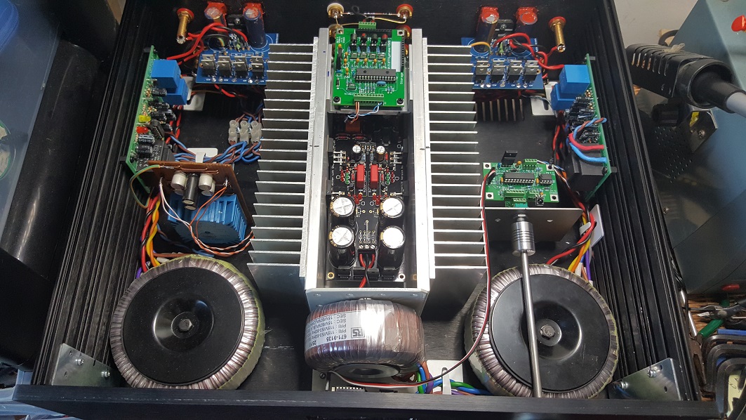

Thanks again for the help James, i didnt realise I can only have one earth connection in the entire system, I bet my av amp has an earth on it, seems to work ok when use the new build as my front channels though. I think I need to order some diodes.

James is the expert in this area, I defer to him, but the ground system as drawn in photo one makes me wonder if there is a common point where all of the signal grounds are connected to each other just once?
Are you familiar with the "star" ground system? If you have more than one ground connection between components this may be causing a problem. For example, the LDR ground is connected to the buffer and the amplifier ground, but you also have the amplifier ground separately connected to the buffer and that creates a ground loop.
Also, if you previously reversed inputs and output somewhere that's not a ground issue, did make sure you didn't do it again? "Massive" buzzing could be a feedback loop rather than a ground loop.
Yeah, sorry about that extra link bit - just connect the 2 GND points on the ldr's input/output terminals with an extra short bit of wire between the terminals - no long wire from the phono plugs or anything - and use the one ground wire as per the previous pot method - keep it as similar to the way you had the pot connected as you know that way worked okay -

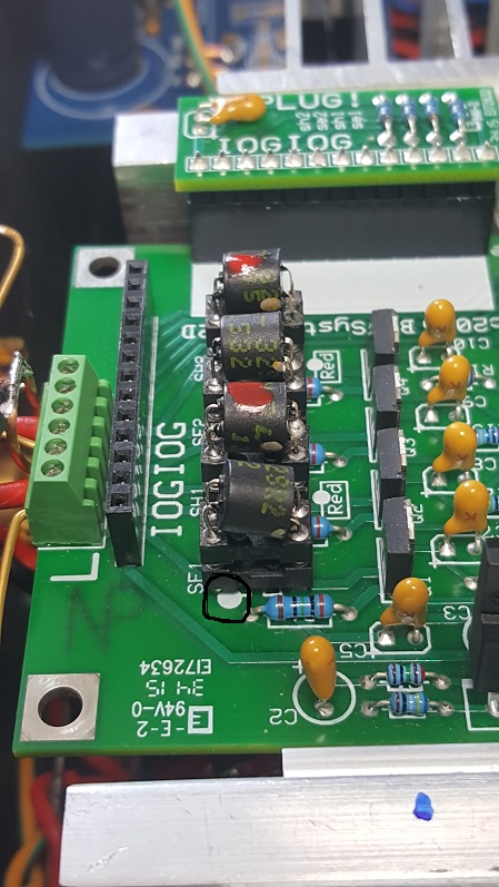

Cheers Karl, I definitely connected it up the right way round as i made some new links for the inputs, As james says i may re visit the chassis connection but i do only have one ground connection which i left off the pic, ive attached the full schematic, there is always the possibility of the input output board been damaged by my previous mistake, i will go a little slower this time....

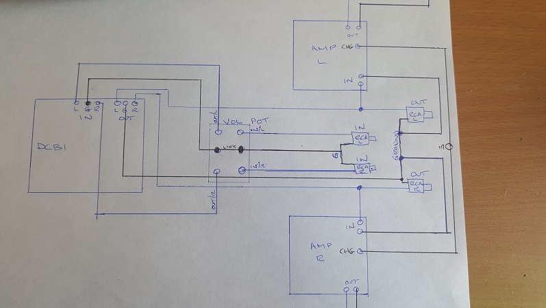

On your photo above, what's the line between the 'L' and 'R' amps connected to the CHG labels? Are they CHassis Ground connections?
The diagram of the volume pot is quite misleading - I presume this is just the way it's connected?
Sorry Karl, cross posted, but we both seem focusing on possible earth loops, my favourite nightmares!!

Yes thats the chassis ground connection, I made a mistake with the pot, i had been drinking all day when i started drawing, never a good time to solder but essentially yes the ground connection on the pot should be at one end not in the middle but i guess i could of said its just that brand of pot but i like to show what an idiot i am, lol.

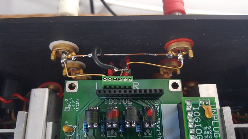

Thanks Karl, never thought of swapping the devices over, i started another calibration already so i will do that next, the white dots i refer to are at the back of the board on the pcb, theres one at each device, only the shunts have a white dot on the front of the pcb facing the regs, i guess those white dots on the pcb are not there to orient the ldrs, i left them as they where received.
Oh and i bought the full kit remember, only the rotary encoder here.

Yeah buffer, LDR, amp all in one chassis, short signal paths always for my builds. The main reason for paralleling the buffer output was so i could run my plate amps from the buffer instead of the chip amps, I couldnt get a definitive answer on the best way to run separate amps on the audiosector build thread but the designer of the buffer said there would be no issues doing it via the DCB1. I decided to wire the chip amps power via a switch so they could be turned off effectively turning the build into a passive buffered pre but my intention was always to run both sets of outputs for my bass drivers. As it happens i havnt tried my plate amps on the rca's yet because the chip amps seem to run them just fine, ive had issues with other amps doing it this way hens the backup plan. right calibration complete....
Ok ive swapped the LDRs and it didnt change so its something else, is there anything i can measure with a dmm on the ldr board?
oh i havnt swapped the shunts, thought they had to stay, just re read what you said and see they just need to stay in red dots pos.
