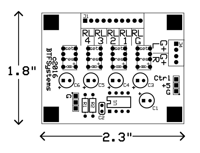

It's been a long wait, but we're finally settled in our new digs and I've completed the hardware and software designs for an input selector board that complements the other boards in the system. Function is verified and a small run of boards are on order.
It's diminutive and will fit in very small enclosures -- see the drawing -- and signal traces are very direct from four inputs to a single output. Left ground and right ground are kept separate throughout, and all signal and signal ground tracess are isolated from power and control ground.
The relays are the telecom hermetically sealed "latching" type -- contacts will never be contaminated and they draw only 19ma for a mere 50 milliseconds when an input is switched, and otherwise draw no current at all which means no magnetic field during operation.
The selected Input will be displayed on the OLED -- a large digit momentarily when a new input is selected, and then smaller text to the side of the large volume display during operation. It is now possible to build a complete passive LDR preamp with BTFSystems components.

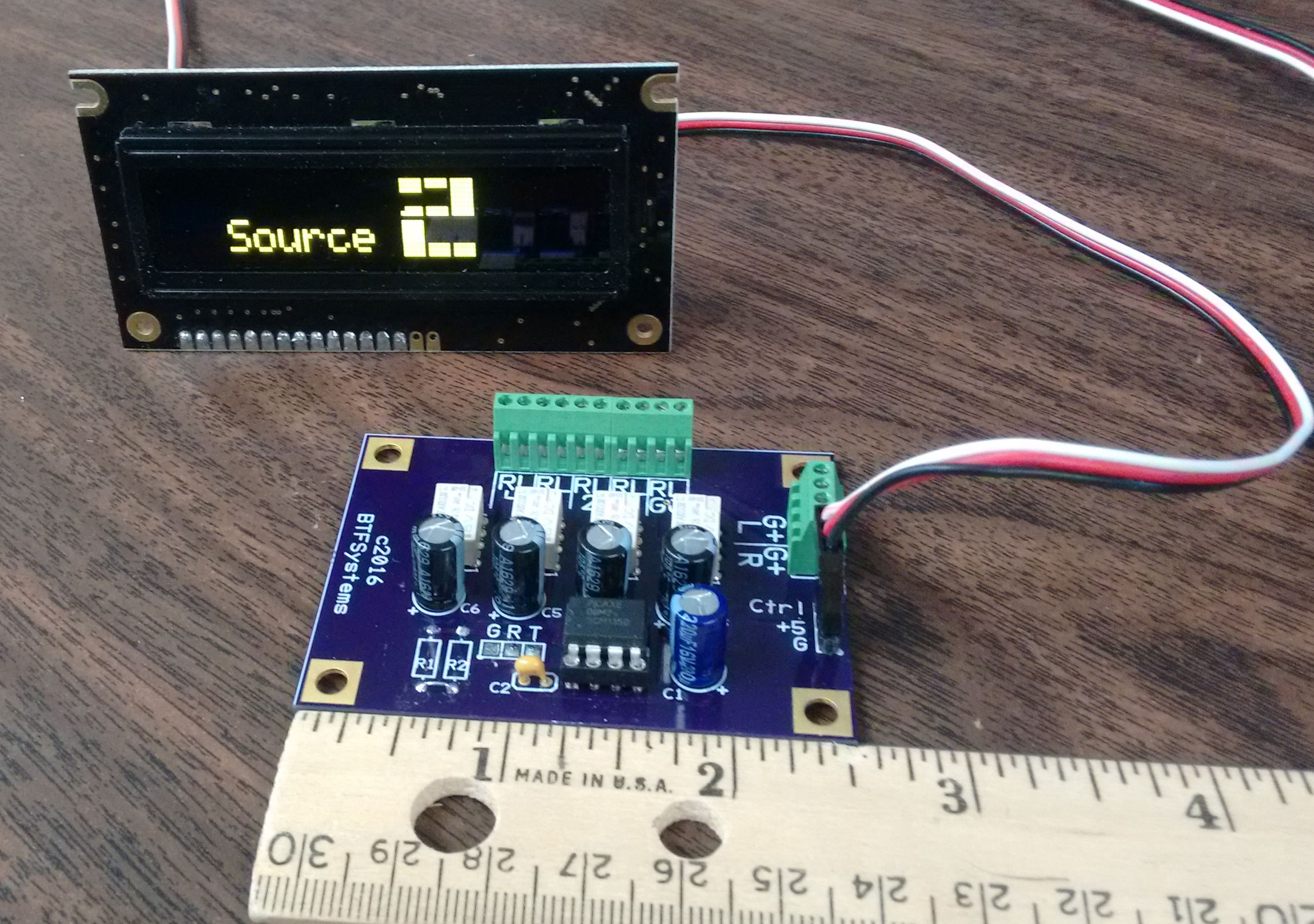

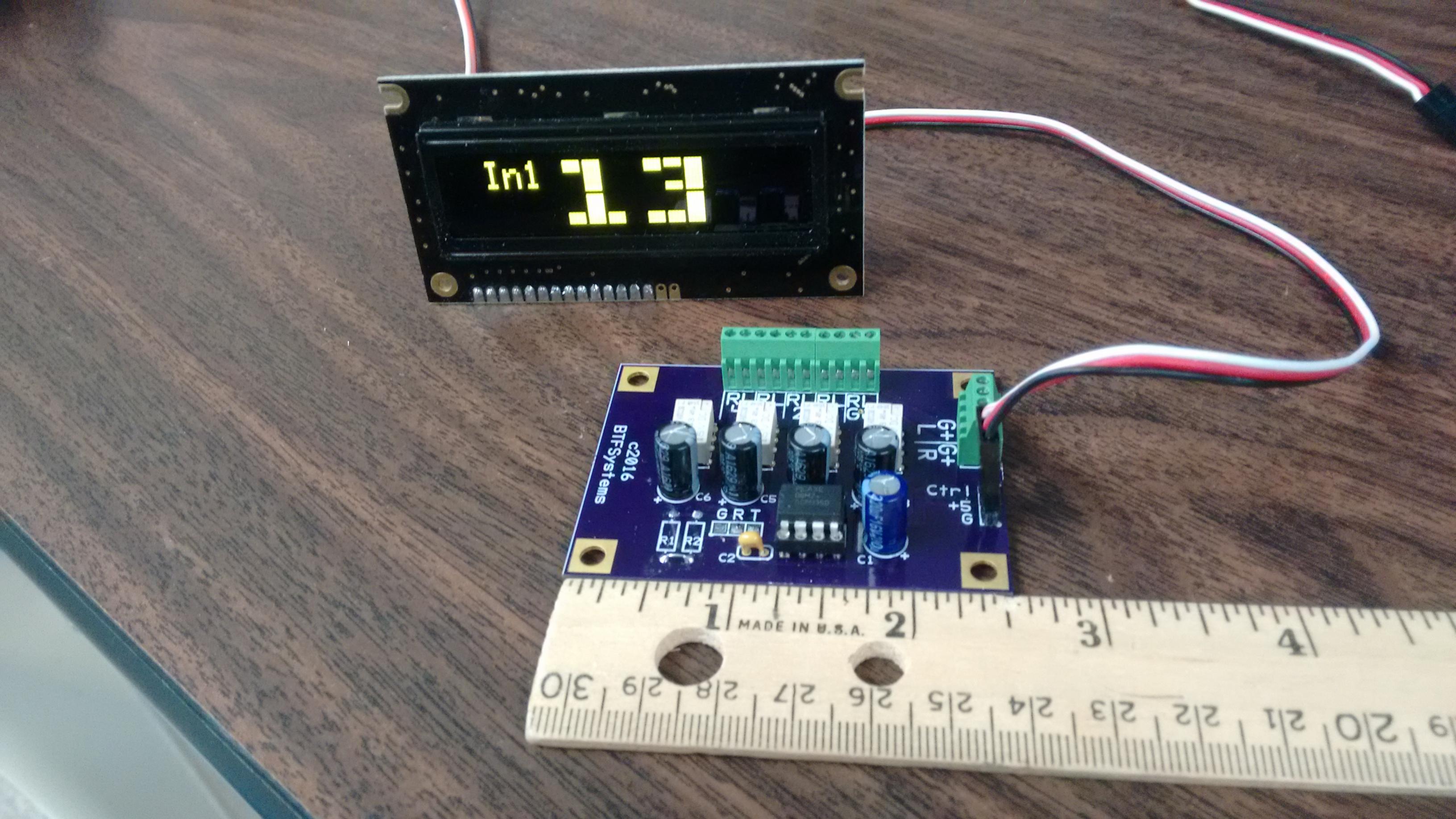

I have finished testing the function of my prototype Input Selector, and it works as expected.
It is a 4-way selector that uses latching, hermetically-sealed telecom-quality relays to control the input.
The latching is significant for a number of reasons:
First, the coil is energized only when actual switching is taking place, and only for about 50 milliseconds. After that the current through the coil drops almost to zero and the magnetic field dissipates. This means that there is no magnetic field in the vicinity of the audio signal.
Second, this board draws very little power. The 8-pin DIP chip is the only full-time consumer of current; when a relay switches there is a momentary draw of about 19 milliamps, again for that 50 milliseconds only.
The circuit, like all of the BTFSystems boards, is designed with simplicity as a main goal that is second only to quality and reliability of operation. The circuitry consists of one IC, six capacitors, and four relays, that's all. Protective diodes are not required for this circuit because the magnetic field does not "collapse" as it would with a conventional relay -- it gracefully reduces over a period of time with no voltage spike of any kind.
The board, at 2.5 x 1.9 inches is slightly larger than the final board which will be 2.3 x 1.8 inches. This is a small board that will fit almost anywhere.
Control and power is taken from the display, and is delivered via a simple 3-wire premade cable which is available in various lengths from any hobby store selling remote-control servos and vehicles.
Control is via the Sony TV-compatible remote control -- pressing digit buttons 1~4 results in the input switching to that input number.
Input is via a 10-terminal .1" terminal strip -- one terminal per signal line plus one terminal each for left channel ground and right channel ground. Channel grounds are kept separate from each other throughout, and also separate from the system ground plane.
Output is via a 4-terminal .1" terminal strip -- one terminal each for left and right signal and left and right ground.
The attached photos show the board and display; one picture shows the display as a selection is made, with a large digit showing the selection, the other picture shows the normal display with volume in large digits and the Input number display in smaller digits to the side. When the display has LDR milliamps turned on, the input number moves to the lower line. It is always visible except when both milliamps and Balance offset values take up both the top and bottom lines.
