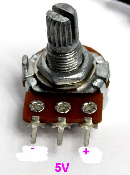

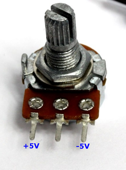

Turn the knob full clockwise, and whichever outside pin is shorted to the wiper is the CW pin.
OK, the image I posted in post #22 is WRONG.
Here's the CORRECT way to connect the end terminals of both the volume and balance pots for anyone who's not exactly sure.
Thank you for clearing that up wapo.

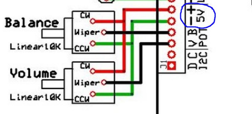

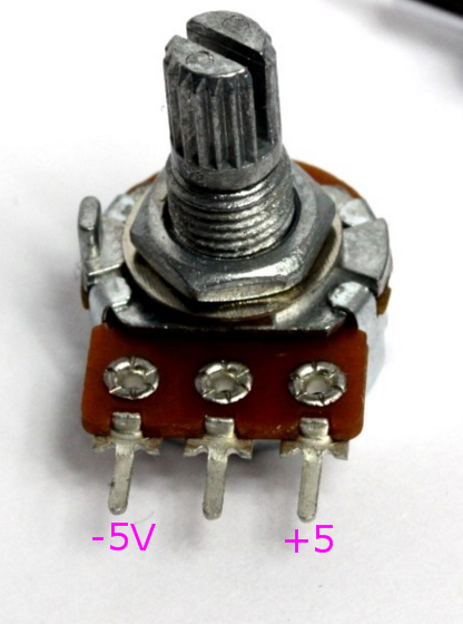

Your image is still in error -- there is no minus 5 volts involved, only zero volts to plus five volts.
I must be seeing things.
It clearly states +-5V on your board.
What am I missing here?
My drawing shows it as a 5 volt circuit, and the plus and minus signs only denote which terminal is the high side and which is the low side. Your drawing show it as plus five and minus five which is a ten volt differential which it definitely is not.
