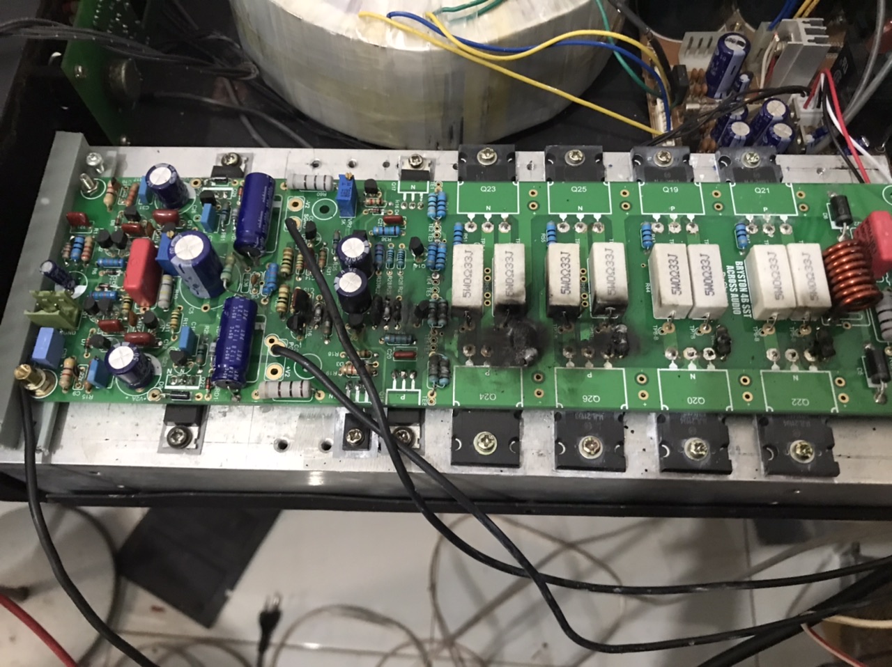

Unfortunately what happened :scared:mad:

I think amplitude is probably right as to the likely cause of your burnout. I used 51R with no problem in my amps. I'd replace all four 49.9R resistors with 51R types - the absolute value isn't too critical but its important that all four values match as closely as possible ( or reasonable! ).

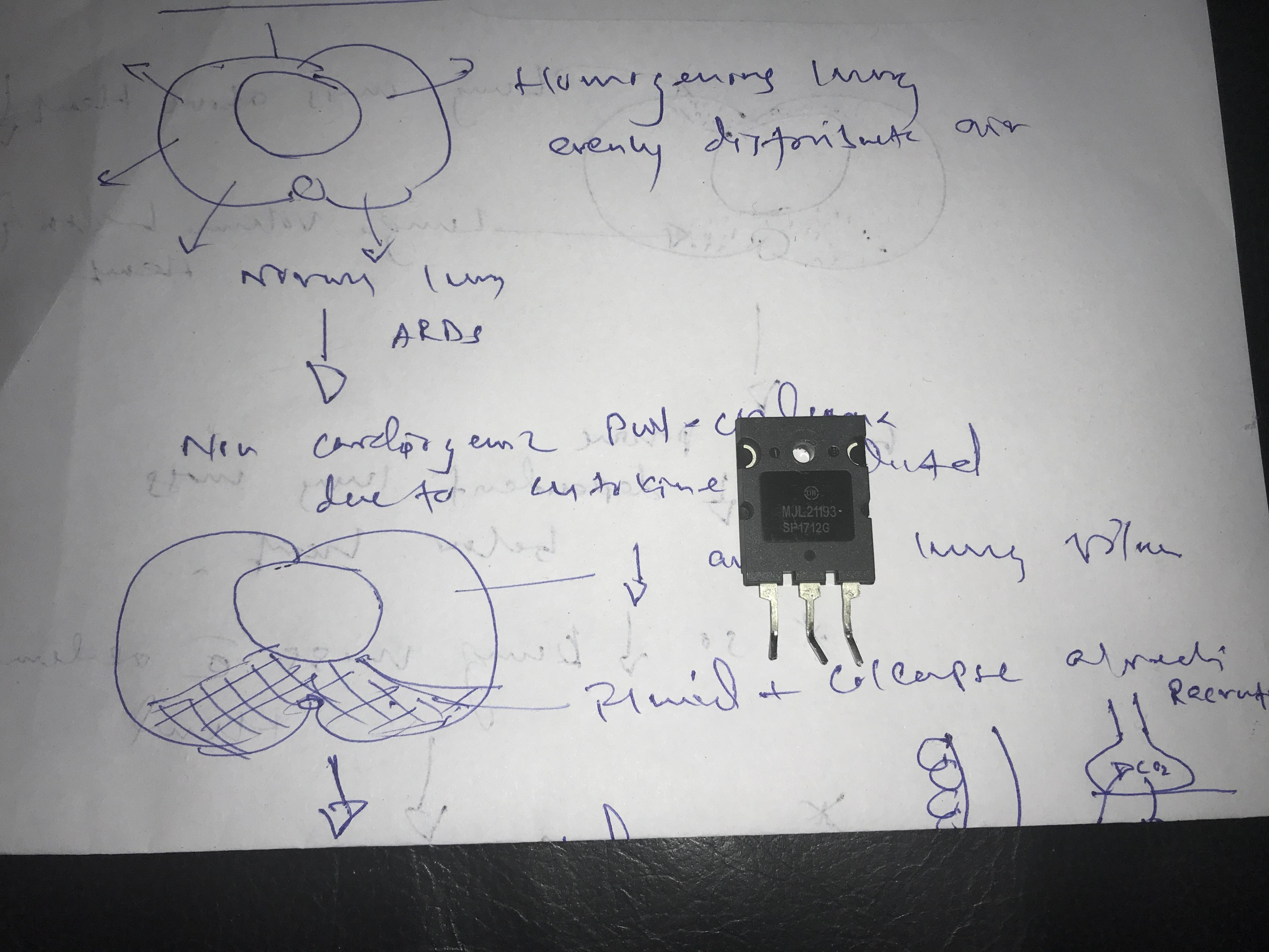

Looks like mine too. Marking says made in Singapore in 2017 work week 12. Who did you buy them from?
Hi...thanks for your reply I’m a Sri Lankan..which is a small beautiful island like a paradise situated in Indian Ocean .I bought them form Colombo ...the capital city of the island.And I’m a medical doctor with little knowledge in electronics but suffering with fever.Oh ...that is myself....really ? it’s look like original ? but I saw some discussion in forum that original one is rectangular and no projections at base of pins ?.
