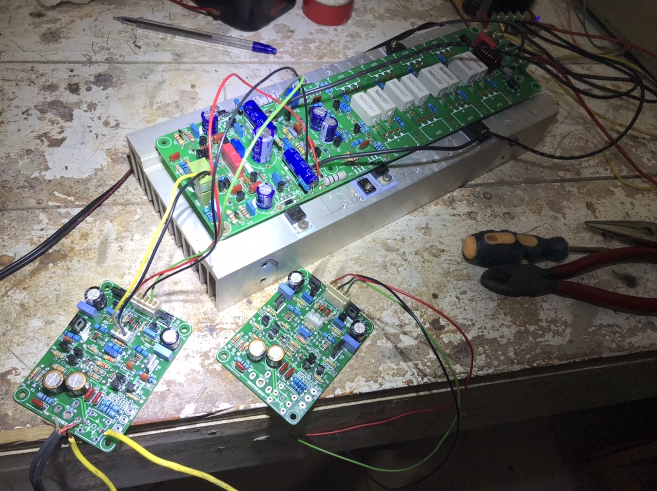

Did you change many parts? And have you tried a power up.
Mistakes happen, I mixed up a P and N channel mosfet today, luckily I had fail safe resistors on.
Thanks Amplidude.....yah..changed many components and checked voltages across R38-41, connected to speaker and checked sound quality before mount power transistors then mounted a pair of power transistor and adjust bias voltage.Same thing happened to me and powered for seconds but likely nothing happened .

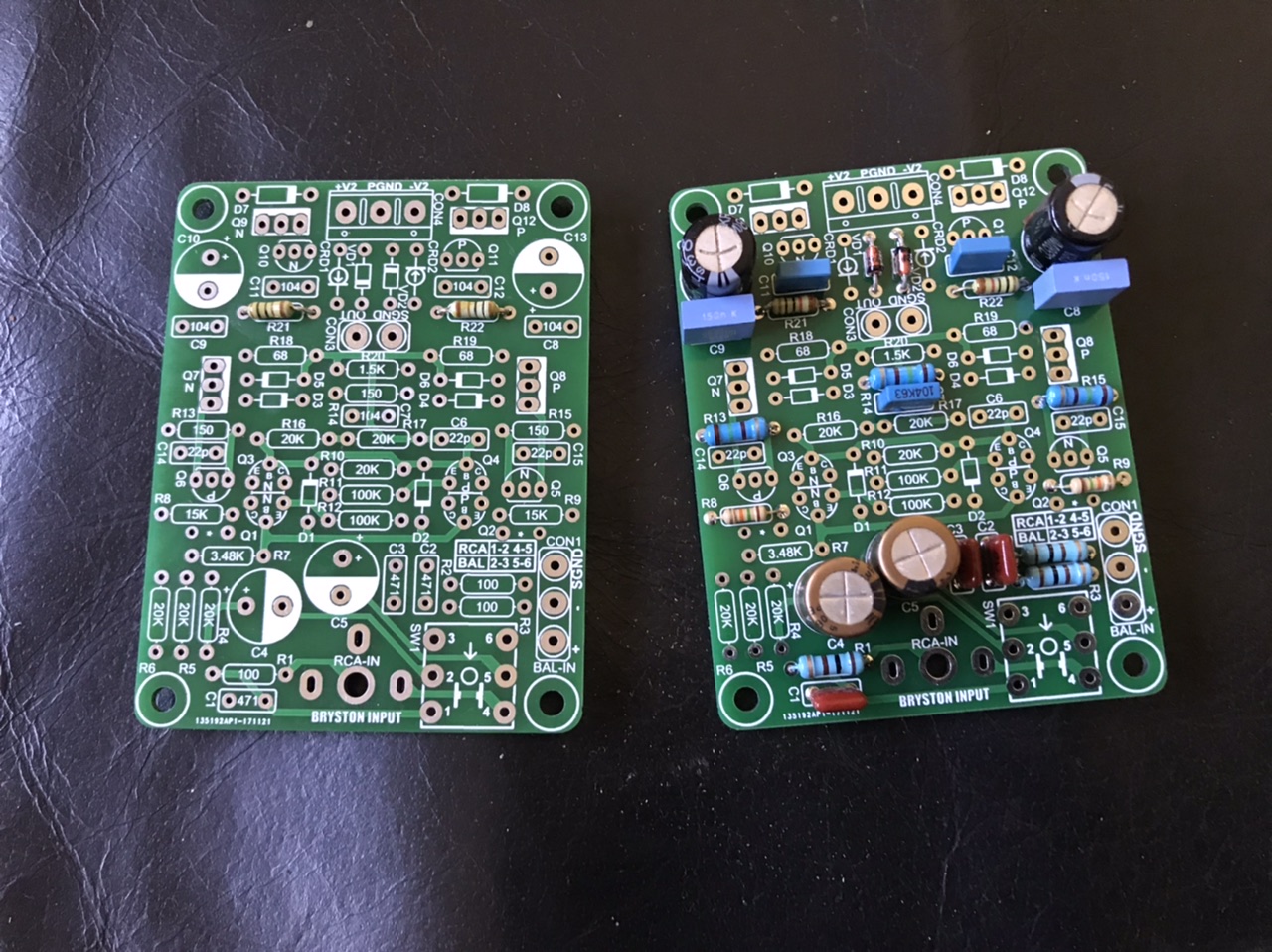

Just started assembling input boards🙂🙂🙂

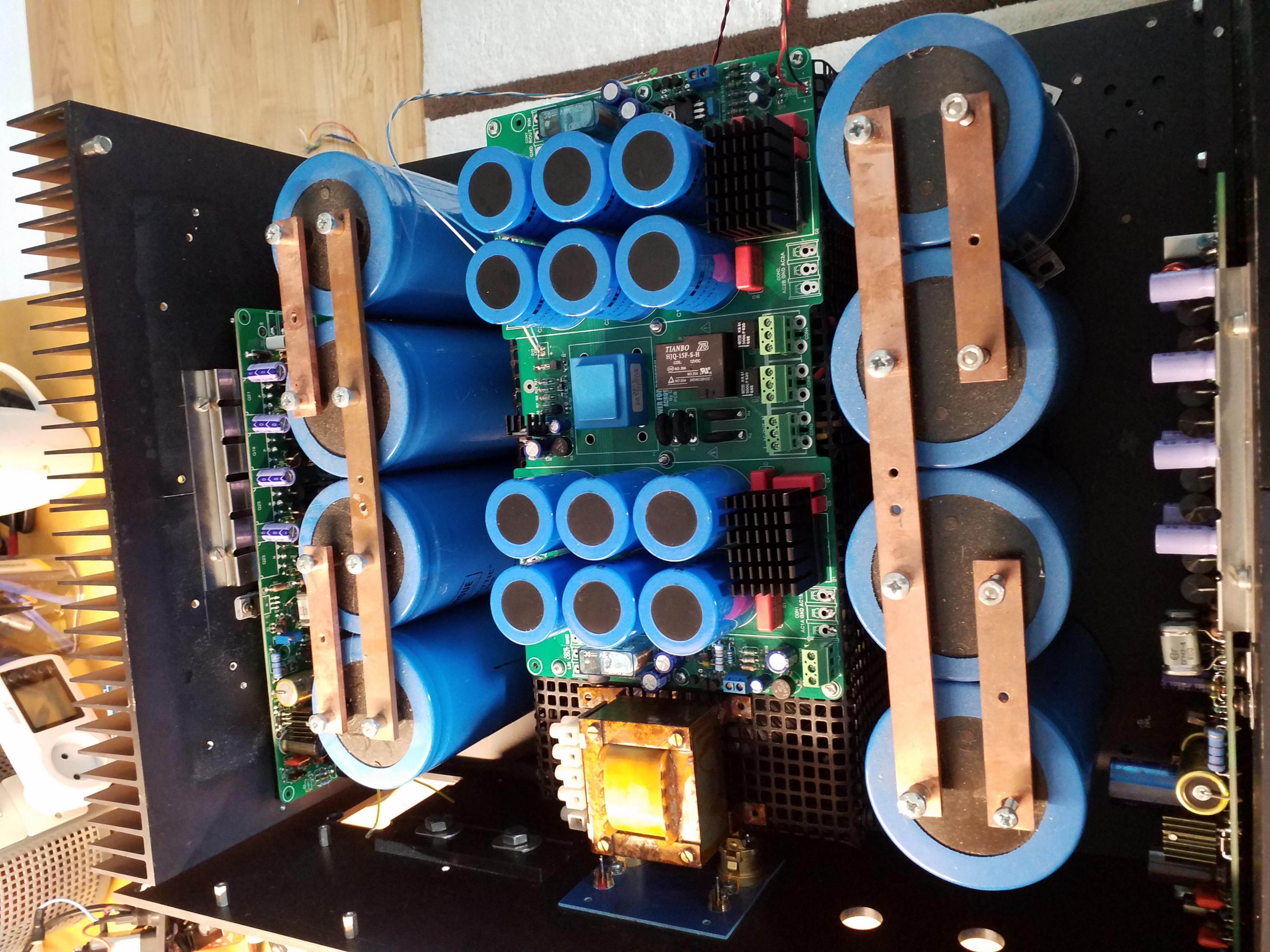

:wave2: build it you won't regret.
My build was quite cheap because I had most of the expensive parts already, I had the 2 toroidal, charging caps, and output transistors.
Think total spend is 700- 800 is dollar.

Power supply?
