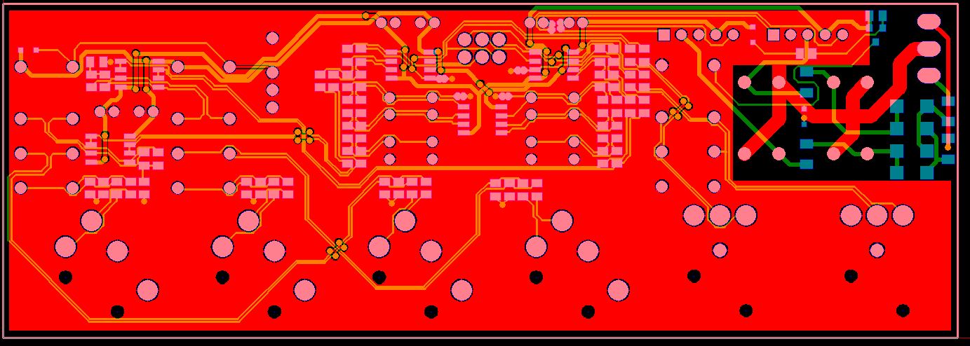

Tfboy you are right, there is only 2 layers ;) I can certainly do this PCB myself.
