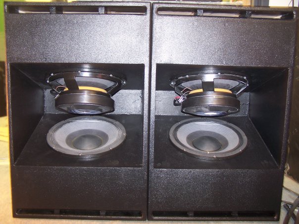

Hmm, what about this.

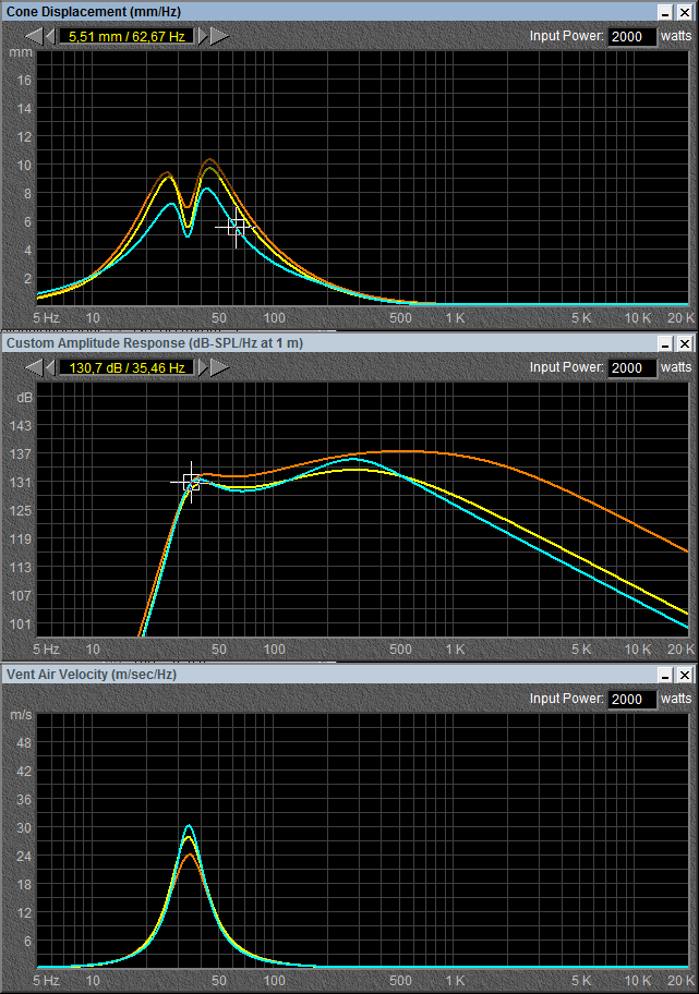

I compared 4 x 12" with 2x 18". You would expect the 18" to just walk all over the 12", would you?
Well, I compared B&C 12TBX100 with B&C 18SW115. The 18" is an animal, so must be the winner then. Some facts;
2 x 12" Sd = 1 x 18" Sd (90- 95 %)
2 x 12" Pe = 2000 Watt, 1 x 18" Pe = 1700 watt
Now 80 liters is even smaller to your "tiny" 15", so I put 2 x 12" in push Pull config in an 80 Liter bass reflex and compared it to 1 x 18 " in bass reflex. Based on the facts, it would result in kind of the same. So, here's what I did, I ran a quick config in BB 6 Pro, I used:
2 cabinets of the 2 x 12" push pull bass reflex config in 80 Liters = 160 Liters,
2 Cabinets of the 1 x 18" bass reflex config in 80 Liters = 160 Liters
and loaded it with 2000 watt. Is used: F3 @ 35 Hz, same cabinet volume, same Power applied, same bass reflex tuning, same DSP setting.
Now that would be fair, would it?
Look at the graph attached. the YELLOW = 2 x 12", the BLUE = 1 x 18". Both feel at home in this config.
Kind of the same isn't it? The slight valley of the 12" is typical for this 12", using a Faital Pro 12" would NOT give this valley. The 120 Hz cross-over makes this valley almost disappear and it would be hard to hear this.
I would opt for the 2 x 12" cabinets, because;
1 - the push pull config greatly reduces distortion
2 - a 12" conus don't break-up that easy compared to 18"
3 - 2 voice coils would have a less hard time (less heat compression) compared to the 18".
4 - You spend the same money on 2 x 12" compared to 1 x 18" in most cases.
Same story for the 10", but you would need 3 or 4 x 10" versus 1 x 18".
Price wise, almost the same, the 18" may win if you would need 4 x 10" by a few euro's / dollars. But the 10" is even better in distortion reduction and cone break-up.

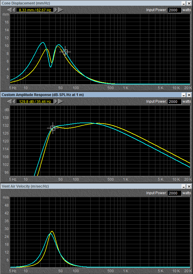

For the Tops, the idea that a 6" would not work well below 250 Hz sounds strange to me, do you have a explanation for this statement (of course depending on the driver). I've used 6" in column arrays and they nicely roll off at 120 Hz in sealed enclosures, the Faital Pro 6FE100 I used handles 100 Watt easily in a 10 Liter enclosure and rolls off at around 120 Hz. RCF, JBL and others use 6" a lot, must be a reason I guess 🙄.
kind regards,
Frans Wessels

I cannot agree on your thought process. I would, if I wasn´t there before with 12"s. Not anymore. At any point in my life, I´m not going back to 12"s. Propably not even 15"s.
I would not only expect 18" to walk over it. I experienced it in real life.
Used 12", when I begun to like loud music. 🙂. I had the chance to listen to some 2x12" setups, and even 3x 12"s (for example this one: Megaton DS312 lak - DAS12G | Reproboxy - Pasivní reproboxy - Subwoofery | PRODANCE). No matter what parameters it has, it all sounds either weak or with no low bass, If you don´t load the cone of small cone area speaker accoustically in BandPass, or some kind of horn. That´s why I´m going 21" after my 18SW115, which plays by me right now.
For theory of bassreflex boxes, here is how it goes. "Displacement volume is all that matters". To a point of course. Bl power has its word too.
18SW115 is in the same price ballpark as 2x 12TBX100 or 12NW100 to keep the game light and "neo", so lets take these.
Displacement volume of two 12NW100s is 0,955l. Displacement of 18SW115 is 1,69l. How do you expect those drivers to play as loud low, when they have "nothing in their hands" to move the air? That displacement difference is like 4-5db difference in capabilities. For Xvar parameter, we´re approaching 6db according to the displacement volume. That I would say, is significant. Okay, these small drivers have more normalized BL power on hand, but for what use? Cone control and damping, but that´s not really what you need at 30-60Hz anymore.
So lets break down your points:
True. The same as newer, better optimized driver capable of higher cone excursion in linear fashion. I highly recommend you seeing Clippel measurements of linearity. Those newer drivers are really something.
The question is if good PA driver has so much distortion that you must chase this on purpose and sacrifice possible power output. I would say you don´t.
Once you hit the wall of small speaker capabilities, you´ll get into very nasty pushing and distortions, while at the same output level, the large driver will go 6db under its maximum.
True, but again, not rellevant for bass content. Seriously... Cone breakup is in 1,5-2kHz range, and we´re playing 100Hz here...
True. Coil area of the 18SW115 is 124cm2. Coil area of two 12NW100s is 157cm2.
That is roughly 25% more power handling for 12NW100s. But for what use? Those drivers might work cooler, but what difference is that for us 100°C or 125°C. No difference really. I highly doubt that 18SW115 will run out of thermal capabilities in bassreflex box when driven properly. Very unlikely. If you put 1000W into the 12NW100, it isn´t going to look well, and the sound will will not be good either. Had both 12TBX100 and 12PS100, had a listening session with 12NW100.
True. It´s cool that the size of the driver scales so well with price.
If we threw in 21DS115 with three 12", it would be very similar situation. How cool is that.
Smaller drivers usually don´t do the same cone excursion. You have to load them more for less excursion, or they fail you miserably. Then we might get to horn-bassreflex or bandpass comparison, comparison, which is not what we discuss here.
For 6"s, its like I like to buy more expensive powerfull drivers, and those are usually very sensitive in the upper range, and not sensitive under 250Hz. You can EQ it back, of course....
So my sincere recommendation for you is to go larger. It won´t be worse, it propably won´t be even the same. It should be better.

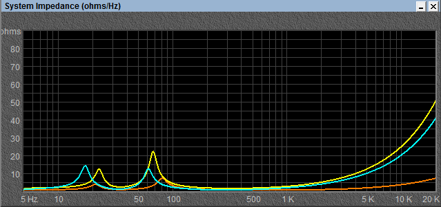

To really look in the power strain issue, we should compare impedance curves, thus efficiency. That would tell us more...
There you go. Close....
10" Orange
12" Yellow
18" Blue.
kind regards,
Frans
