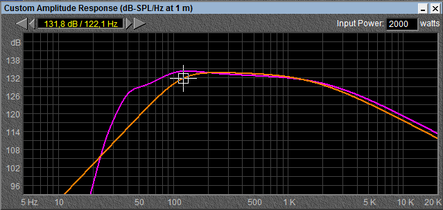

BUT..... then the other day, as I was driving to work (independent IT consultant for a living :yawn:), I got this brainwave: 😀
1 - WHY NOT
2 - OK, the satellites need to be SMALL, light and HIFI
3 - The subs need to be small and would be able to deliver a punch.
SO, what about a satellite with 2x 6" drivers in a v-shape (90 degree) setting with a waveguide in the middle of it. The 6" would be the horn extension for the waveguide. We woud need to make a "cover plate" that will transform this into a synergy "the easy way". I will make a drawing / first sketch but hope you get an idea. Now with 2 x 6" @ 90 degrees and a 1" waveguide, the cabinet would be 30 cm wide, 17 cm high and about 25 cm deep. It would be able to handle 300 watts low-mid and 40- 60 watts high (> 5 kHz or so). BUT with the high efficiency of the waveguide (107 dB / 1m SPL), the power difference will be NO issue. It will hit around 125 dB for one waveguide, which is almost exactly the same level as the 10" @ 300 watts each.
It will weigh around 7 to 8 kilo per cabinet. A Line array stack of 8 of these would be 156 cm high, 30 cm wide and weigh around 60 Kilo's @ 2000 Watts HIFI!?! a 4 wire single cable will connect all of them to the dual amp.
SWEET or what?😛
AND THE SUBS? I came at 2 x 10" push pull bass reflex loaded, also v-shaped which would require a cabinet of 50 cm wide, 30 cm high and 45 cm deep @ 15 kilo's (estimate with 15mm plywood). They could handle 600 watts continuous @ 38 Hz tuning. So 4 subs would a (side by side in front of middle of stage) 50 cm high, 120 cm wide and handle 2,5 kW with ease (8 drivers / voice coils), also, acoustic coupling adding 12dB (16 times louder @ 4 x the power), all for free. You would run into the 130 dB...
A "simple" PA would be 2 or 4 subs and 2x 4 satellites on 2 poles. Easy to set up by one guy, fits in a normal car. We are talking a 5 kW HIFI (35 - 18 kHz +- 3 dB) PA here.😎 or what?
I had this setup designed (in my mind and a little check with BB Pro) with:
- Faital Pro 10PR300 for the subs
- Faital Pro 6FE100 for the low-mid
- B&C WG7 waveguides
It's a 3-way setup high-pass @ 38 Hz (12 dB, Q 1,2), crossed @ 120 Hz and 5 kHz.
AND, it's "affordable", 10" @ 150 euro, 6" at 30 euro, WG7 @ 75 euro (each).
I've added a quick check graph from BassBox 6 Pro @ 2kW (2 subs, 4 satellites).
Purple is subs, orange is satellites
WORK ON IT ? Yes / No..
kind regards,
Frans

Hi. I had this 2x8" V-slot blast too. Didn´t go seriously into it, but it would propably do. Why not. The problem is usually low end. Two PA 6" in small box will not play under 250Hz well. And you usually need to go 70Hz for decent home usage. That´s why it looks like no-go to me.
For the subs, we obviously have different feeling for what does it mean small.
I would use 18IPAL in 100ish l box (two pieces). That´s small. 15SW115@90l is tiny. Anything smaller looks like waste of money for what you get.

Hi Frans,
I'm liking the sound of that; there is a thread on another forum where a guy has built a TPL150H/8" ported enclosure for a line array - 8 per side! This guy must have deep pockets! I have no experience of the particular drive units you mention, but have played with the Faital Pro 5FE120 and found it to be very good.
Don't forget that 'twice as loud' to our ears requires about a 10dB increase in spl, so the 12dB increase you mention is only a little more than twice as loud, subjectively.
I haven't tried different crossover points to the subs, but played the system at 80Hz the other night. This appears to be the limit, after which localisation the subs could be a problem, according to general opinion. Something to experiment with though; PA and hifi can be quite different, but there definitely needs to be more PAFI out there.😉
I have yet to experiment with very small multiple subs, but have 16x Tannoy 8" and 32x Peerless 6.1/2" to play with one day!
Work on it? You bet!
