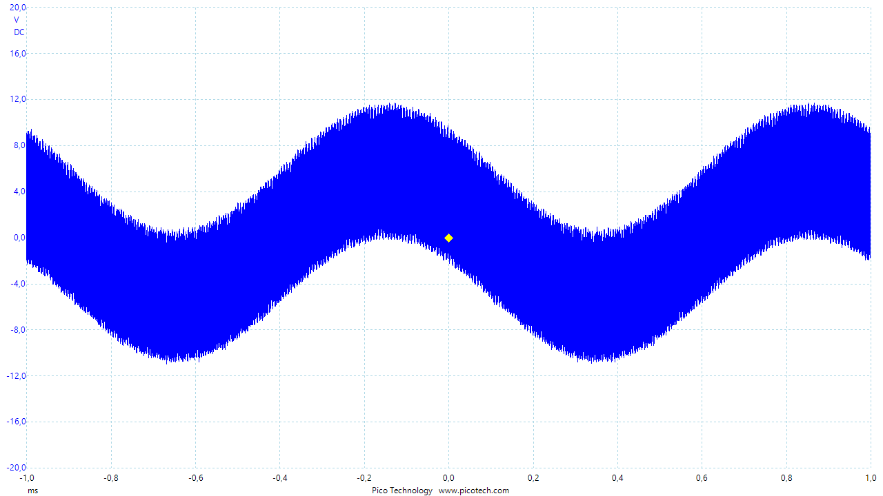

so... trying to get the bppbp to play... all is soldered in but on channel I get nothing but noise, and when I open the valume passed half way, DC offset increasing with 'volume'. the DC is not present on the output of U2/A, only the output of U2/B shows this. Would anyone have an idea where to start searching?

If one chan is good and the other bad, that makes it a lot simpler!
Start by measuring the DC on all opamp pins and see where the difference is.
Then we look at the next step, working backwards.
Jan
Jan

The DC offset thing is one channel only. But both channels look noisy on the scope (pico scope to laptop on batteries). The interesting thing is... they're noise with or without power applied. Which makes me think I might have to review grounding. I have connected the centertap of the transformer to safety ground, and I see a lot of noise on the scope when measuring between two points connected to ground. Maybe I'll start there... .
Given the amount of time I have it will be slow going... .

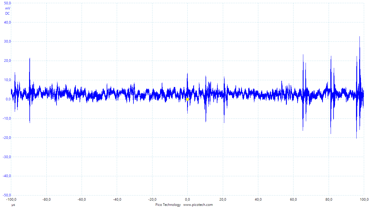

With no power applied, Relay K3 will keep the output short circuited.
So when there's noise to be seen on your scope with no power, this has little to do with grounding.
What amount of noise do you see coming from your PicoScope when connecting the hot side of your probe to the ground strap.
Hans
Hans

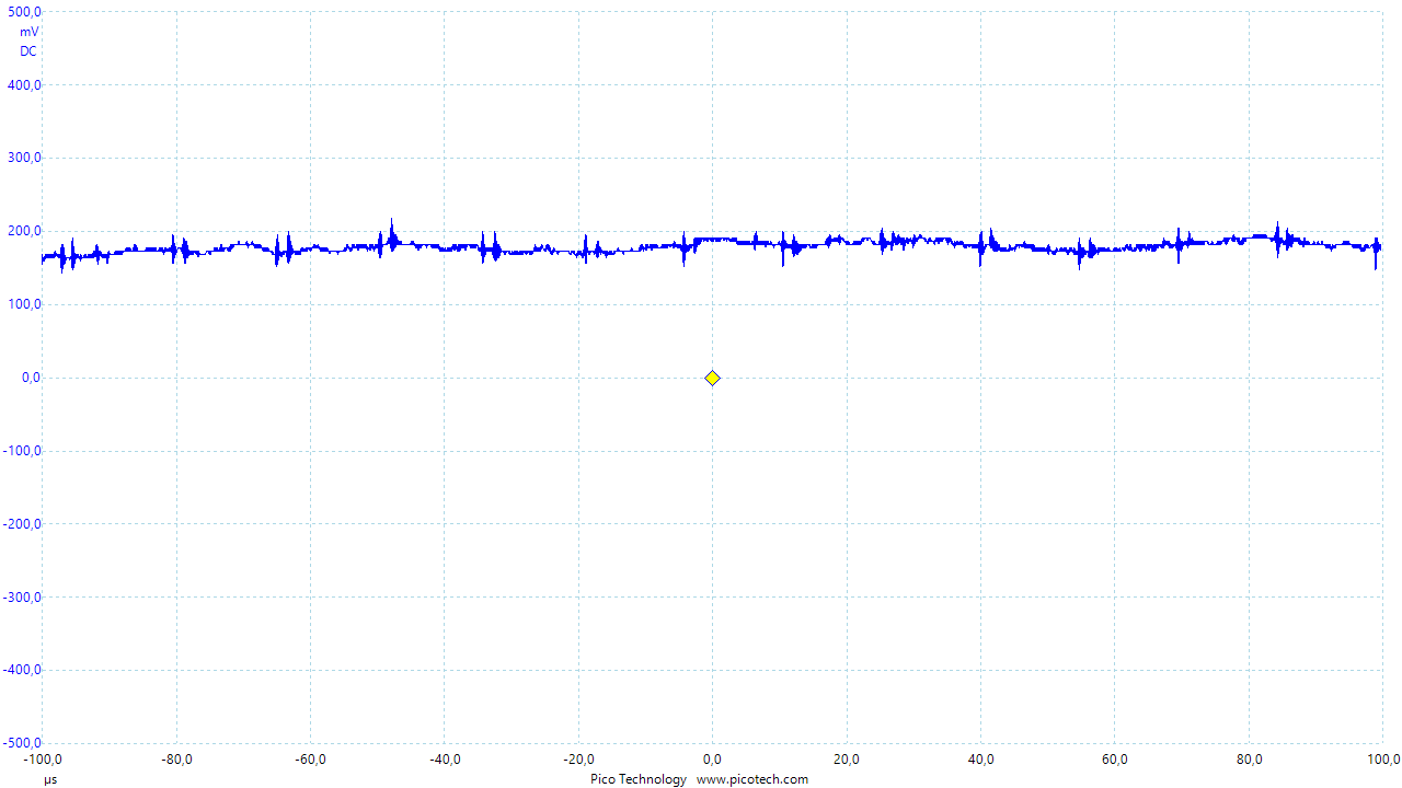

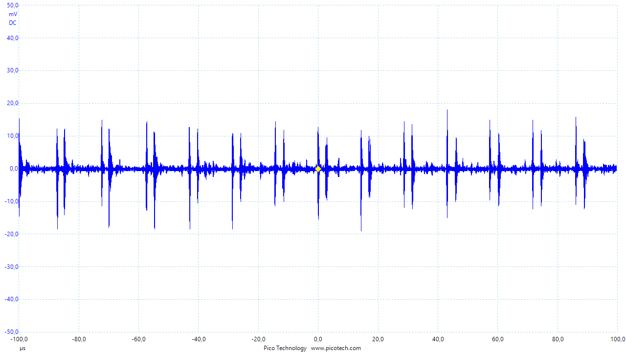

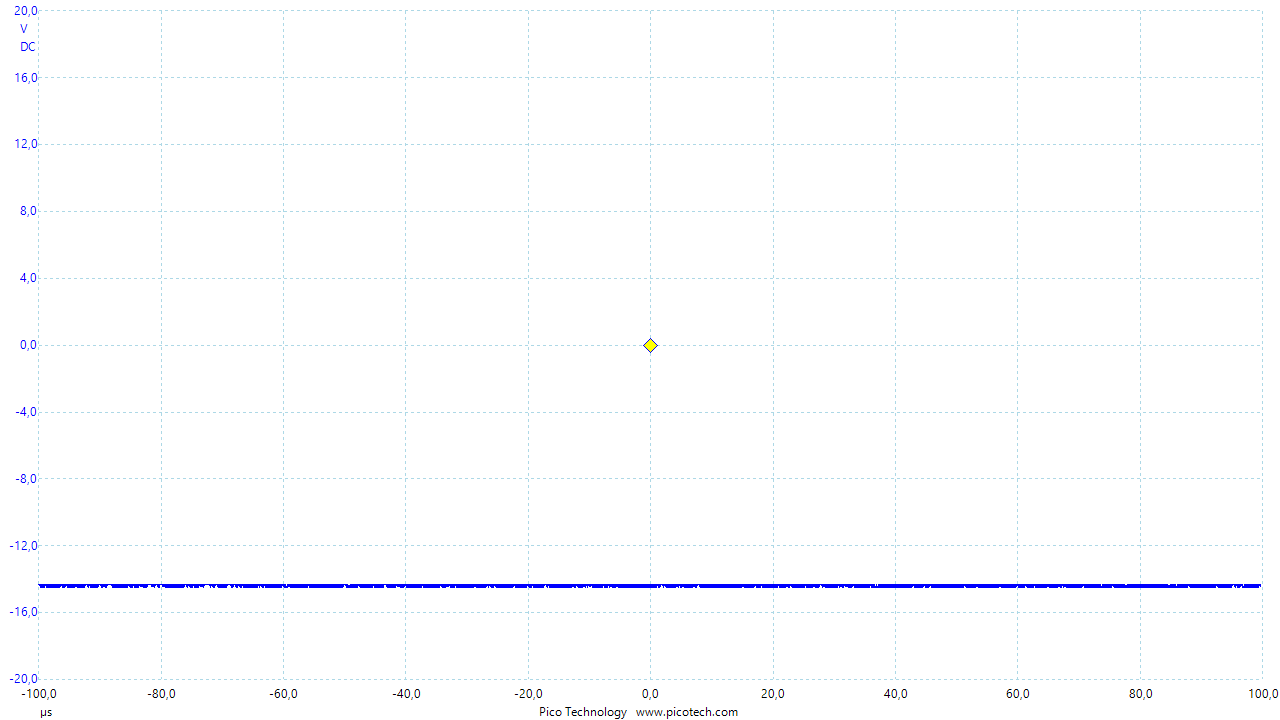

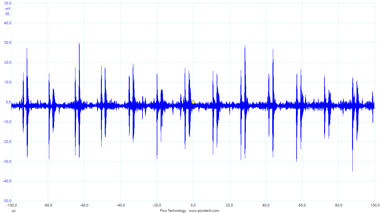

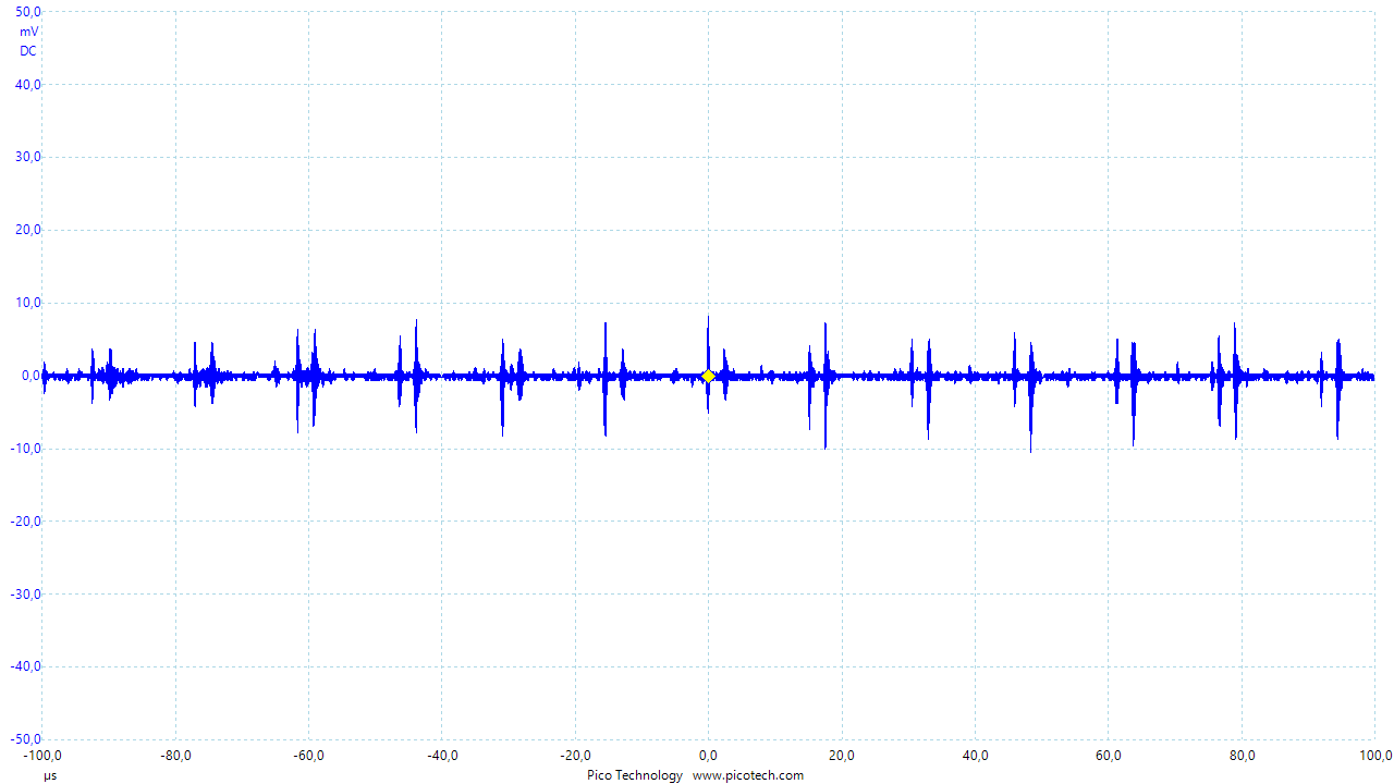

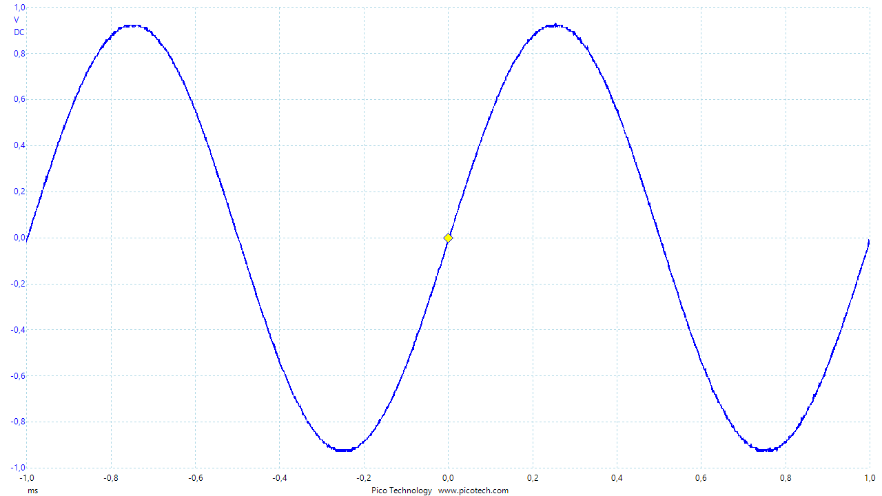

Some Measurements...
Finally managed to collect some first measurements. (a lot to learn, posting inline images for one...)
1. probe hot pin and ground strap shorted. Doesn't look much different from groundstrap and hot pin floating.
plugged in, with no power applied (ground connected to safety earth, line and neutral interupted):
2. Ground to pin 3, similar image on both channels and for both pin 2 and pin 3)
3. Pin 2 to pin 3. looks similar as ground to pin 2/3 but higher amplitude
looks like interference from something my desktop pc connected to the same circuit.
Power on, input shorted:
4.-7. At low volume, a similar image as before, but higher amplitude, with increasing volume nothing really happens until somewhere passed 60%. left channel gets negative DC offset, right channel positive.
Applying a signal to the input:
8-10: with low volume, the signal is present and amplified, but seems noisy, rotating the volume pot increases the volume at the output untill somewhere 80% when I get something that looks like oscilation to me.
Next I'll work my way back as Jan suggests. Are there any tricks to connect a probe safe and reliably to an smd opamp output? Just a steady hand?

Rob,
In your previous email you mentioned that you were using a laptop running on batteries.
Is this laptop still connected to a mains charger or is it completely disconnected from mains ?
With no power applied, figure 2 shows a 50Khz signal, typical for a SMPS.
This could be the Laptop charger, but anyhow, this signal is most likely picked up through your probe's ground lug.
With power applied, you show a signal coming through.
Is this for the working channel or for the defective channel.
And yes to keep things stable, don't turn the volume too far, no further than 6dB gain to start with or oscillation may occur.
First try to get a clean signal from the preamp. You could even use four 9Volt batteries to power the preamp, to have a fully floating test setup.
Begin with checking whether all IC's are mounted the right way and not turned by 180 degrees. Then check if all IC's are having a stable +/- 12 Volt on their pins.
And yes, as a next step follow Jan's suggestion and compare both channels to each other and see where they start to differ, with and without an input signal applied.
Measuring SMD Amps can be done with a steady hand, but you can also put the scope on a resistor connected to the relevant SMD pin. That will be more safe.
Succes, Hans
