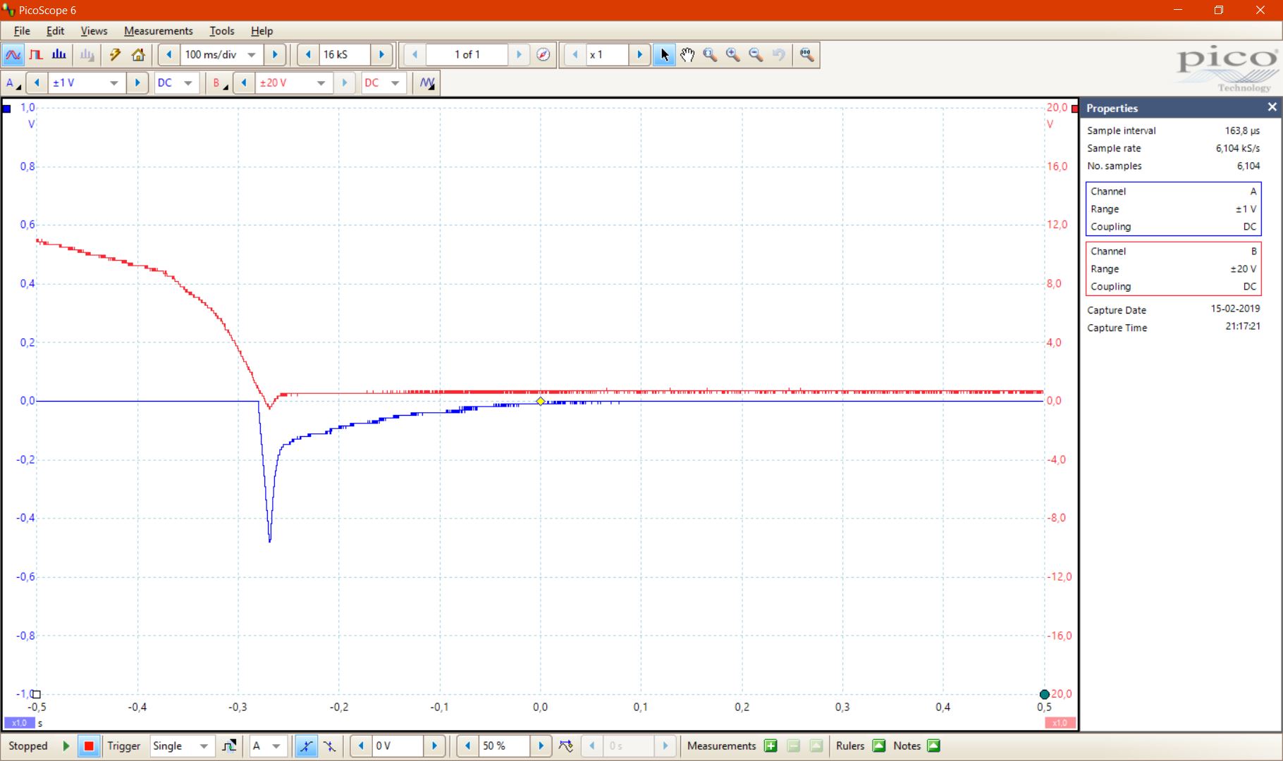

O.K., I thought your scope image was showing +VOP.
Then the next thing to try would be to change R54 into a much lower value, like 680 Ohm or 820 Ohm, thereby driving T3 less into saturation.
Because switch off should happen within 4 msec and that's not what I see.
Hans

Thanks Hans, I am learning a lot here. The relay I used is TE MT2-C93402, which draws 12 mA, so I wanted to use 560 Ohms. That didn't solve it. I went as low as 390. Still "pop", but the discharge curve did change (see attached, measuring supply to the onboard regulator this time). Then I mounted a small pot in place of the resistor and found the minimal resistance for saturation: ~260 Ohms. Still "pop"... Then I tried disconnecting the DC supply from the BPBP board (instead of switching off mains like I did before). No more "pop"! The root cause must be somewhere among the mains switch, the transformer and the pre-regulator, but those will be replaced anyway. In the meanwhile I put the 390 Ohms resistor back on, for fast off-switching.

Great, that’s what they call a learning curve 😁
Succes, Hans

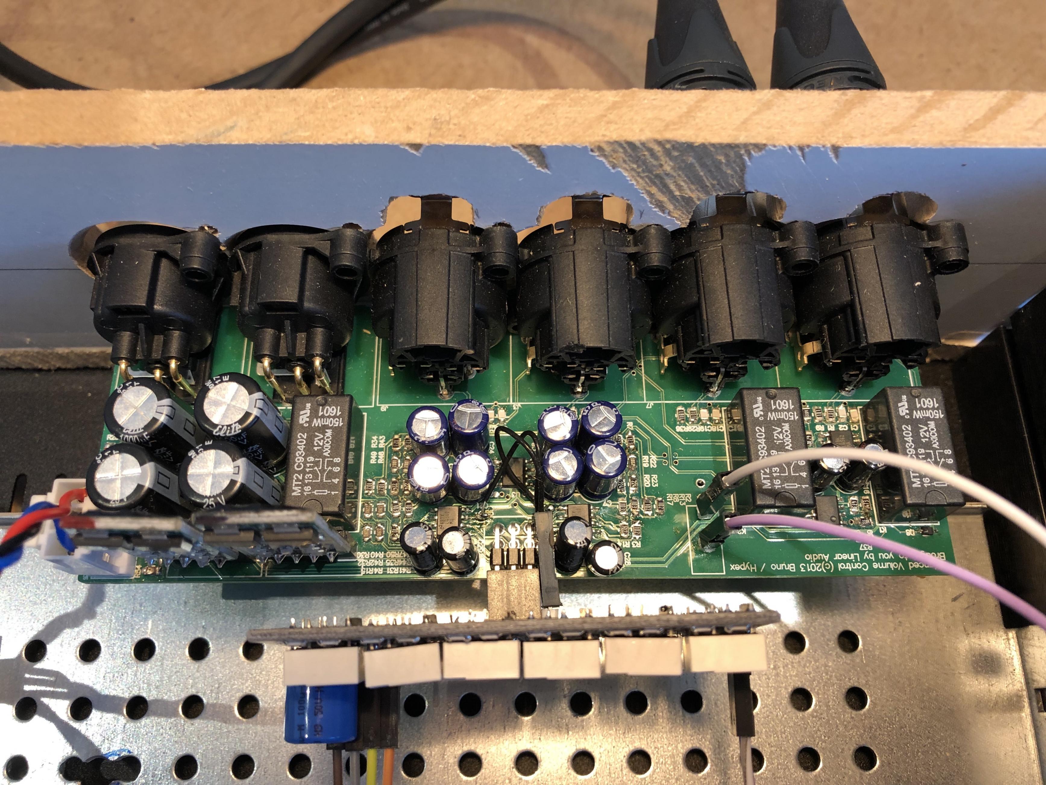

Got the preamp in a decent enough state now to plug it in to my main set. See attached pic and the ones on this post.
I was curious to know the output impedance so I measured it and got to 22 Ohms. Anyone else ever measured it and got to the same number?

That's Ro connected to the output amp, so the 22 Ohm is exactly as expected when the other side of the measurement is Gnd.
But in the connection to the main amp when using a balanced input also, output impedance is 44 Ohm.

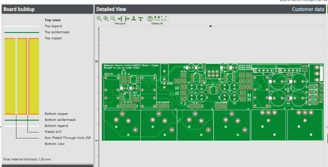

Does anyone have the top cream file for the BPBP boards ... looking to make a stencil for solder paste application ... beats soldering individual surface mount parts.
Looking to give me new PCB toaster oven from Ali Baba Express some run.
was wondering the same... I think with a good CAM editor you can extract that from the top copper layer... but in the end, I will go for a long and trusted hand soldering session so I stopped worrying about.

What do you mean by 'paste layer'?
Jan
Paste Layer is ... usually ... the layer that carries the opening for the stencil mfg.
The stencil is used to place solder paste directly on the board passing into the openings...
It is usually included when SMD parts are used in the design and it is very useful for the automatic setup process... I usually solder by reflow oven and a stencil is still useful.
Anyway... I have armed myself with proper patience and a cam editor.
Attached is the Paste Layer.
But... I have checked very little... the pads are shrunk by 0.1mm on H and W.
for everyone who is thinking of using it, please triple check.

I see. In my case, I have sometimes ordered a stencil but the board manu created that from the solder mask layer. Its an automatic process. You could ask.
Jan
it's important that the automatic process that creates the stencil properly shrink the solder mask...
USUALLY, you have :
the copper aperture that is a certain size.
then the solder mask is expanded (in respect to the copper)
and the solder paste is shrunk (in respect to the copper)
Is also very important that the process properly ignores the apertures that belong to through-hole components or pads that are designed as test points (or net-ties in this case)
I had mixed experience with automatic creation of stencils on various PCB fab house.
This time i have made mine... check it and use it.
