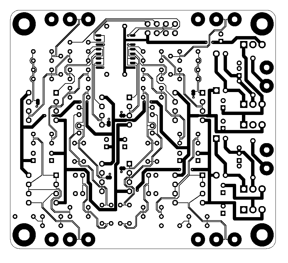

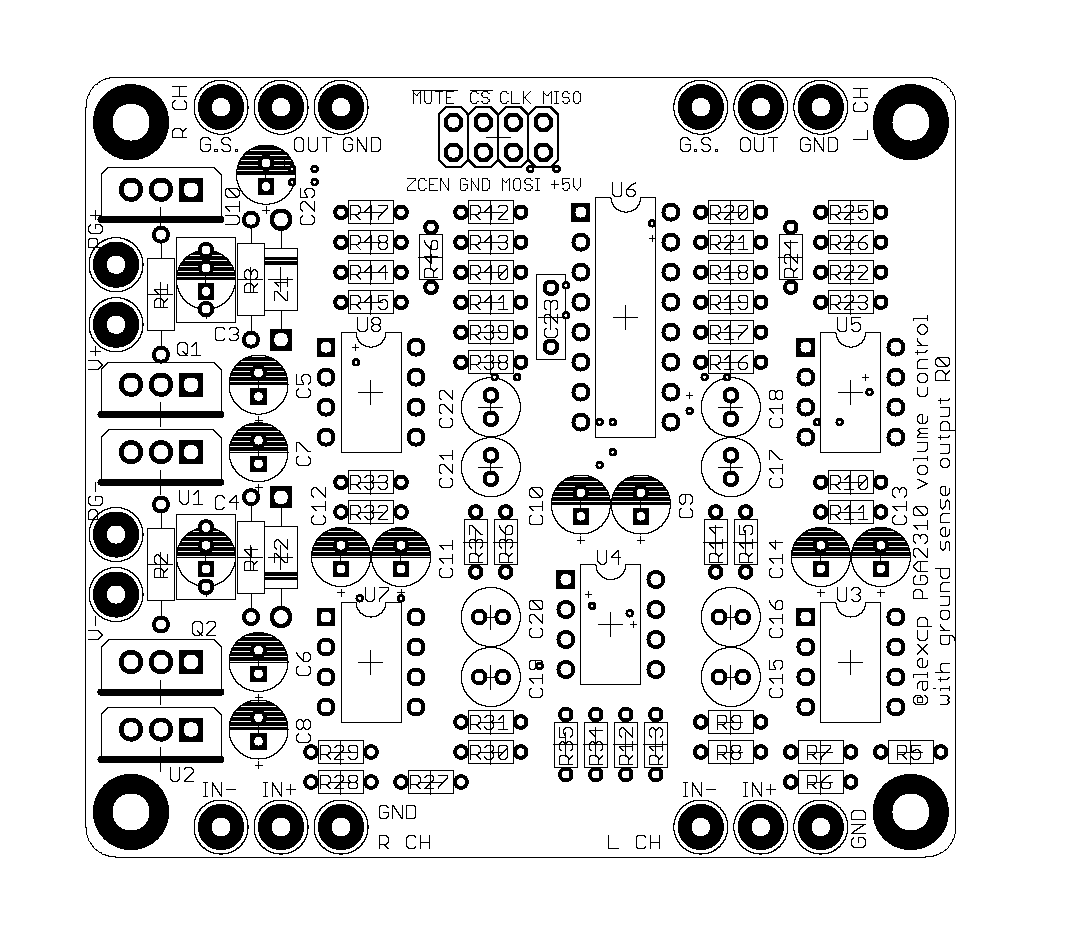

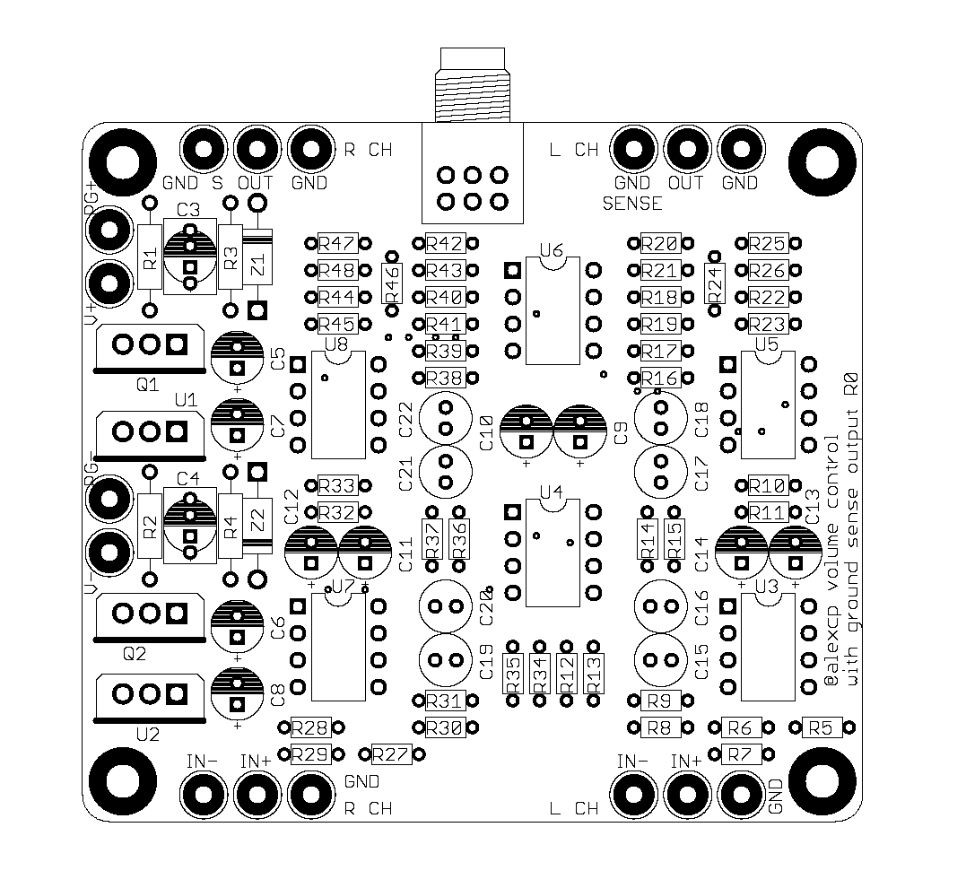

After building no less than three BPBPs - thank you Bruno Putzeys and Jan Didden for the article and the PCBs - I re-implemented BPBP with through hole components and a couple of minor twists. I built versions controlled by a normal mechanical pot, a WM8816 and a PGA2310. Details are here.

The beauty of Putzeys design is not exactly the circuit diagram that is also used by Mark Levinson and others, but in the very smart design of the PCB, thereby avoiding ground loops, crosstalk and CMRR.Thank you!

I agree - the whole point of this exercise for me is not to try yet another schematic but to learn how to make low distortion PCBs. Mr. Putzeys' method works here and also for gainclones/chipamps.The beauty of Putzeys design is not exactly the circuit diagram that is also used by Mark Levinson and others, but in the very smart design of the PCB, thereby avoiding ground loops, crosstalk and CMRR.

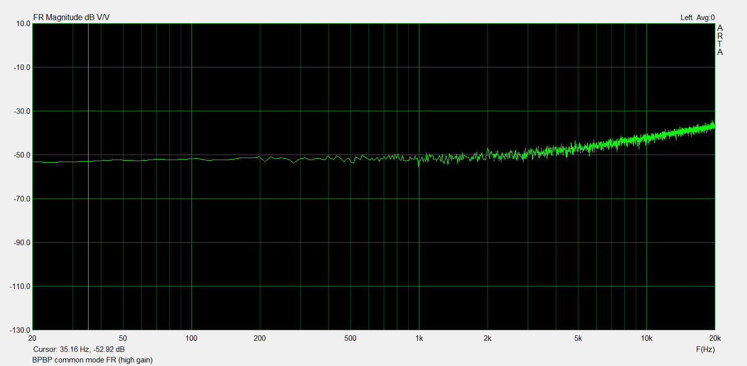

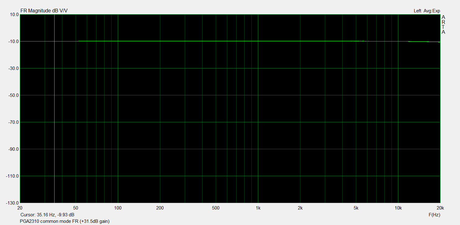

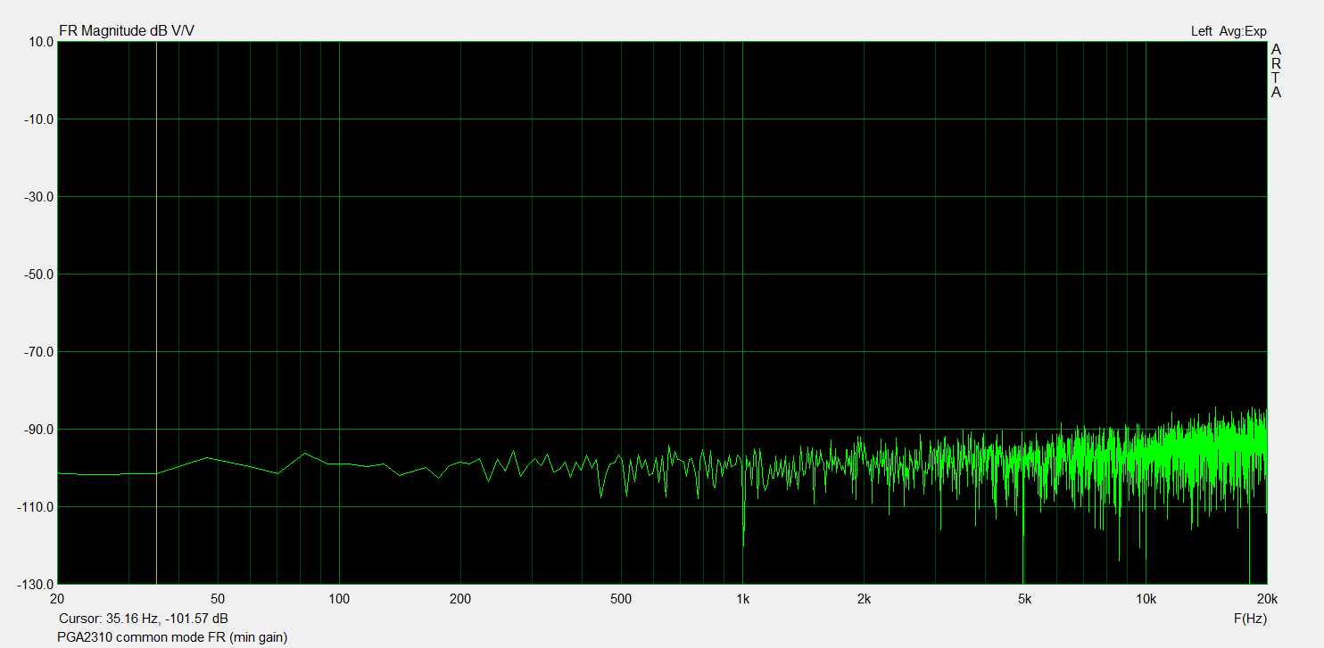

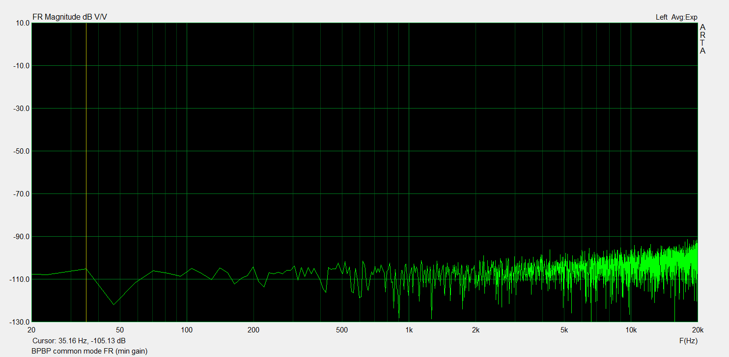

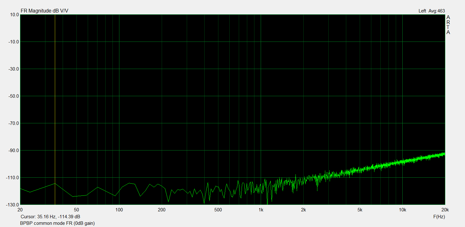

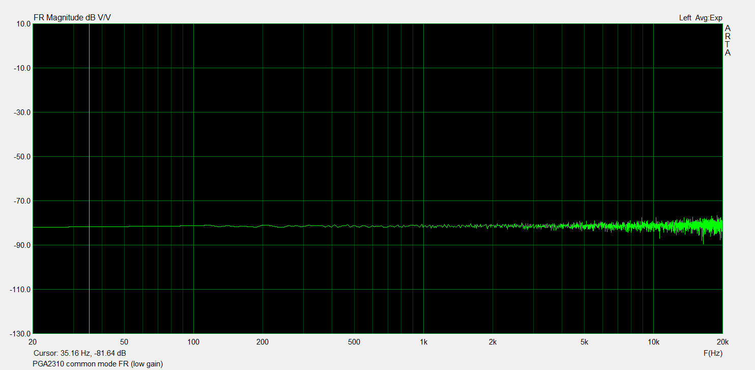

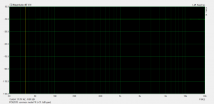

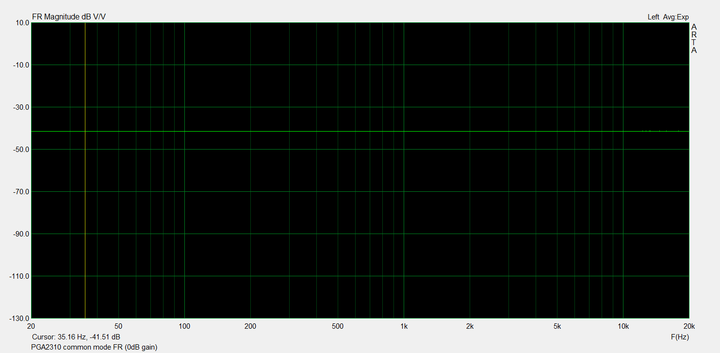

See attached. Not quite apple-to-apple, as resistor tolerances in my BPBP are better than in the through-hole board, but still interesting.So out of interest to compare, could you give it a try to measure CMRR vs frequency with your through hole PCB in a few different volume settings ?
- The first three graphs are from my BPBP on Linear Audio's PCB with 0.1% resistors, at different gains: min gain, ~0dB (pot at 12 o'clock) and close to max (~3 o'clock).
- The next four are my PGA2310 board with 1% resistors (limiting CMRR to about -50dB), also at several gains: mute, some low gain between mute and 0dB, 0dB, and max (+31.5dB).
- The last one is my board at 0dB in the normal differential mode, to set the level benchmark.

O.k., thanks for doing all the work so rapidly.I agree - the whole point of this exercise for me is not to try yet another schematic but to learn how to make low distortion PCBs. Mr. Putzeys' method works here and also for gainclones/chipamps.
Hans
