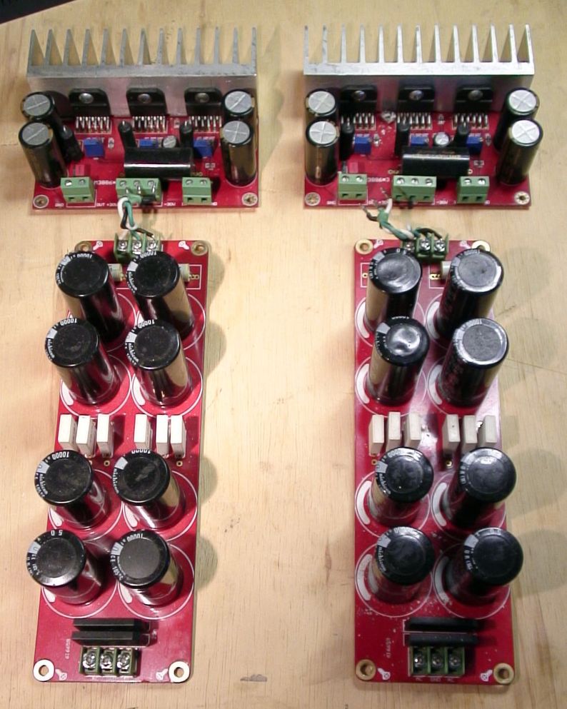

Basing on alexw88's (shine7.com) experience, I've created my own project of PA150 (3xLM3886). It has been modified a bit, the size has been reduced, and some other tweaks have been made. I'd like to share the project with you (below). PDF file with switchable layers, try it! I'm gonna order the PCB soon, if anyone wants to grab a couple of PA150 PCB, let me know. Of course, tweaks still can be done before the order.
PCB layout:
http://airproject.drl.pl/PA150v18.pdf
Power supply up to +35/-35 VDC. LM3886 datasheet.
Details: PA150 - 3x LM3886 PCB assembly guide
I has been well tested by alex88. Testing and measurement:
DIY BPA300 6x LM3886 300W audio Amplifier
It is still the same project, except the capacitors which were moved from the bottom to the top, C10 (10u) replaced with wima (better solution), and some downsizing.
Anyone who is interested, just give me your e-mail address and I will send you some details.
Of course don't hesitate to ask questions 🙂

I finish mine a few months ago, i disarmed it to work in the case and when i put back today i had a short circuit on the psu. the LED light start smocking and then blew up as i was shooting it down.
psu,
I replaced the capacitors from 4x10000uF to 4x22000 last week and i retoched some joints in the area, i may have mess up, i hope the flash did notruin one of the capacitors.
New PSU in. Soft start added and not smoke so far. will test sound with new caps tomorrow.
