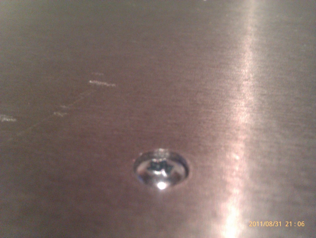

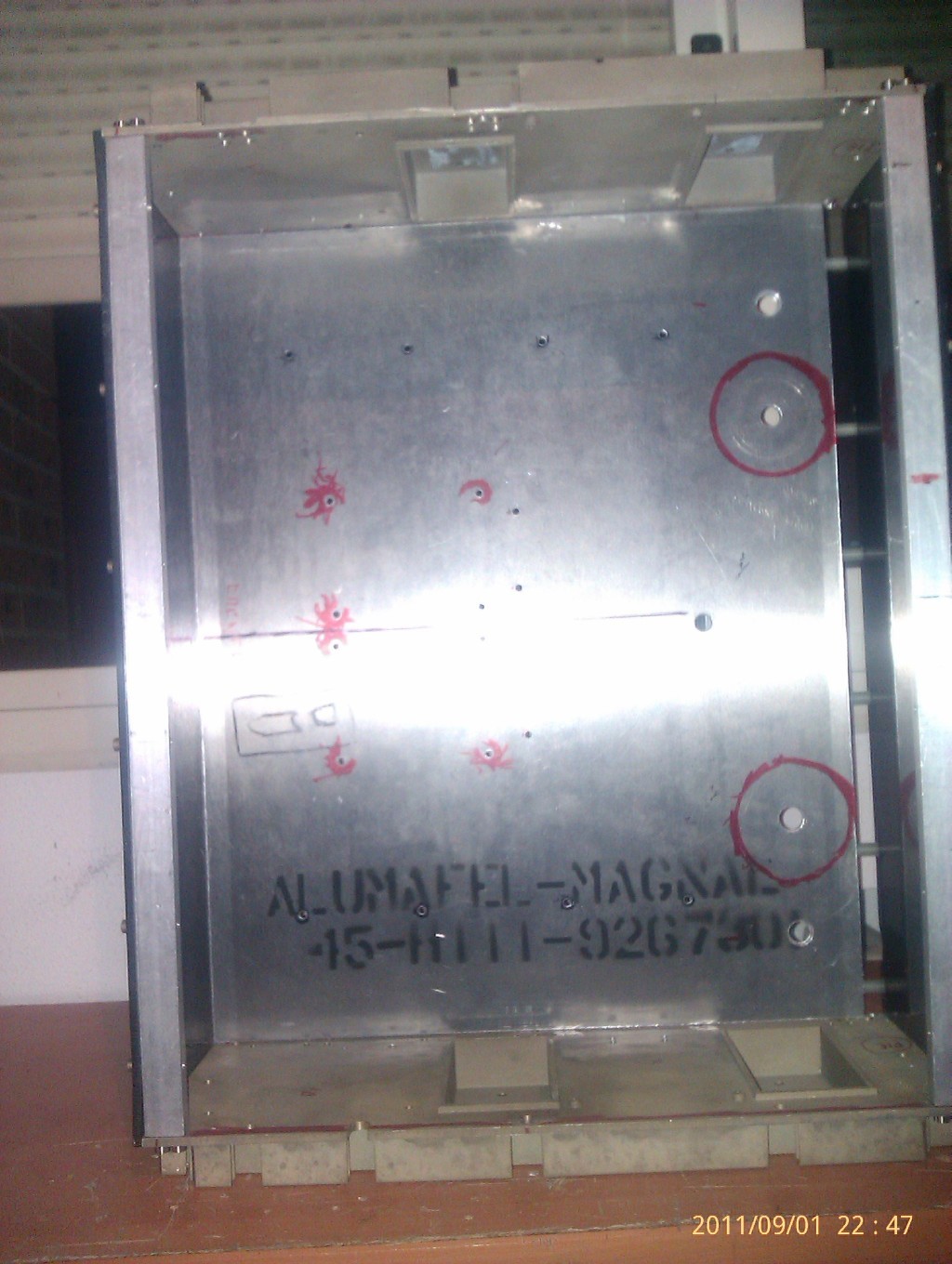

I managed to don't make any tapping (lucky me) 😛 I made "fake holes", don't know the name in english. See the attached picture.

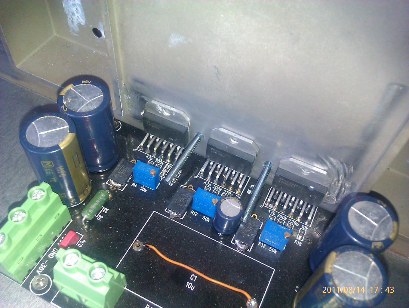

Dear marlowson,
recently I am trying to re assemble my long time never touch project, my bpa 300 alex wong (3xlm3886) , during test i found 1 of my lm3886 very hot,compared to 2 others, when i checked it broken , and i change with new lm3886 (picture attached) why its still very hot (from pin 3 i measured 16vDC at output) compare with the old 2 lm 3886, but when i assembled only using 1 lm3886 (non inverted configuration refer to chip amp.com design, it is works fine and i am tested to my speaker and tested for hours, was there any mismatch or diferrent configuration of pin of these new batch of lm3886 (serial number JM06ARE3)? realy need your help bro!
Dear marlowson,
BPA 300
GOTCHA..! Problems fixed, I must not mixed different batch of lm3886t , three of themmust be in one batch number...it's sound good enough to my modified jbl lx-6
