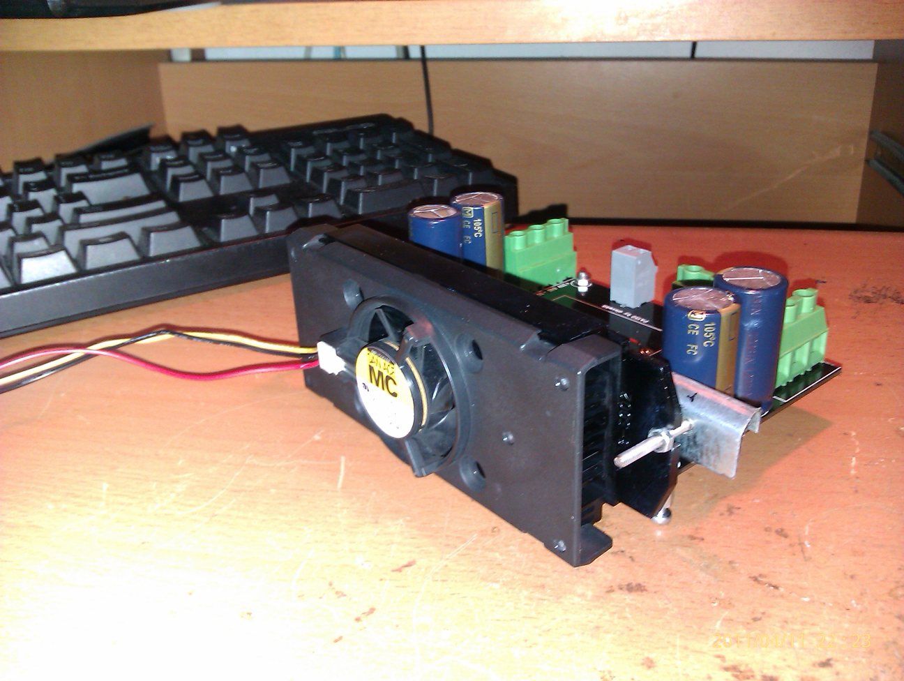

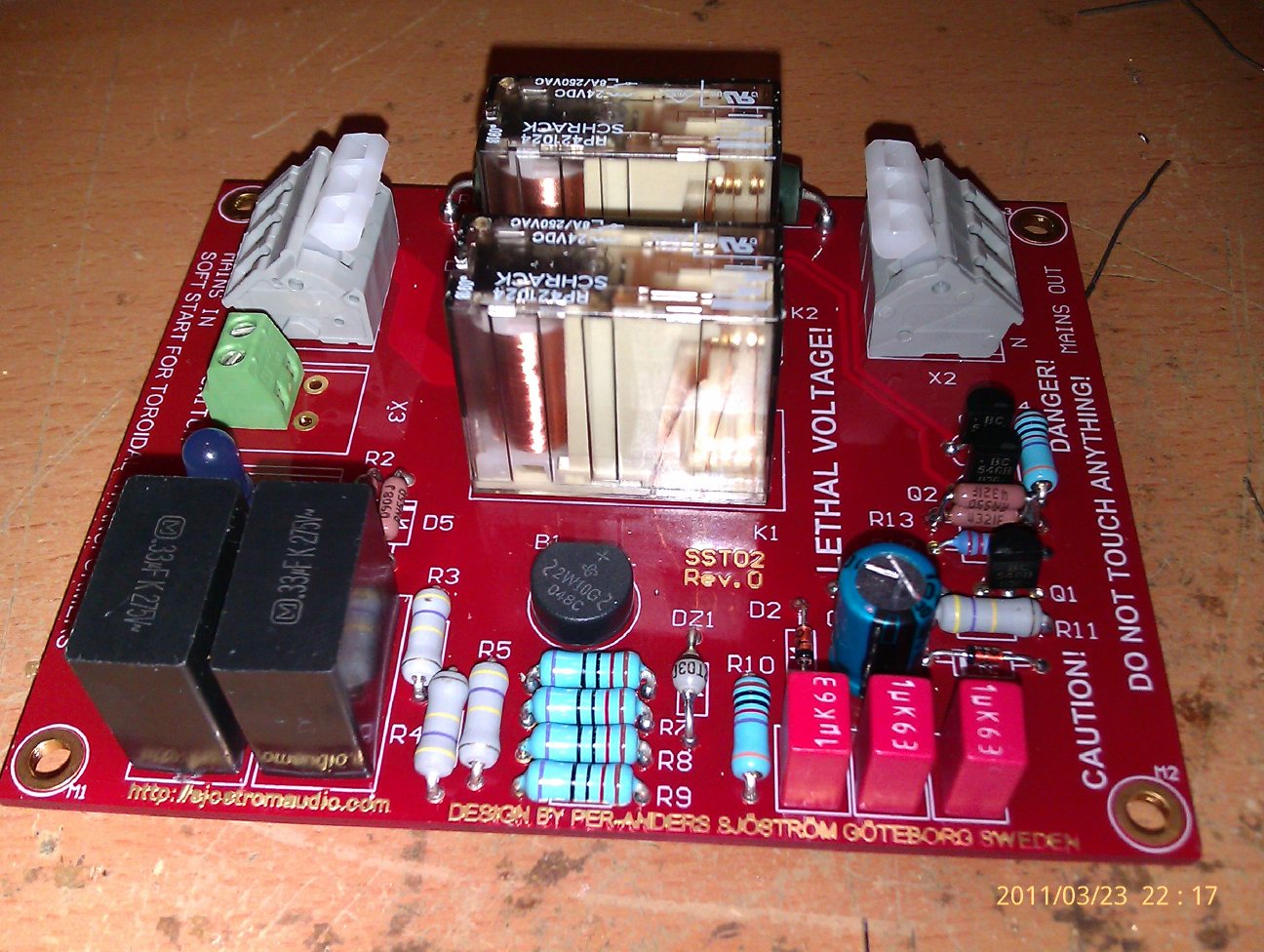

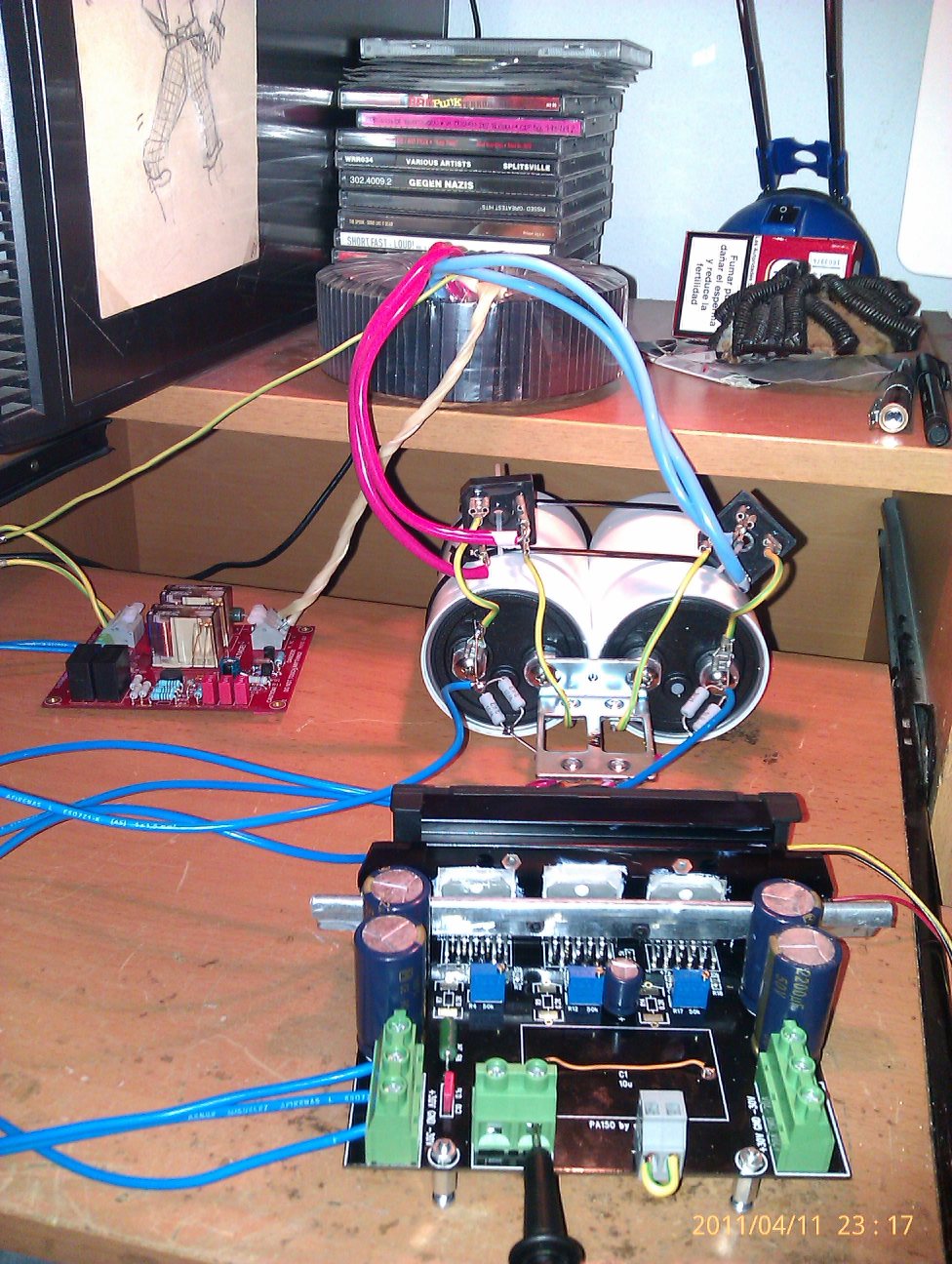

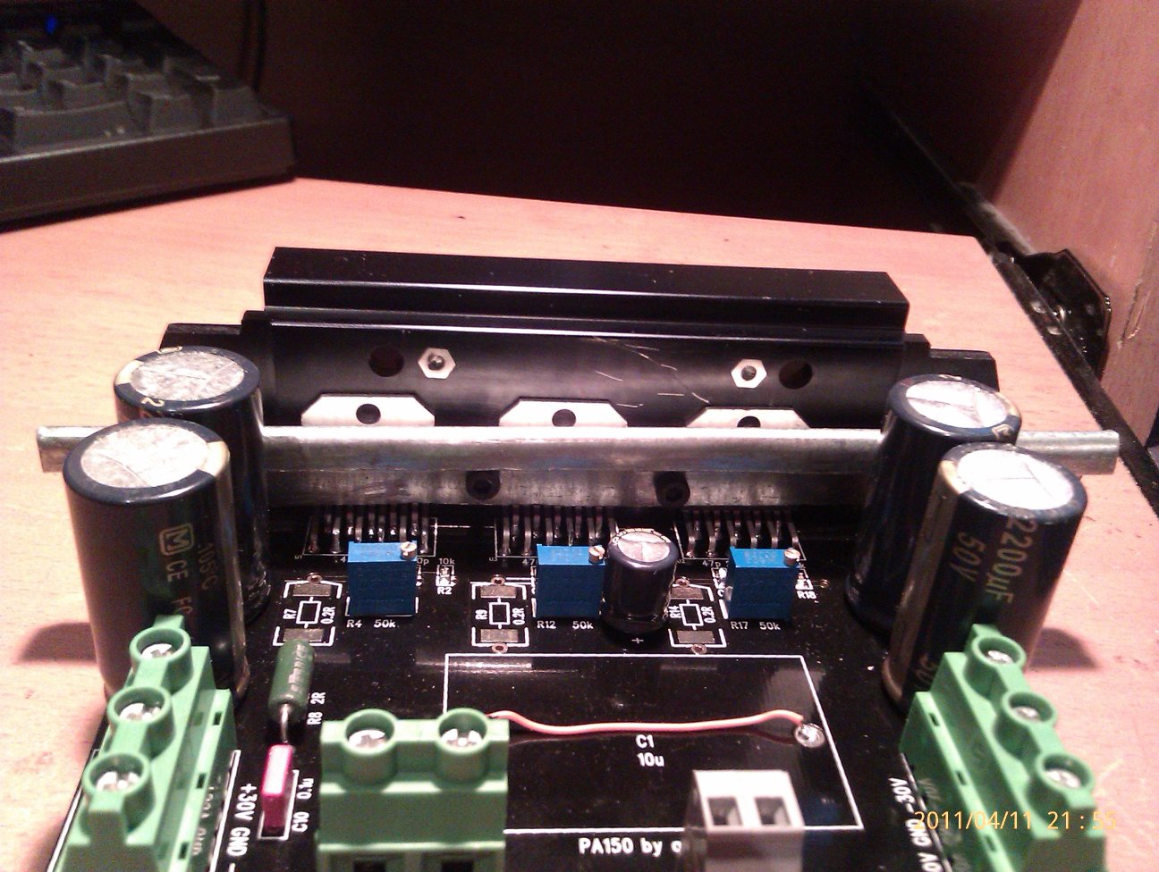

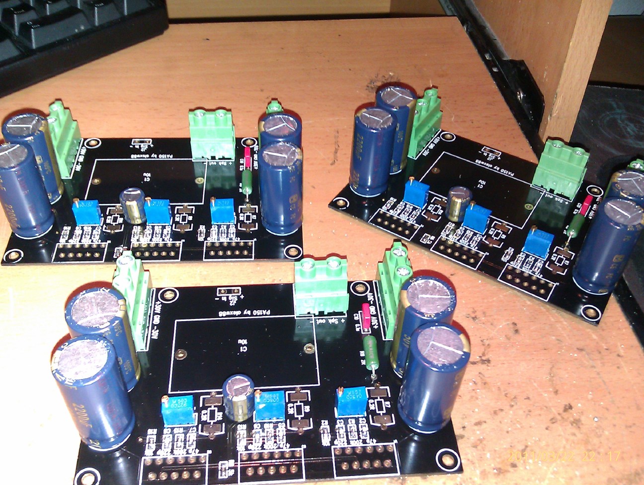

Here you can see the finished boards.
-The red ones are two protection PCBs for inrush current protection, courtesy of Per-Anders
-One of the board mounted on a Pentium II heatsink for DC trimming and -testing purposes.
-And the whole testing setup.

I look at this BPA150 layouts such as these, very nice by the way, and wonder how many boards are out there worldwide.
