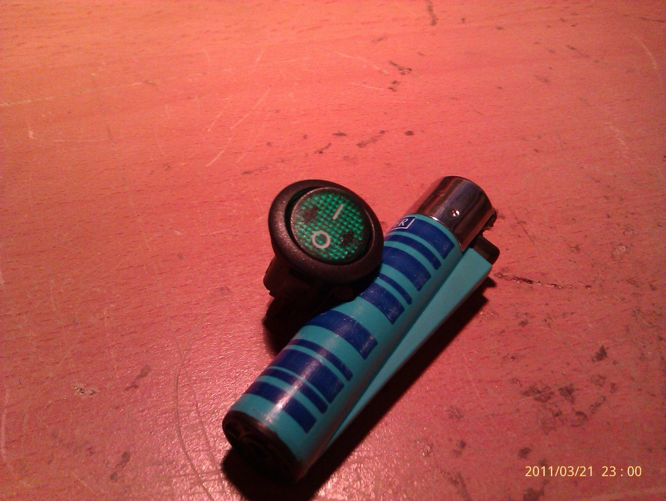

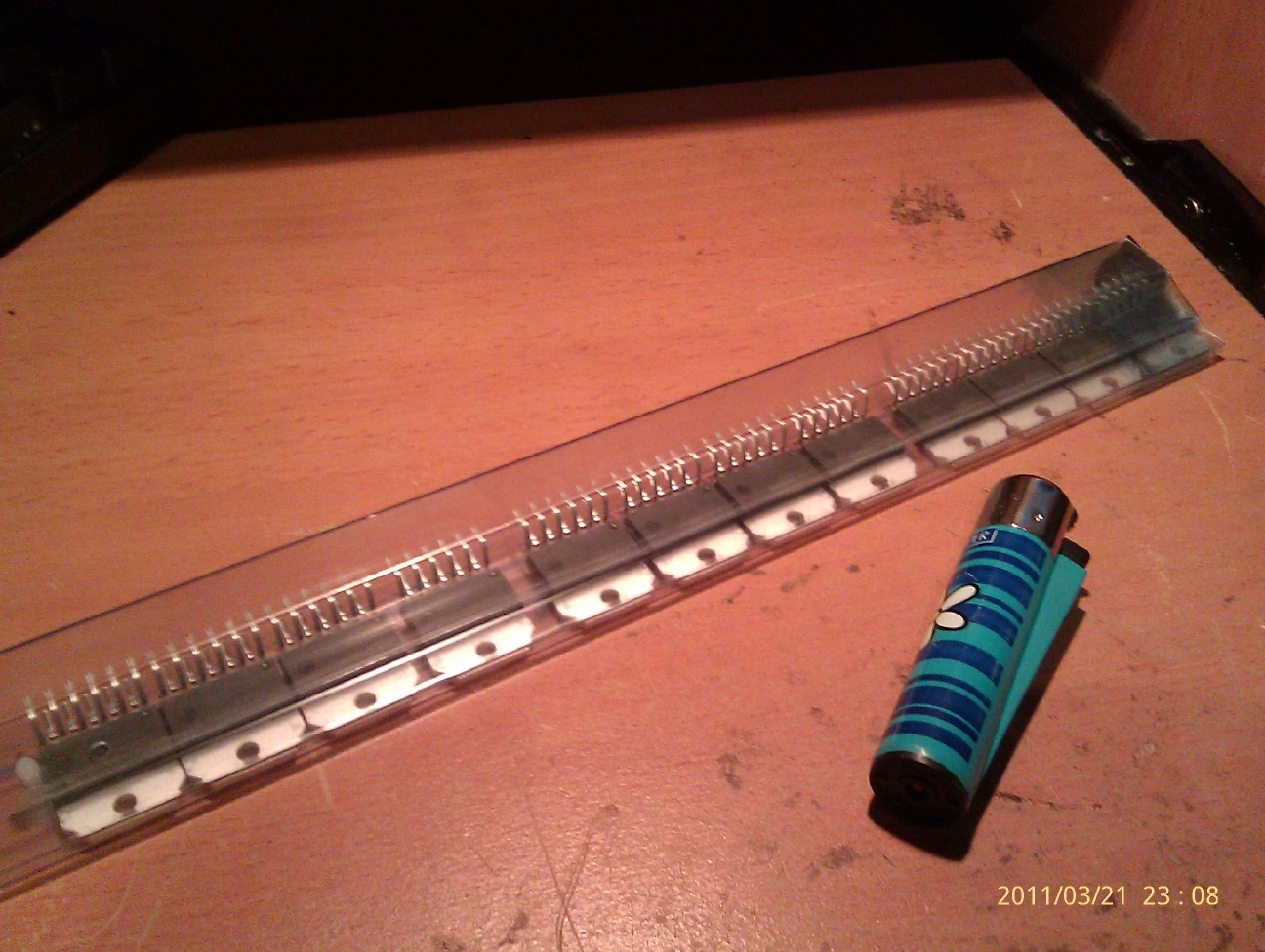

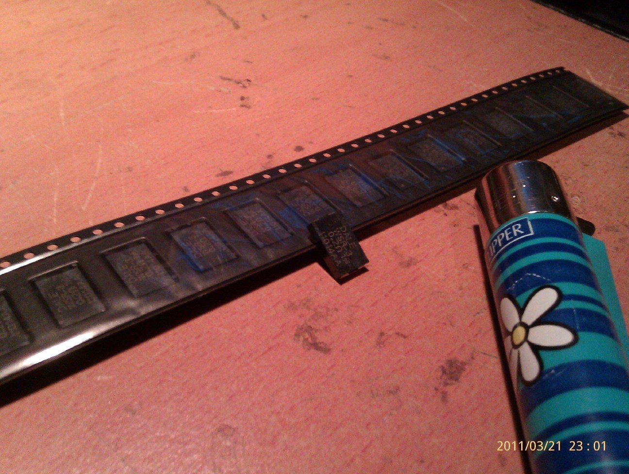

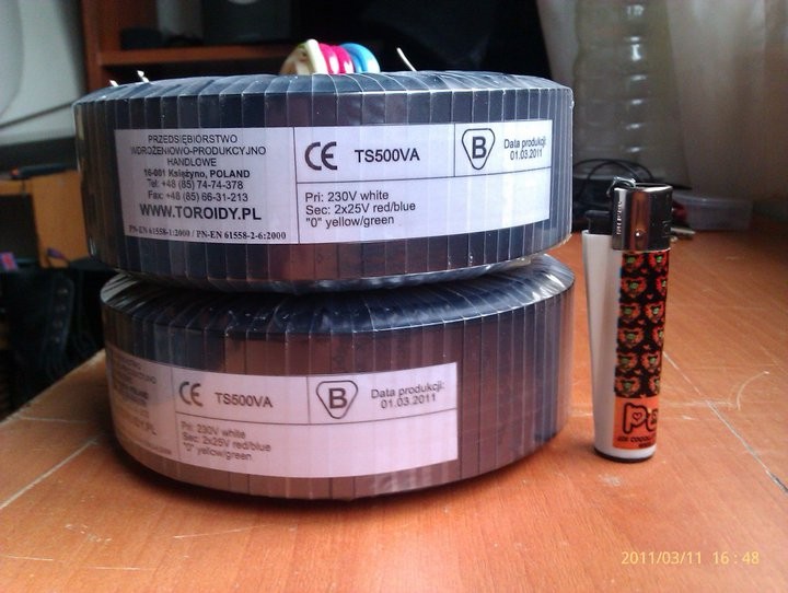

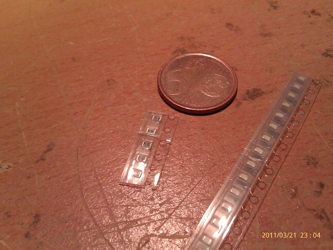

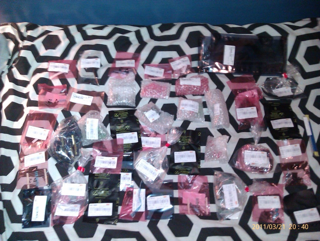

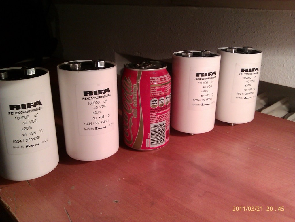

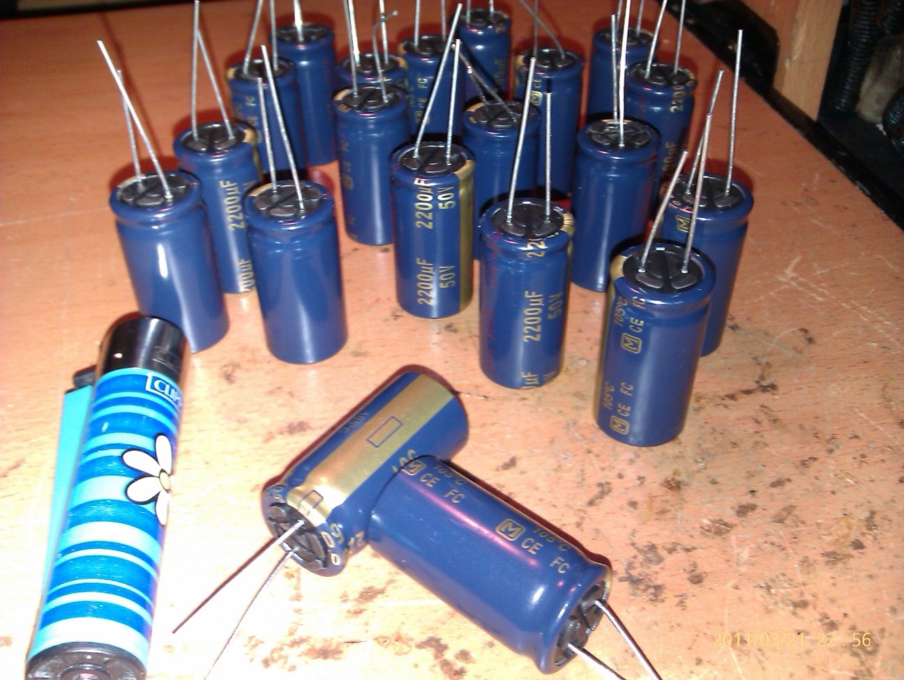

Well, i will show you some progress I've made around my BPA-300 construction. It's being made for a friend, as a no-mind-cost proyect, so everything is quite overspecified. It's encased as two monoblocks inside the same enclosure.
Attached are some pictures of the materials,
2x 500VA 2x25vac ordered from toroidy.pl
4x 100.000uF 40v RIFA PEH200
16x 2.200uF 50v Panasonic FC
Hefty refurbished big heatsinks (from military equipment)
Other received stuff...

Where did you get those nice Rifa capacitors. I have always considered them to be at the top of the pile. They pack a serious charge. Mind me asking how much you had to pay.
