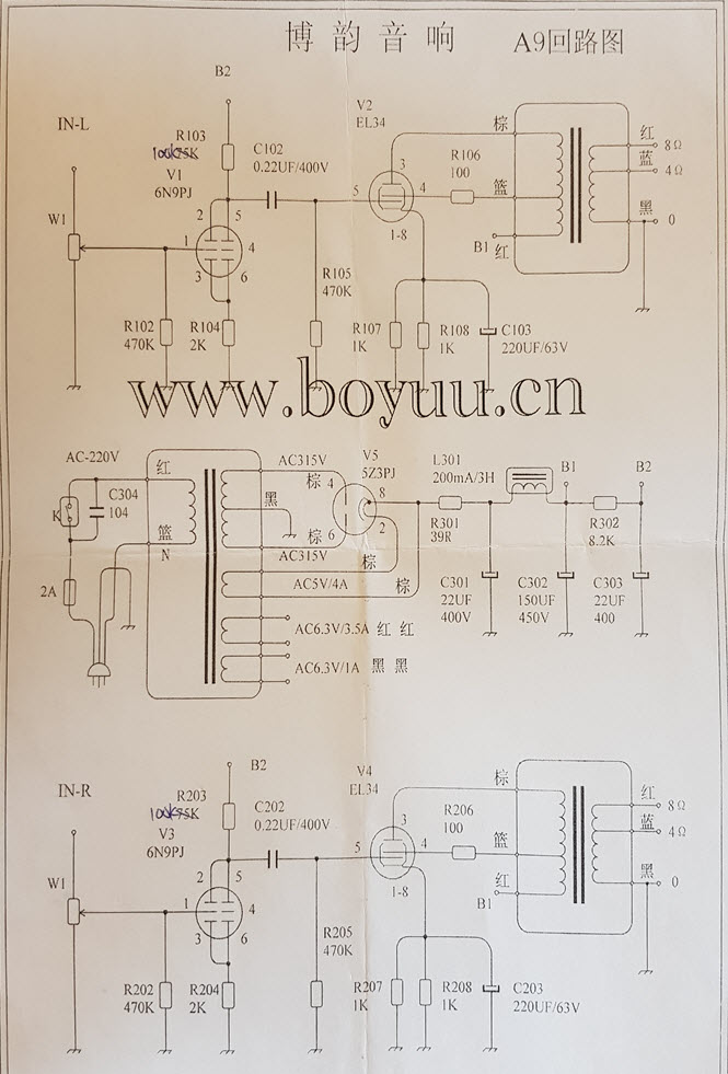

There are many circuits proposed in the 25 pages of threads here.
Miller effect can cause high frequency roll off, unless the grids are driven by a medium to low impedance (that is your preamp). Also included are the parts leading to the grids of the parallel 6SL7.
If you use a 6SL7 in parallel, and you have a preamp with a volume control to drive it:
Use a preamp that has a medium or low impedance output.
Use a very short shielded cable from the preamp to the input connector.
Use a 470k Ohm resistor from the input jack to ground (and eliminate the 100k pot)
Use a 1k Ohm grid stopper resistor from the input connector to the parallel grids.
Do not use the 10K Ohm grid stopper, as proposed in one of the threads. 6SL7 has a grid to plate capacitance of about 3pF (6pF for 2 triodes). The u (mu) is 70. Miller effect can be up to 70 x 6pF = 420pF
The - 3dB point of 10k Ohms and 420pF is 38kHz, and the -1 dB point is 19kHz. 10k seems a little to large, because other parts of the amp also have high frequency roll off, like the output transformer. -1dB here, -1dB there, -1dB another place, and pretty soon you are talking about -3dB (half power).

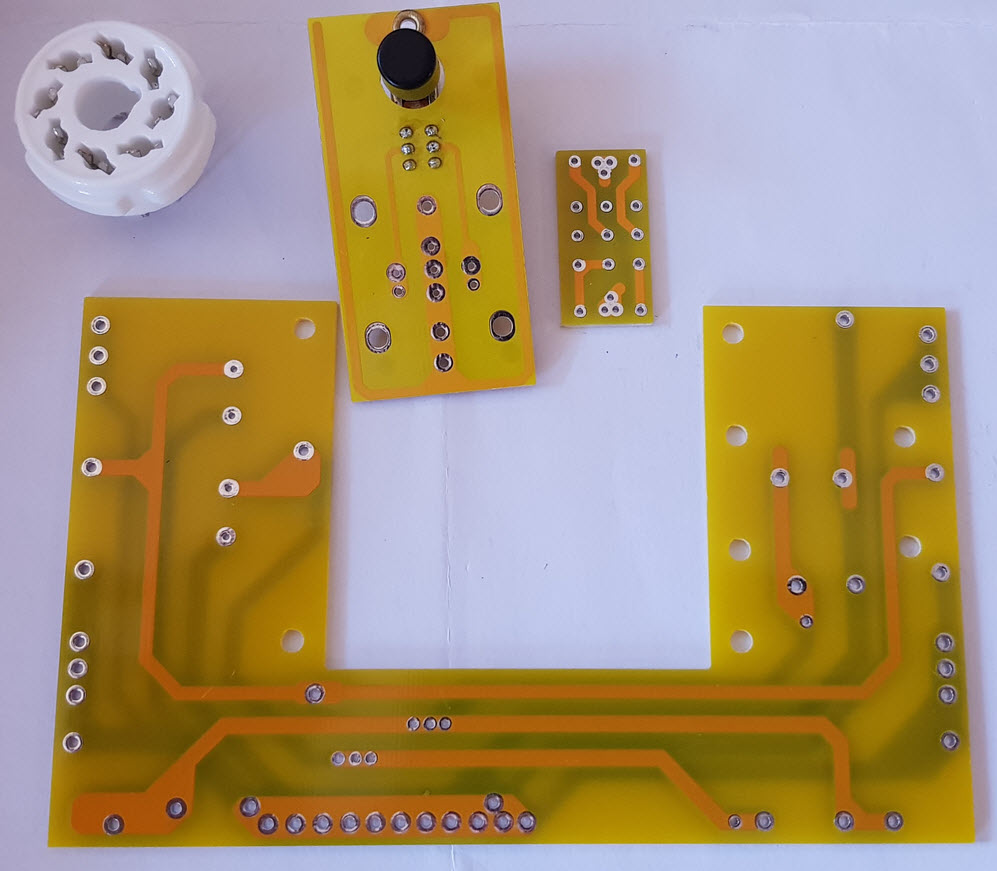

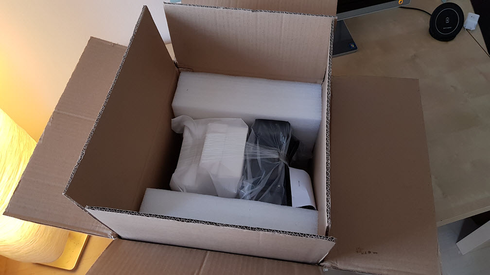

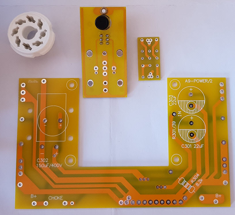

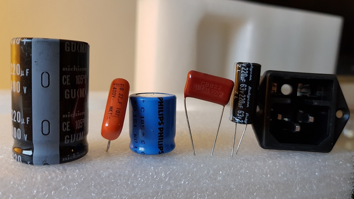

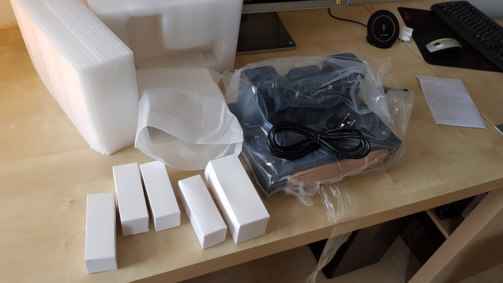

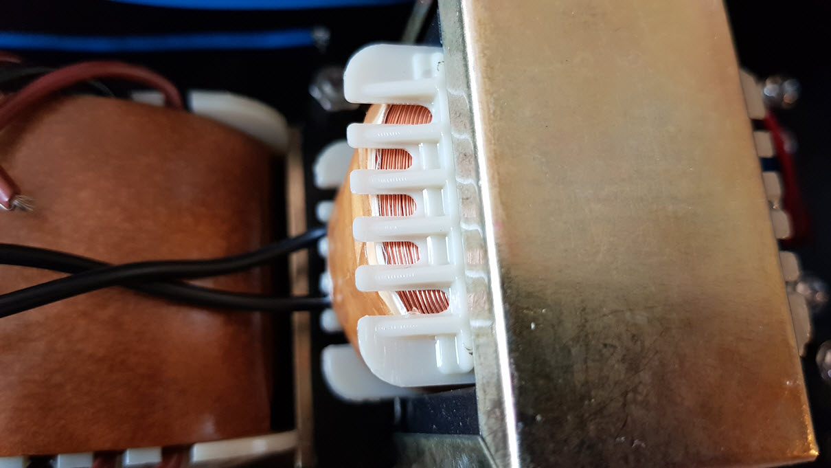

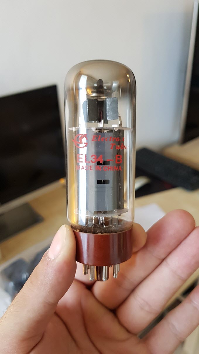

Hi guys,
I just received my A9 and because it is a little bit (but essentially) different from what you have discussed up to now, I decided to share some photos and impressions with you.
I bought the unit from ebay.com, it was labeled "EL34 Vacumm Tube Amplifier Single-ended Class A HiFi Stereo Amp DIY KIT 12W+12W" from doukmall. It is advertised as a "2017 design" + lots of nice words about the quality of the materials
My item was shipped from Germany. It arrived really fast (just a couple of days), but even this doesn't make the $89 shipping sweater for a $195 item 😀
So what you can see on the pictures actually proves that they have improved the package substantially. The packaging is great - two boxes together, it sustained being delivered to me upside-down and who knows what else.
Notice that there is a change in the schematic written with a pen for R103 and R203. There are other differences also, which are not written on the schematic - all caps are high quality ones - from Philips, Nichicon and Rubycon, the big cap is now 220uF. I plan to build the amplifier with the original circuit and after listening to it to improve this and that. Reading this post I was left with the impression that I'll have to recap the unit entirely, so I bought all the caps + the stuff for the "improvements" that I identified at first look on the schematic here before receiving my package. Now I changed my mind and I'll improve things after listening to the original sound 🙂
Things will happen in the next month or two and I'll keep track of the progress here. 😉

Hi hego,
today I found that the local electrical shop has many NOS tubes in their warehouse. I bought 2 russian 6Н9С for $4. Тhey promised they'll check further for 6Н2П, because they actually found the lable on the floor, but not where it belonged to 🙂
So, could you please share your prefered schematic for the mu follower and the SRPP with these tubes?
Don´t complicate the things.The 6n2p (6ax7) is the noval versión of the octal 6n9s (6sl7).Must mod the base.You can try first with the octal versión.(6n9s)
For a SRPP exemple see #22 of this thread.
When we work with a srpp, cascode or mu-folower, is important the point B3 of schema. Is the voltage reference between catode/filament.The catode of the up triode is near at the anode of the low one.Avoid short filament/catode about 100V DC max.
An other interesant mod is the use of a courrent sink in the catode of EL34.The cheap LM317 or LM783 IC do the job. You can set easy the disipation of the pentode with a help of a tinny resistor.
1.25V/resistor= catode courrent and this corrent X voltage of the tube = dispation . 25W is the maximal for EL34 and similars.
See this thick in the A10 cousin amplifier at #44 (50mA here) on bottom link
Boyuu hifi Equis A10 EL34B+6N2 SE Tube Amplifier with 5Z4P rectifier: review and mod
Cheers
Cheers
Thanks!
The different preamp tubes I'm buying only to compare the sound subjectively. There are adapters on ebay for 8 to 9 pin double triodes, so it's not a big deal. Also... the price on which I found them is a bargain 🙂
Thanks for reminding me of the filament to cathode voltage. I have that in mind for the mu-follower.
Interestingly - the Shuguang's EL34B has a 30W plate dissipation limit, most probably I'll try to hit that 🙂
