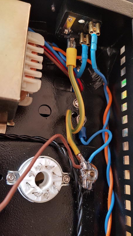

Here are the components that left without an electrical connection to grounding (and inbetween themselves) after I connected the grounding pin to one of the 4 screws on the plate carrying the tubes:
- power transformer body (!!!);
- choke;
- chassis;
- OPTs and their steel housing.
I could actually measure electrical connection only between 2 of the metal holders of the tube sockets, everything else remained from the chassis remained isolated. Now I'm destroying the paint here and there in order to connect the different components to ground.

Why should all the iron's be "connected" to the chassis, since the chassis should not really be used for ground in any case...

my other equipment has grounded chassis (my PC for instance), I don't want potential differences on the RCA input, so the schematic's ground is connected to the chassis.
I really hope that you are not OK to have high voltage appliance with metal body whose different human accessible parts are not grounded and not connected between themselves, making it possible to have potential differences between them of hundreds of volts.

Yes, it should only occur at a single point. It's usually not a good idea to use the chassis for the common ground connection.so the schematic's ground is connected to the chassis.
Well, it's now 2-point centered. One very ugly place which gathers all wires connecting the different chassis parts to ground which is connected to the single schematic ground on the board.
Still, the body of the power transformer is isolated, once finished I'll check if it needs to.
I once had an output transformer that had a short from the primary to the transformer frame.
That is a real good reason to have the frame grounded, unless you like to be shocked.
The same goes for the output taps. Ground the common tap, so if there is a primary to secondary short, you will not be shocked.

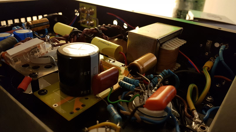

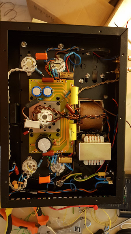

Well, I finished it. Sounds really nice, I am quite impressed actually with the amazingly low level of noise that I achieved and with the output power. I am impressed. My 2x75W 6 Ohm speakers from my Panasonic mini system are quite loud with this amp.
Here's what I "improved":
- connecting what I could from the different metal parts to ground;
- on the pictures the 2 yellow capacitors (jb JFGC 2.2uF 400V) are parallel to C302, connected closest to the OPT input points;
- the 2 red capacitors are 1uF, 400V parallel to C303, connected closest to R103, R203;
- C302 is replaced with a fat short cap, Panasonic HB 180uF, 400V height 30mm, diameter 30 mm. Fits perfectly, any other size would be too much for the space. This is not produced anymore from Panasonic, but there are higher capacitancies from other good brands. You just need to make the snap-in legs thinner, it's kind of tricky.
- EL34's g3-s are connected to ground (just a habit, I prefer ground instead of cathode). One side of the heater is connected to ground;

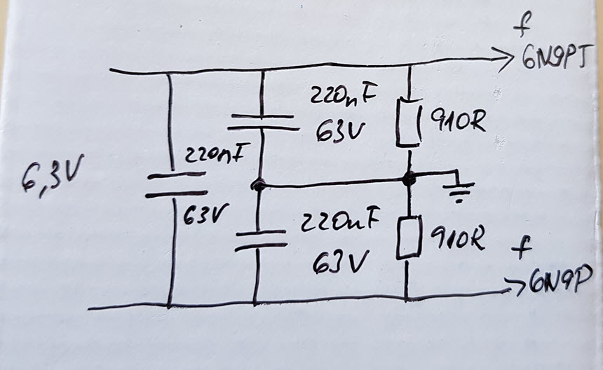

- preamps' heaters are connected with a mid point with stuff I had around, take a look at the schematic;
- C103, C203 are replaced with audio caps, 330uF 63V. I just already had them...
- parallel to R104, R204 I put 100uF, 25V audio caps;
- added 0.5A fuse in the cathode circuit of the diode and a beefy 4uf non polar motor cap to handle the current in case of a short from filament to anode;
- after a few hours of listening and some measurements, I removed R301. I hear no ripple whatsoever so just dissipating some heat is not justified. Hopefully the diode will handle 38uF directly connected to it easily.

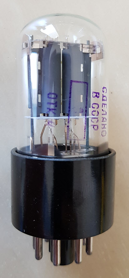

- the Russian 6Н9С that I bought produce really nice, somewhat better, "stronger" sound than the 6N9PJ.

Oh, and I forgot the grid stopper resistors - 4x 3.3K and one 680K bleeding resistor. I just couldn't resist the temptation to put this МЛТ-1 stamped with year 83 inside next to the tubes with a date stamp III 77 which were used for the first time 40 years later 🙂

If you want to be compliant with the safety requirements EN60055, the capacitor C304 between the mains switch contacts must be X2 rated (with the CE logo stamped on it), and there should be a guaranteed minimum distance between the electrical connections on the primary side of the transformer and all the other components and wires. You may secure the wire that goes to the power switch to the chassis with glue or fasteners, and/or use a conductor with double insulation.
I believe that R301 has been put there to lower the peak current in the transformer winding, and therefore the transformer temperature. You may check the temperature after a few hours. What values you used for R103 and R104 (preamp anode and cathode)? What is the voltage at B1 (after the choke)?

Hi pcan,
you're right - I have forgotten that this resistor could be there just for this particular reason. The transformer gets pretty hot, but I cannot tell any difference with or without R301. Without R301 the voltage after the choke is 328V with R301 - it's 324V so I restored it back in place.
I ended up using the values from the schematic - 2k for R104 and 100k for R103. I couldn't "hear" any difference with 1.5k for R104 and 68K for R103 (with all 4 combinations with the original values) - probably it only changed the position of the volume control before the beginning of the clipping.
The added capacitor in parallel to R104 changes things *a lot*. The amplification is really boosted and the bass becomes somewhat exaggerated - the lack of feedback becomes too obvious. I might end up dividing R104 to 2 resistors - 1k in parallel with a cap and these 2 in series with 910 Ohms to lower the effect of just omitting the cap. But this will only happen if better loudspeakers like Klipsch R-28Fs prove it is necessary. I really enjoy the newly discovered dynamic in some of the recordings I believed I knew in absolute detail.
When it comes to the voltages of the cathodes of the 4 lamps - in my terms for accuracy they are disastrous, but I guess it's OK with tubes 🙂 The 2 channels sound really equal to me. Given that R104/R204 are almost identical at 1970 and 1973 measured ohms one channel has 2.3V on the cathode, the other 2.17V with the 6N9PJ-s. The cathodes of the EL34s are 21.5 and 22.9 volts respectively (the resistance is again equal around 493 ohms of the paralleled R107, R108 and R207, R208).
I observe something unexpected with these tubes. They ring ... I mean you can hear the big tubes ringing physically when the input is silence. Sometimes I believe I can hear this through the loudspeakers with more metal sounds. Has anyone of you ever experienced something similar? I have never heard something like this mentioned somewhere...
All in all, I would conclude that I have a really fresh and crispy sound that I really enjoy and makes everything sound nice. The specific depth and ambient of everything that sounds through tubes is definitely there... I actually hear difference in the sound after 30+ hours of listening - it became less pinchy and more balanced. Maybe this thing with "breaking in" the tubes, caps and so on is a real process - all the tubes that I have listened to (and they are many) were all old devices so this is new for me. Something definitely happened to the sound and I like it more and more.
