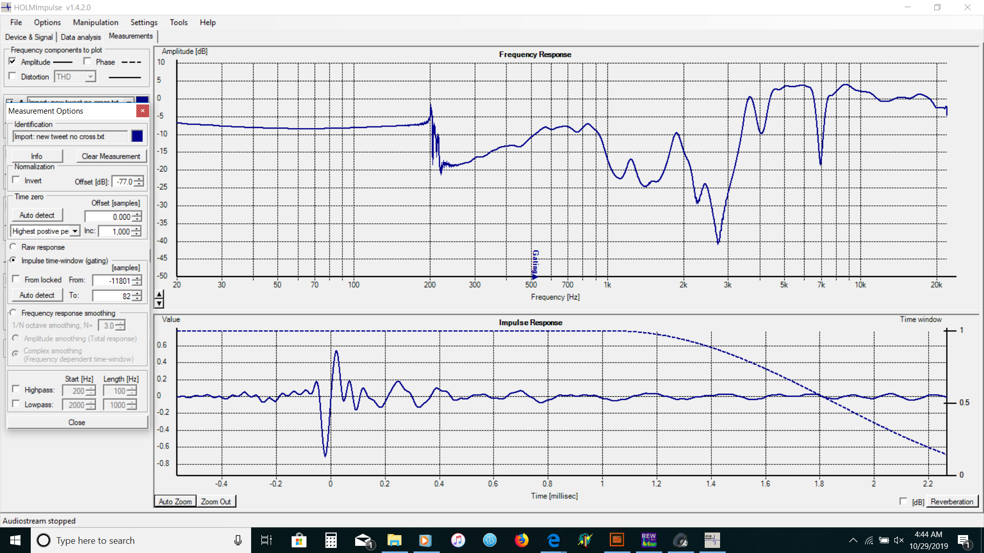

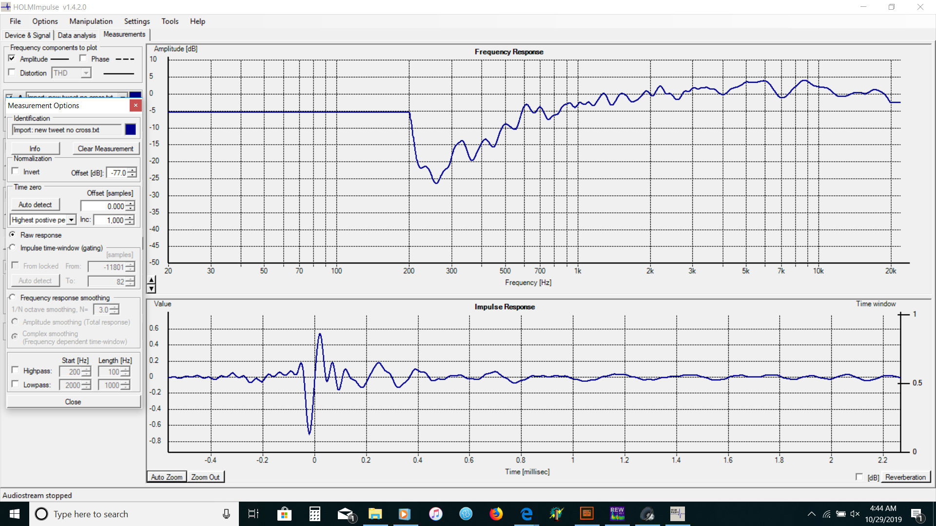

thank you AllenB I spent a considerable amount of time adding the resistors and caps back in and ended up with them out again. I ran the tweeter again without the crossover trying to match the chart you attached earlier. When not gated the FR is close when gated it is quite a bit different. I also tried using the REW sweep and recording it in holms but I don't think Holms can tell the frequency without sending the signal. I should have an adaptor by Friday so can use holms after that. I also tried running with one woofer but that would require more changes to the crossover. The overall FR is not too bad the tweeter has that weird hump from 2k to 6k then starts to roll off. what I do not understand is the tweeter, crossover and cabinet did not change other than to removing the two resistors and the cap but putting them back in did not help. With the other mag drivers the tweeter was virtually flat and rising above 10k how can changing the woofers change the tweeter so much?
I can see how it appears this way, but you could be looking at a strong nearby reflection. With more reflections this will appear to average out which may explain why the raw response looks smoother. Your impulse also shows several artifacts above around 5kHz whose source is not clear. Best wait until you get everything set up.I don't think Holms can tell the frequency without sending the signal.

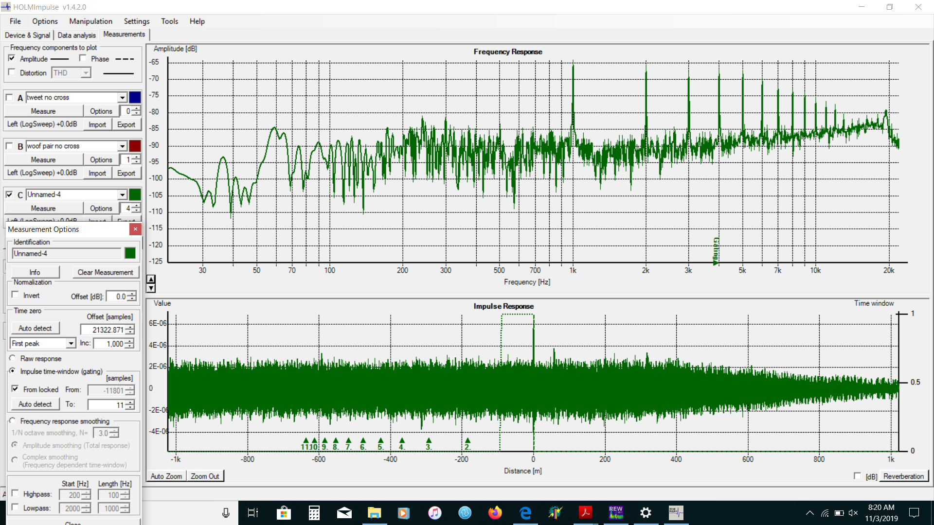

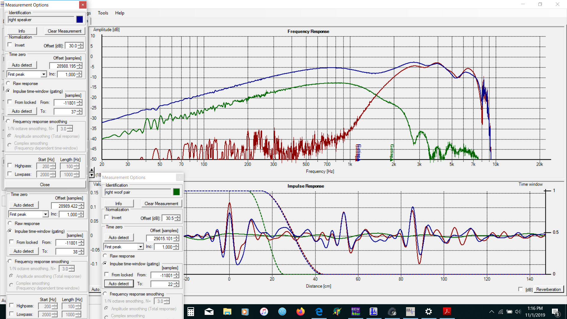

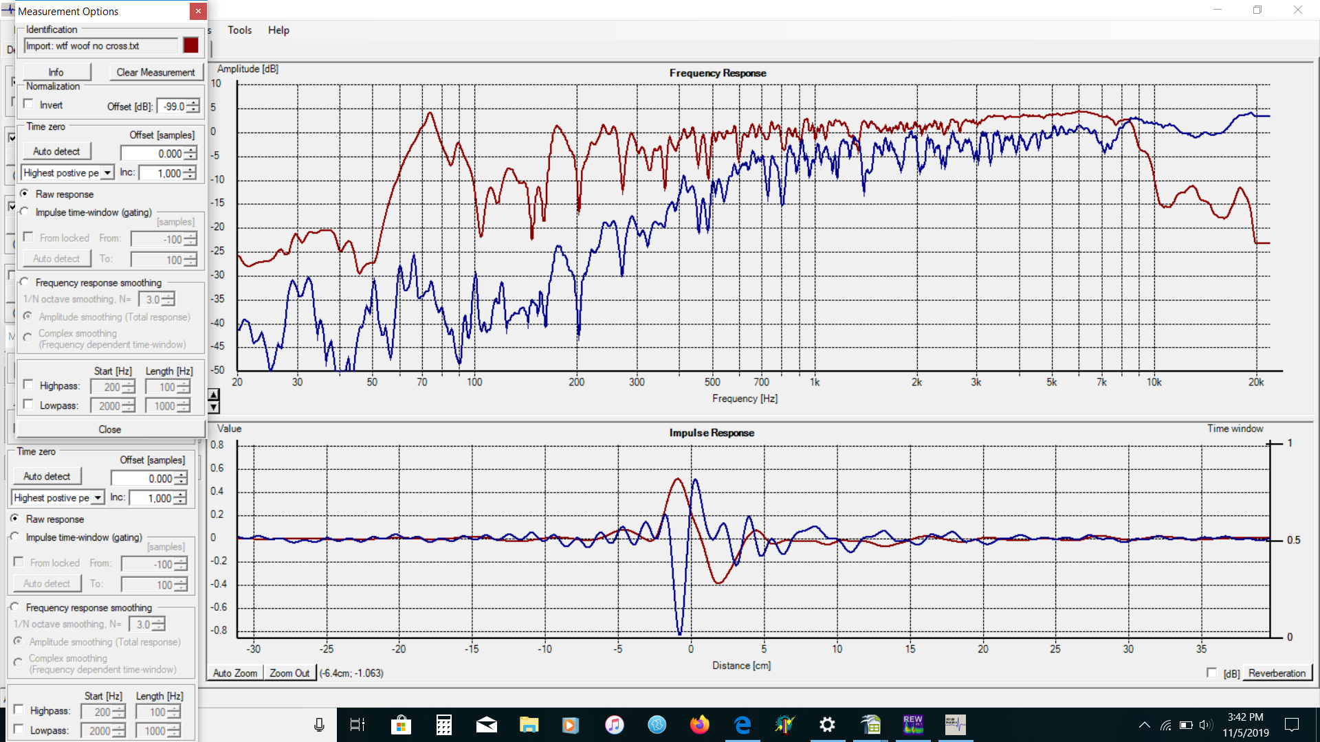

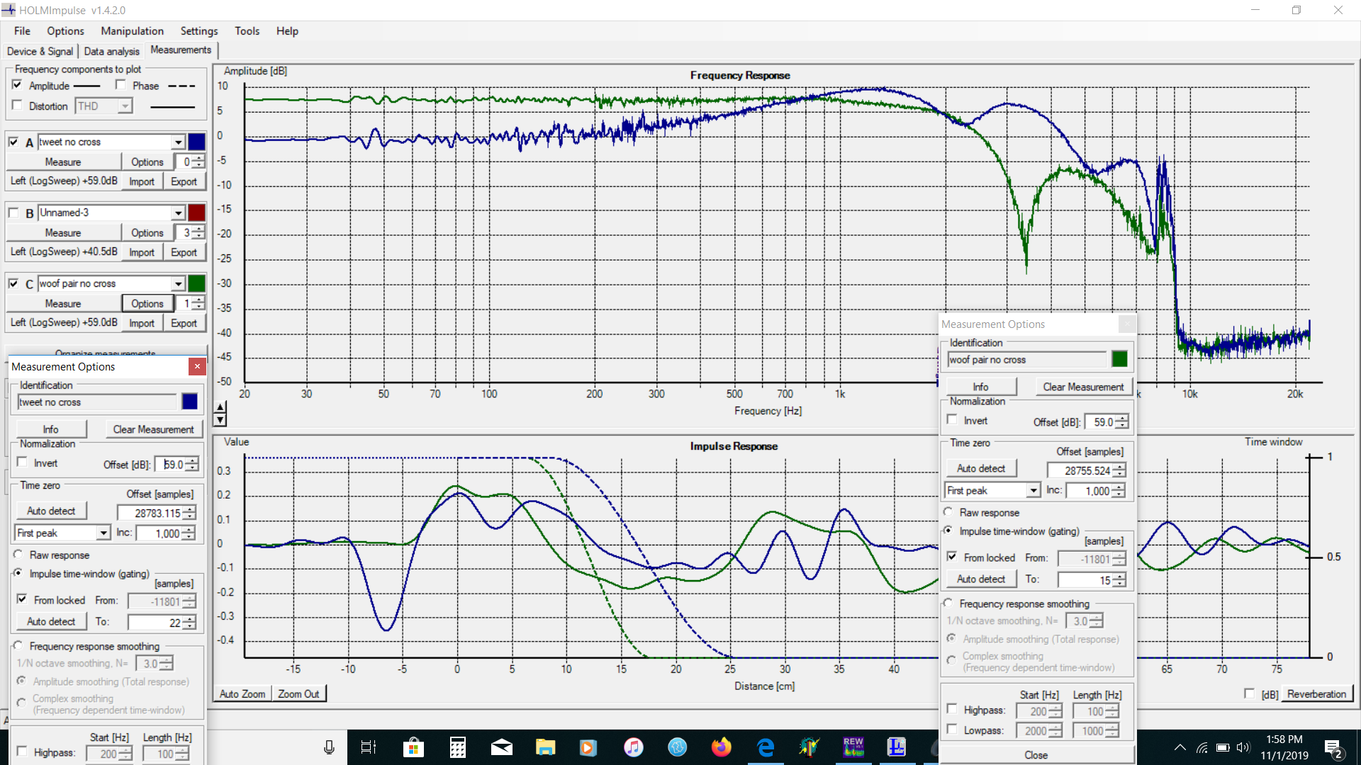

I got the device to measure with holms. here is the chart showing the speaker. the woofer pair and the tweeter. all with the crossover. The tweeter makes a strange noise at the top of the sweep. and is not getting to 10000. it is happening on both speakers.
The second chart shows the tweeter and woofer pair without crossover. I am very confused. the tweeter is not right it looks a lot like the woofer. they are wired separately so should not be able to interfere with each other.
not sure how to proceed

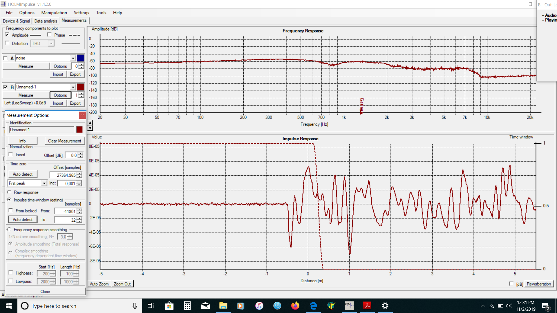

Alright I know it is not the tweeter it has to be the measurement system either the spl meter I am using as a mic or the software or the little adapter card. 2000, 14000, 18000 are all within 6db when run as a sign wave and measured I guess that means the spl meter is ok too.
Your measurements are above 0dB. Take a measurement in silence and see where the noise floor is. You may not need to go so high.
Your measurements are fuzzy. This is due to 'from=-11801'. You can still see through this, though it might help in diagnosing the top end.
You have nearby reflections. I can get around 5-6mS (1.7-2m) of reflection free time when measuring free vertical speakers.
Your gating should be striving to get as much time as possible. Looking at your first screenshot, you have a clear and significant reflection at just above 50cm which would normally set a limit. You have three basic options, you can gate just before this, or you can identify that some other earlier input deserves to be cut and gate accordingly, or you can move the obstruction and try again.

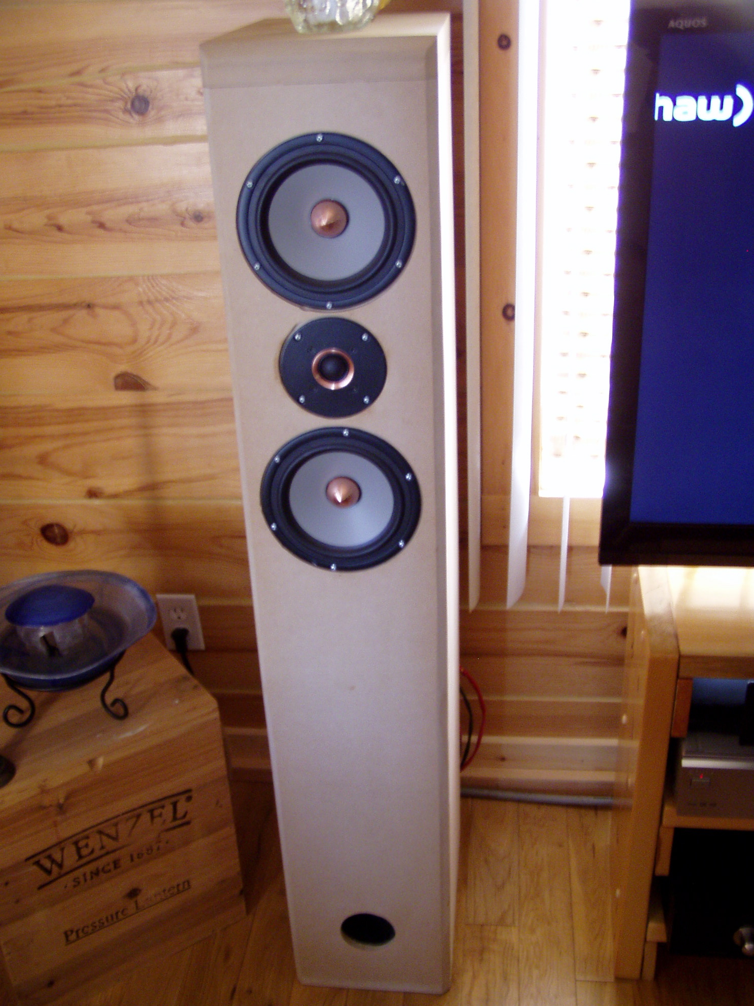

here is a picture from our old house we moved to a house with smaller rooms the current room is 15x13 and 7 ft high basement room the speakers are 9x12.5x49" we now live close to the ocean and solen recommended the Nextel drivers as the mag drivers may corrode again. last night I cranked them up for a short time and they sounded off . i did try to get measurements several times today but they all look pretty much the same. i do not think the tweeter measurement is accurate. when i use a spl meter and just run sine wave at different frequency above 10k I get similar readings to 2k. using the data from REW and running thru xsim it looks like a resistor across L1 on the low side and C2 on the high side may reduce the humps in the 5-8k range and lower the woofers to match the tweeters more closely but I sure would like to have accurate measurements before i start making changes. i am wondering if the usb sound card maybe limiting the range of measurement. thank you again

So you have a system with drivers spanning vertically around 16", but the significant radiating surfaces are mostly within about 13". If you prop the speaker up so the tweeter is 3.5' off the ground in the middle of the room, and the mic at the same height, 1m apart, the ceiling and floor should be the closest things to the speaker from which sound might reflect.
This means your first reflection should be at 4' (120cm) or 3.5mS. You should gate here, you should see the reflection so you aren't doing it blind.

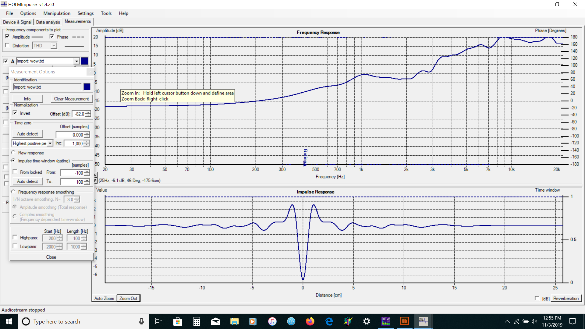

thank you I think you guys are onto something with the windows sound card after trying a variety of hookups and going thru the REW manual this is what I have for a sound card reading it is not pretty. this is a direct cable for headphone jack out to usb in
There is an impulse near 0, the magnitude is zoomed so that noise might look worse than it is. You haven't set your gating times. Maybe switch to smoothing for this one.. and work on the level of the measured impulse.

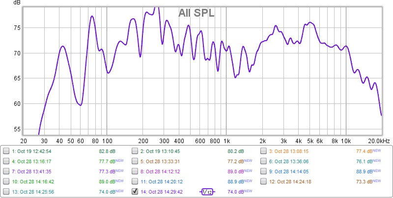

I am still having some issues getting the laptop to work with the sound card. the Mac sound card is considerably better so I used that and REW with the spl meter and the soundcard calibrated. then I dumped the data into Holms and here are the results the speaker is raised up so the speaker is centered in the room. Somehow In the connect and disconnect I must have inverted the tweeter. I will have very limited time to work on it the next couple of weeks. I will run the tweeter and woofer pair separately and keep working on getting the laptop to measure directly into holms. The chart is gated and raw data from the same measurement. I am still not confident in the calibrations and will repeat them. the soundcard cal looks good but the spl cal rolls off 12 db from about 7khz to 20khz and I want to verify that that is correct.

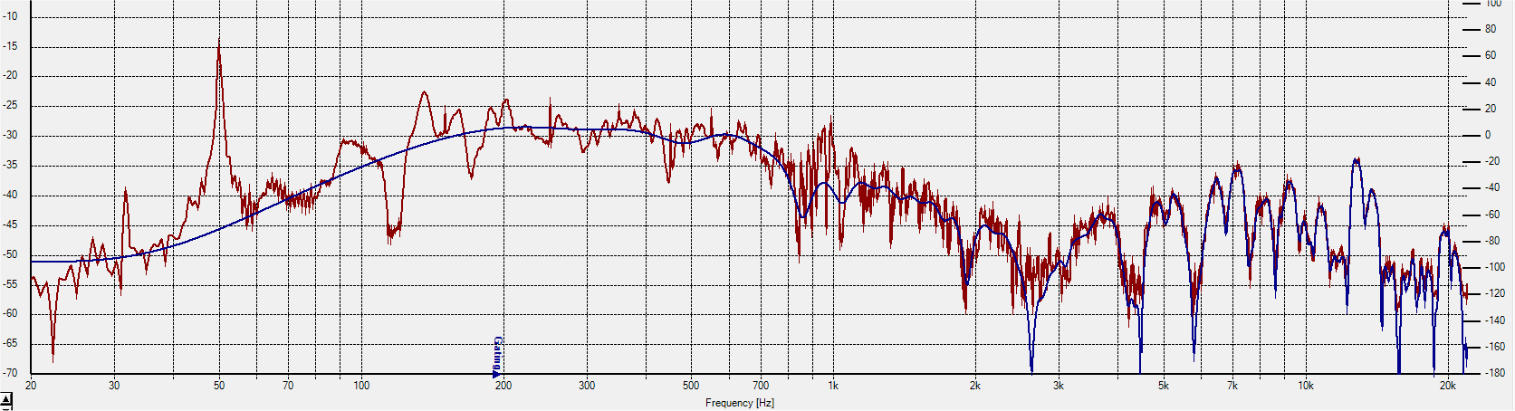

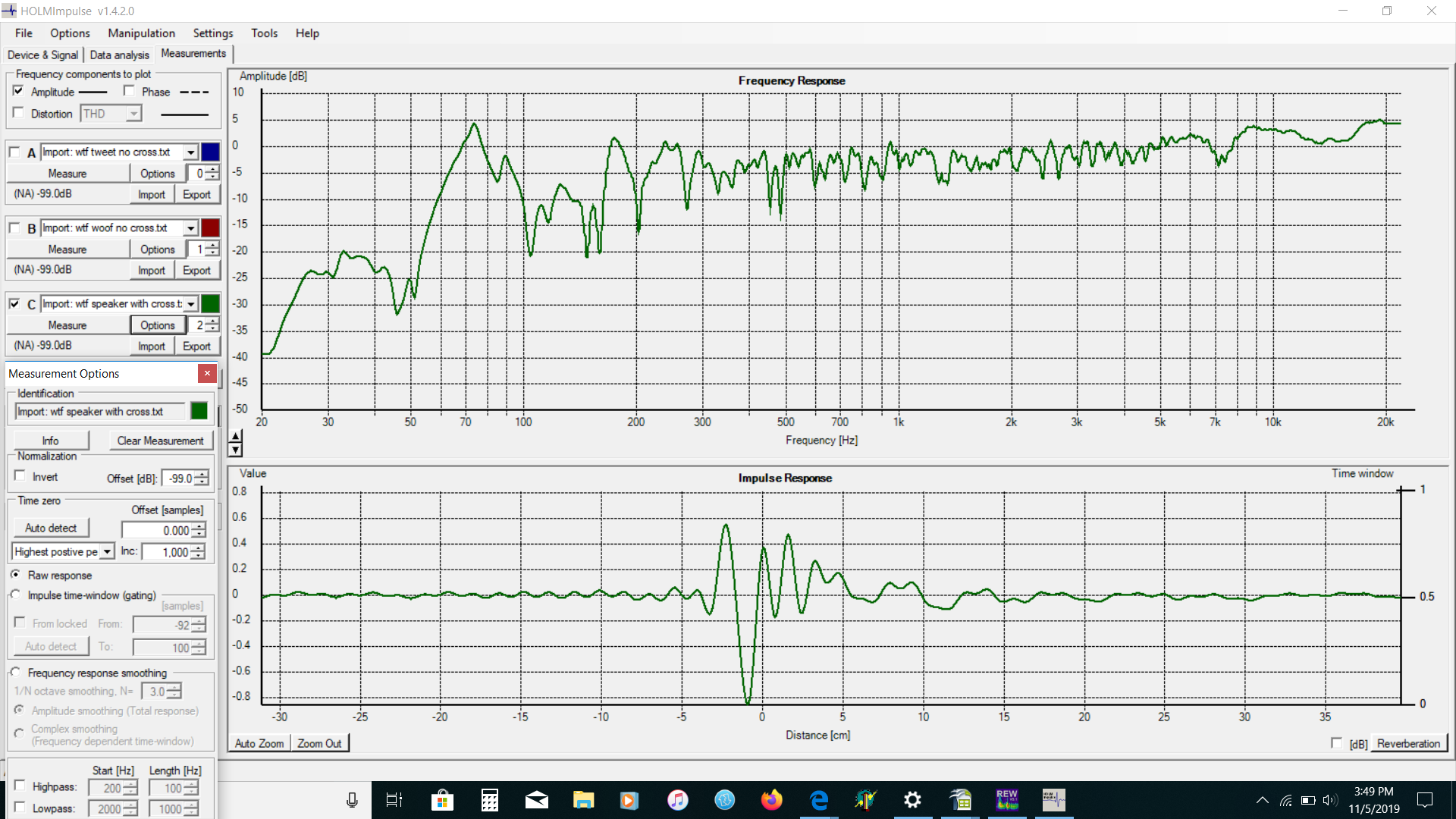

I thought I'd share an example, as you sometimes show the raw response and I think I can see the benefit here.
In this plot, the nulls (comb filtering) in the upper half of the response are an intentional part of the design, so I'd expect the raw and gated results to agree there. The point in fact is that the raw and gated responses are mostly in agreement.
This comes from trying to make the gating redundant by eliminating anything that shouldn't be on the measurement.
You are still verifying the integrity of your system, however looking at your latest makes me wonder. If I saw that variation between the plots I would think there was something happening after the impulse and before the gate and due to the short time difference, it may be box related.

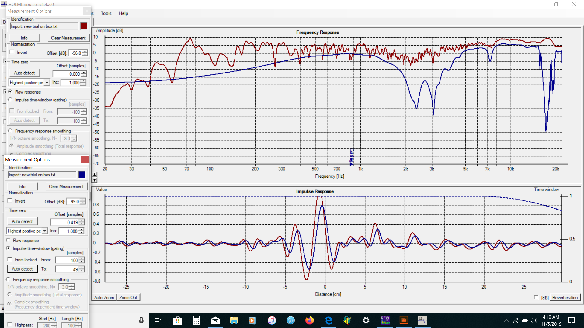

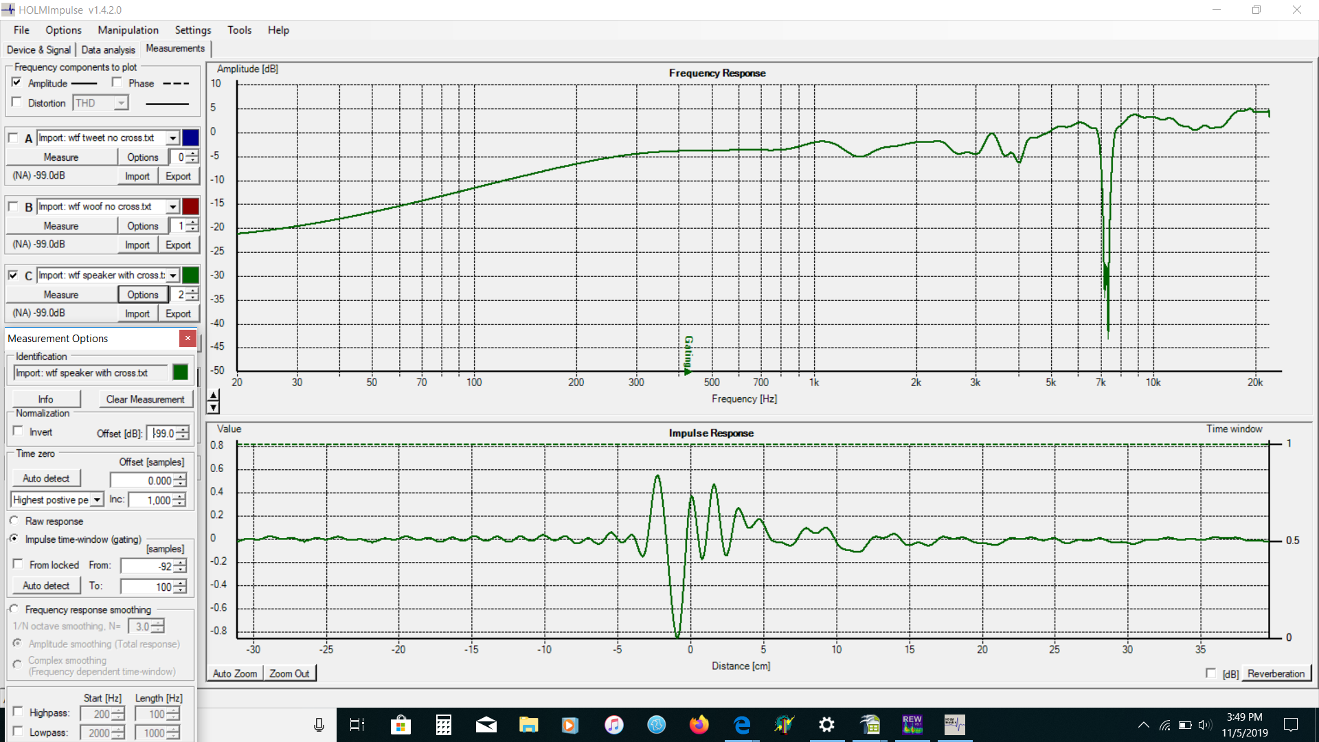

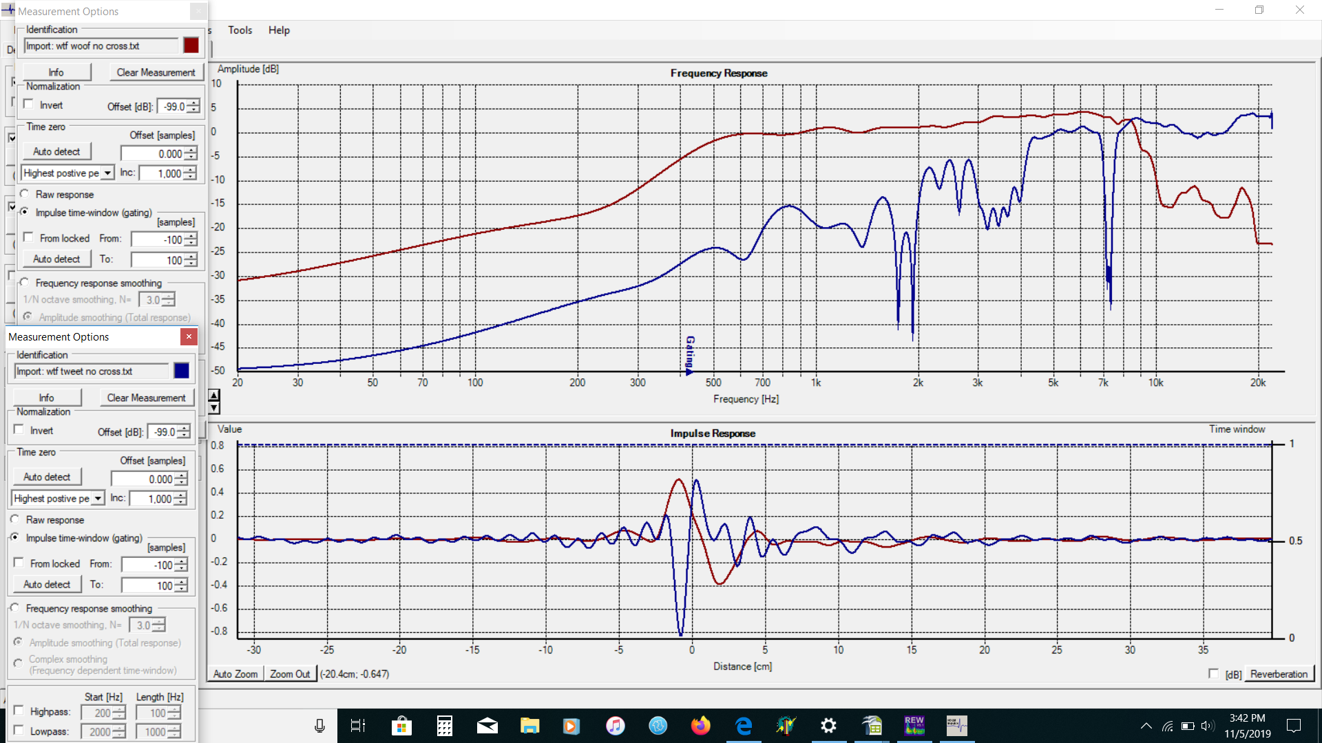

So I think I have the everything calibrated on the mac here is the speaker full with crossover and the woofer and tweeter without crossover gated and raw. I think the next thing to do is to transfer the gated data into xsim and work on a new xover. is that correct? this is on the milk crate so the tweet is about 1/2 the vertical distance. 1 meter
