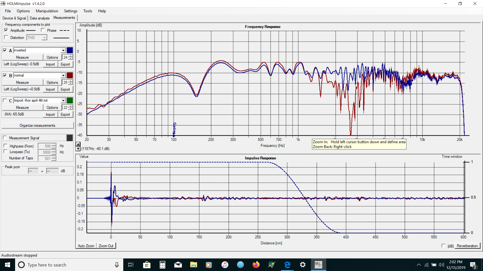

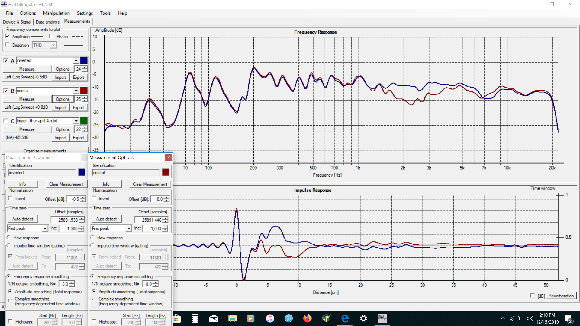

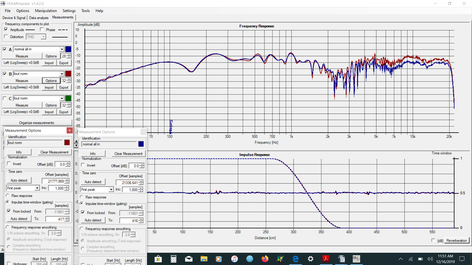

Here are the measurements at 1 meter inverted is the way I normally leave it and normal is with the tweeter with the same +/- as the woofers . the second chart is smoothed and the suckout is less.

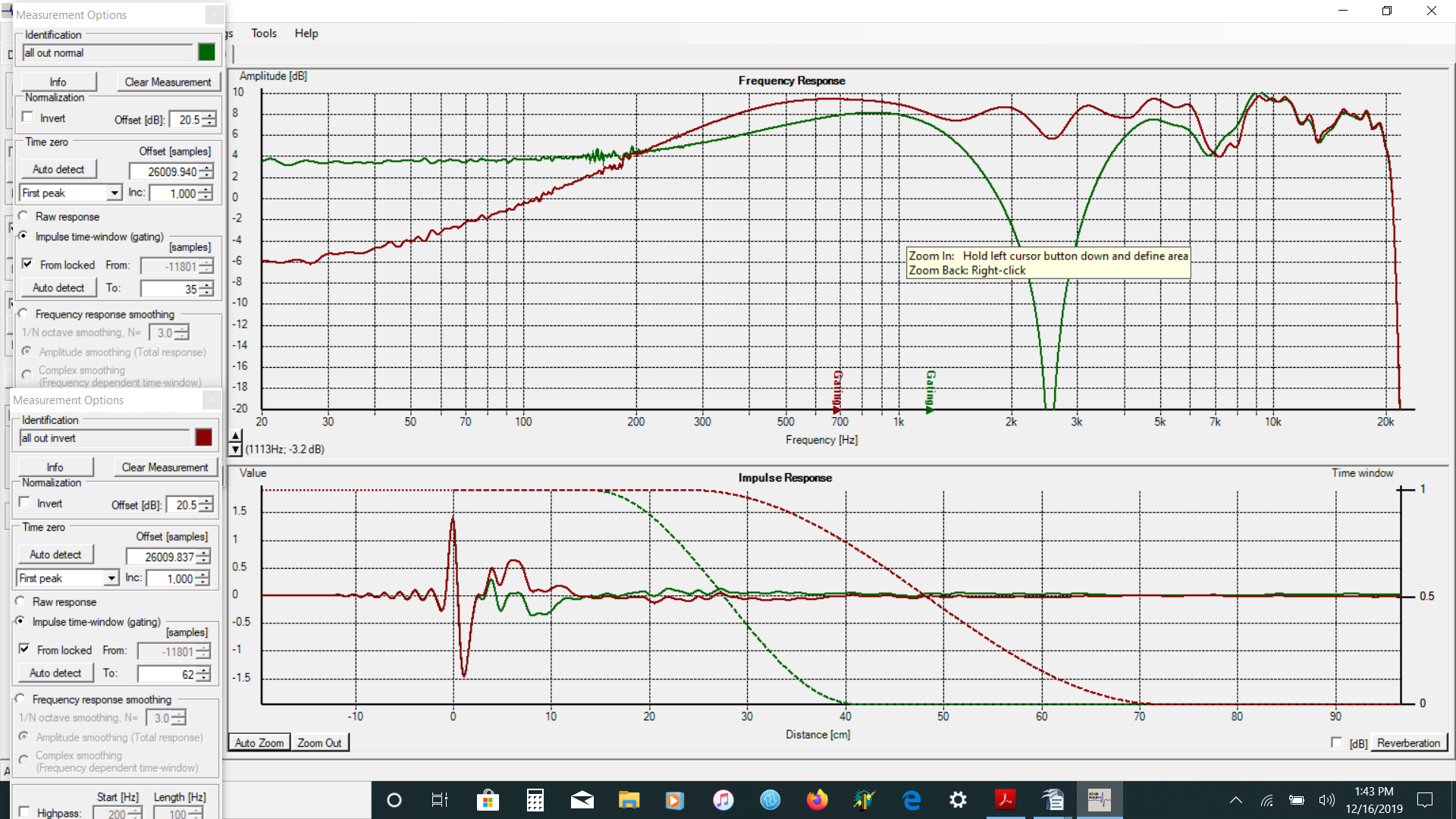

There seems something not computing right in the sim, hence I asked you to perform the mod in post #182. I am confident that you could settle for either of the solutions:
1. R2, R3 and C4 removed
2. R2 removed
3. R3, C4 removed
4. exchange R2 for another value of your preference (1; 1.5; 2; 2.5; 3.3;etc), R3,C4 removed
2. R2 removed
3. R3, C4 removed
thank you Lojzek

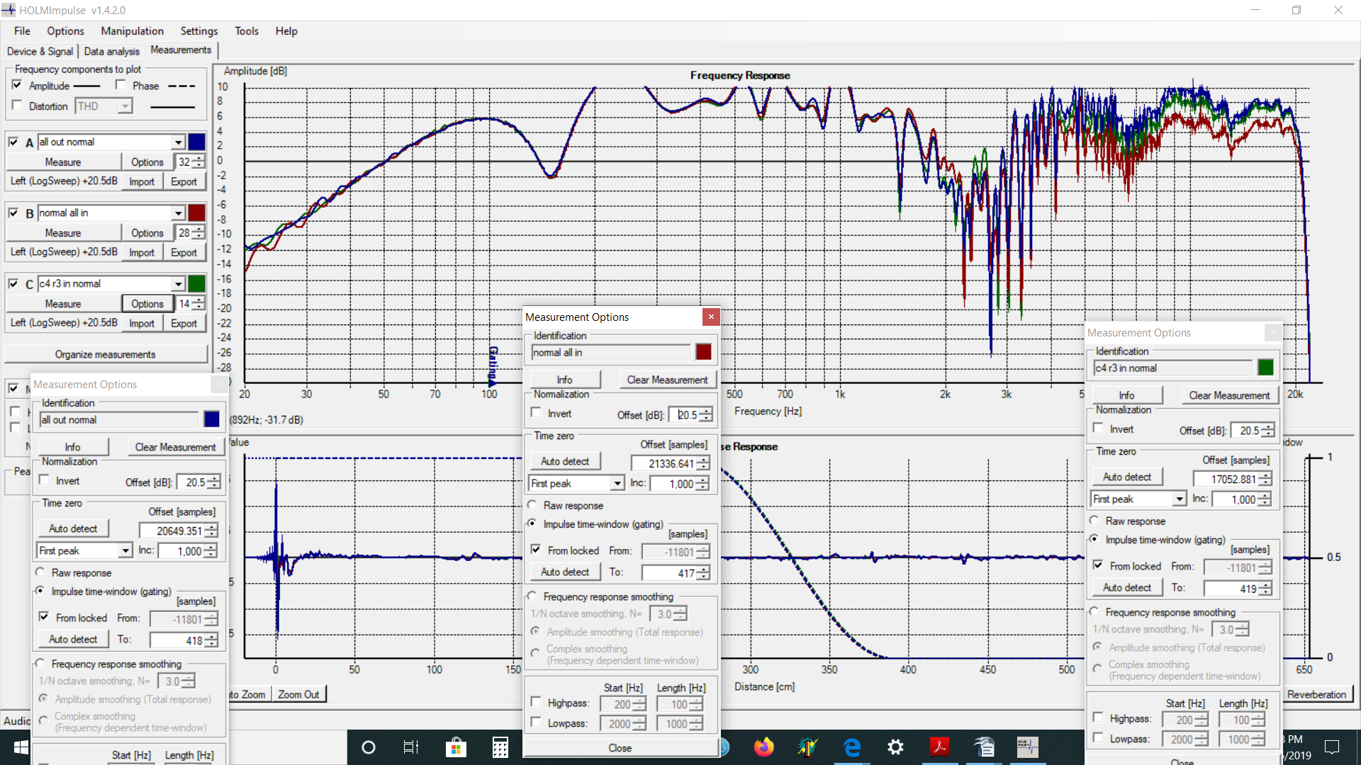

There is something that seems odd for sure. here are the charts with R2, R3 and c4 in and out. I tried running with out R2 and just R3 and C4 but the tweeter did not make any sound. there is only about a 5 db difference and almost no difference in the null I must be doing something incorrect.

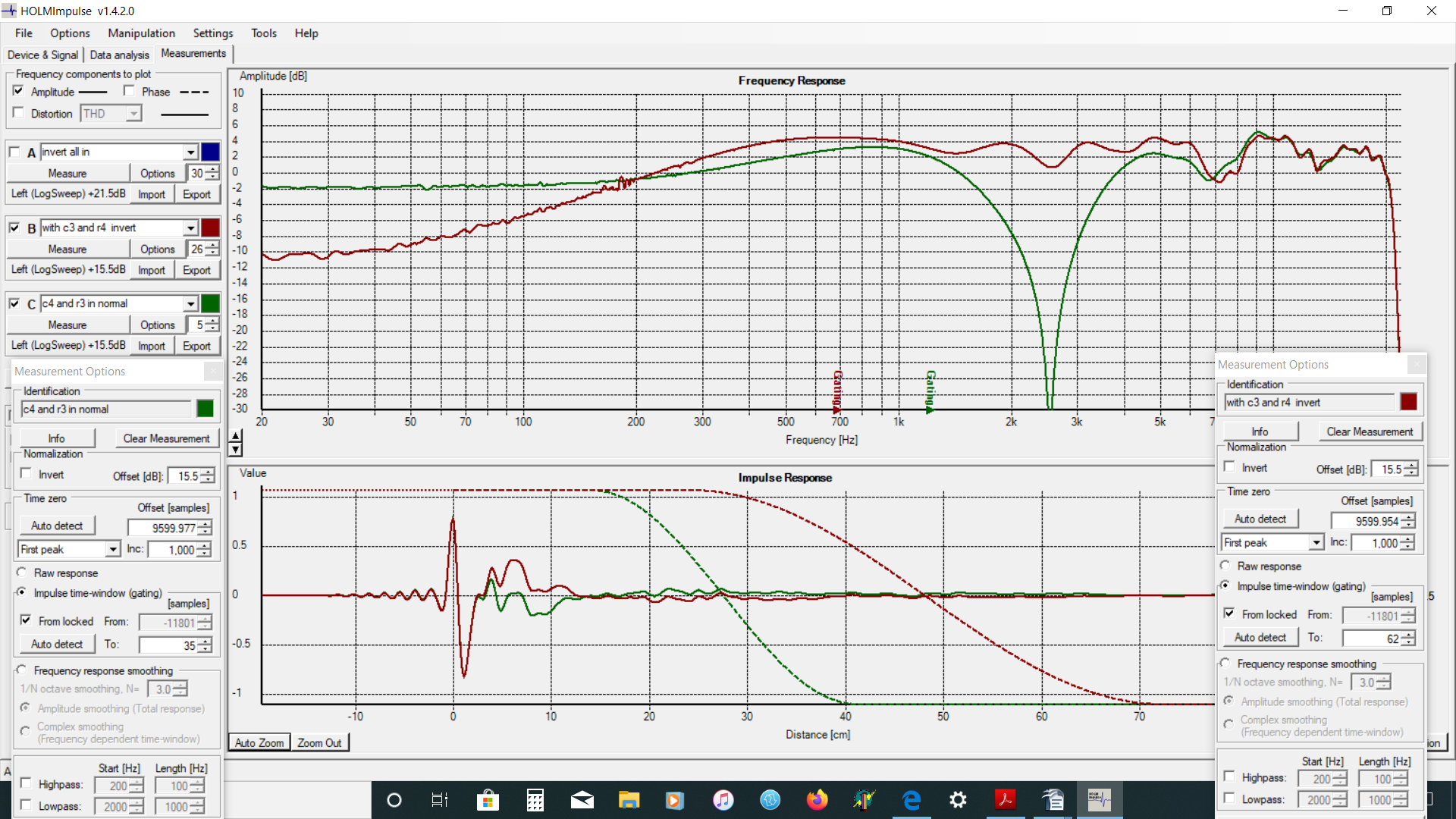

here is the same data allowing holms to set the gating. this is with a straight wire in the place of R2. so R2 C4 and R3 are removed. note that the steps are 2 db the second chart is with C4 and R3 in and r 2 removed

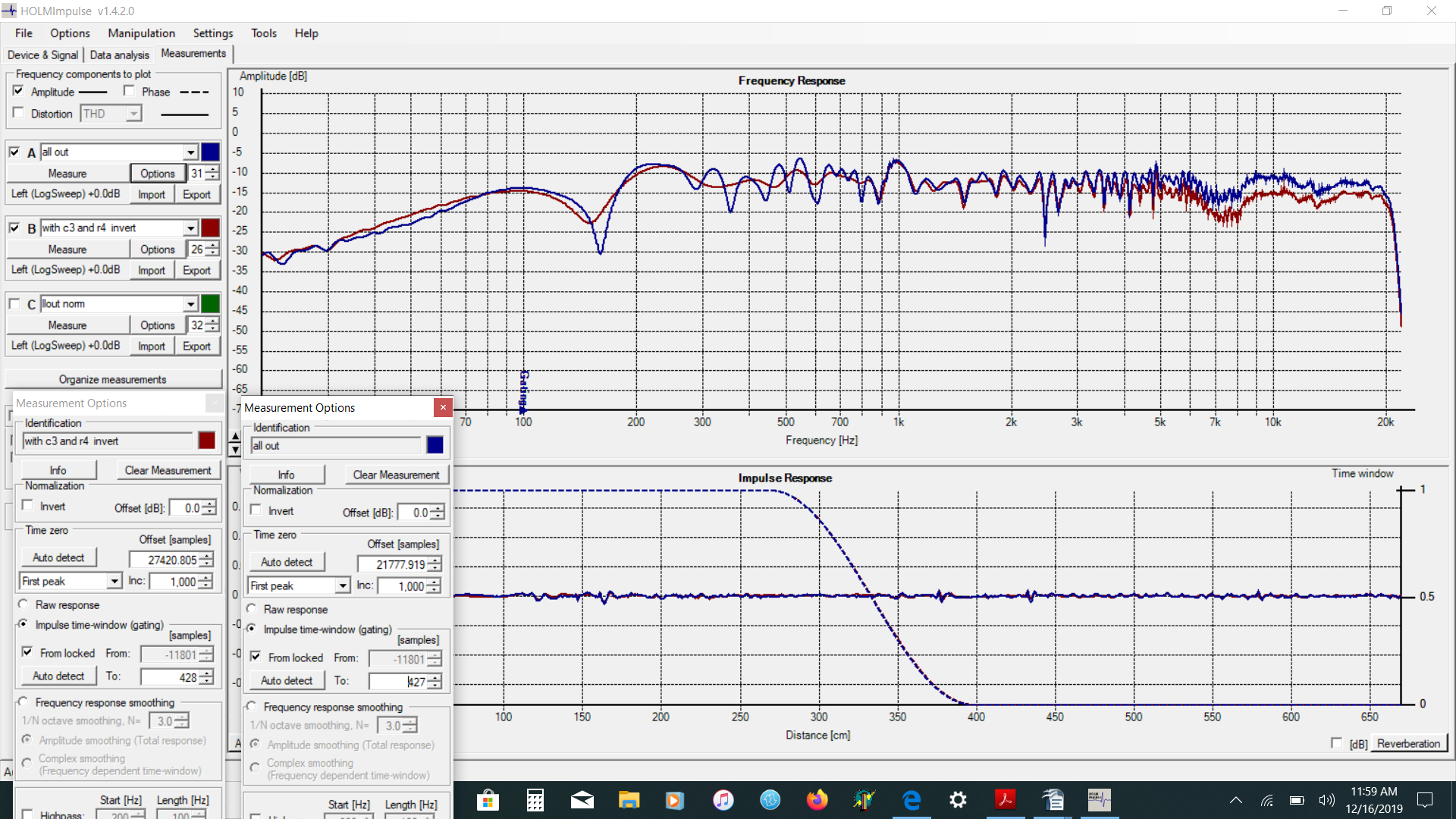

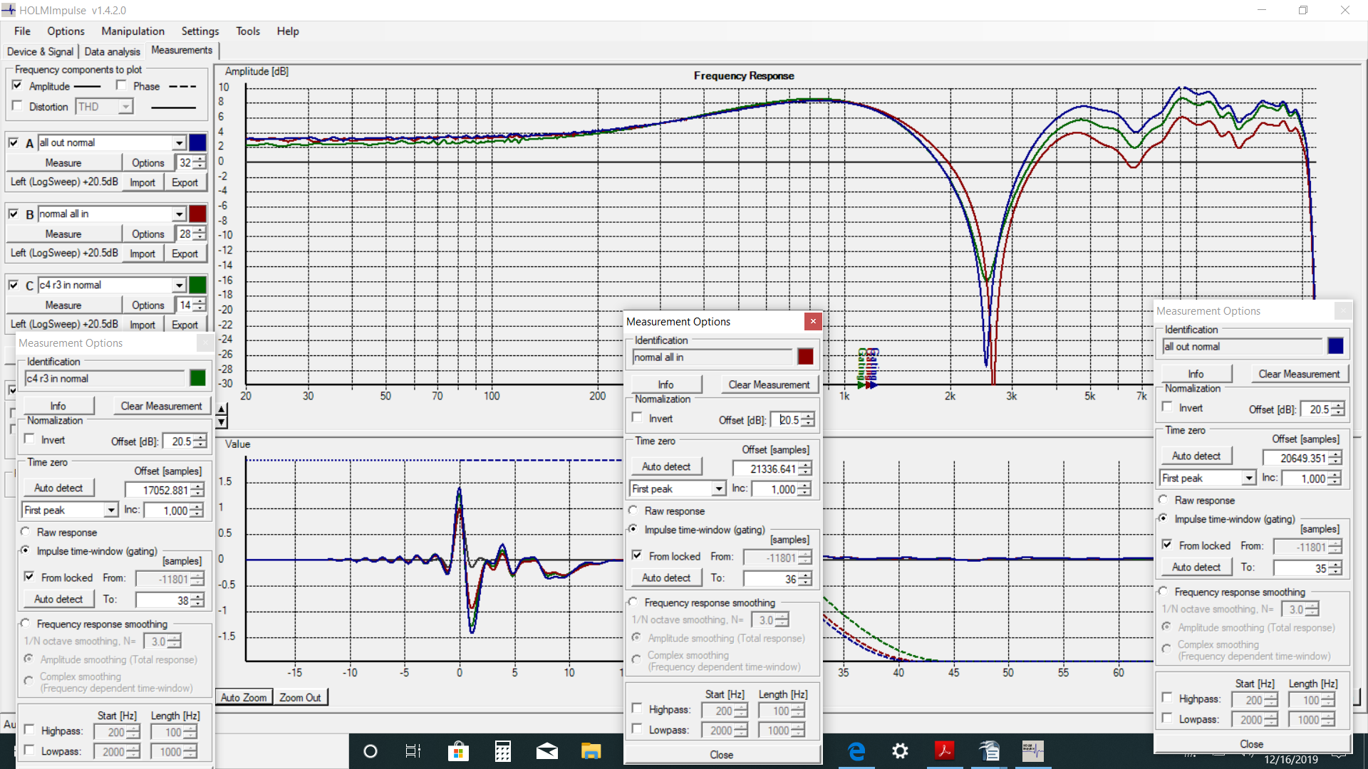

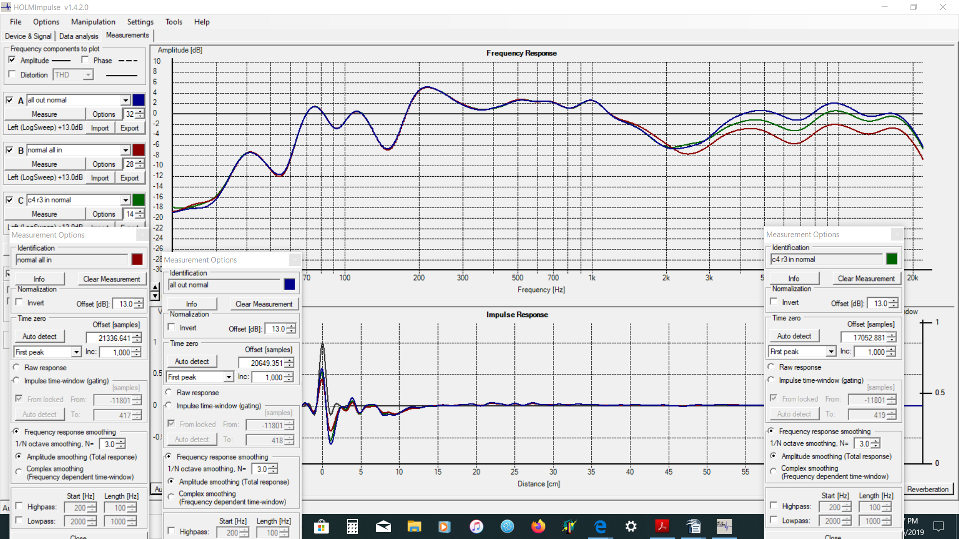

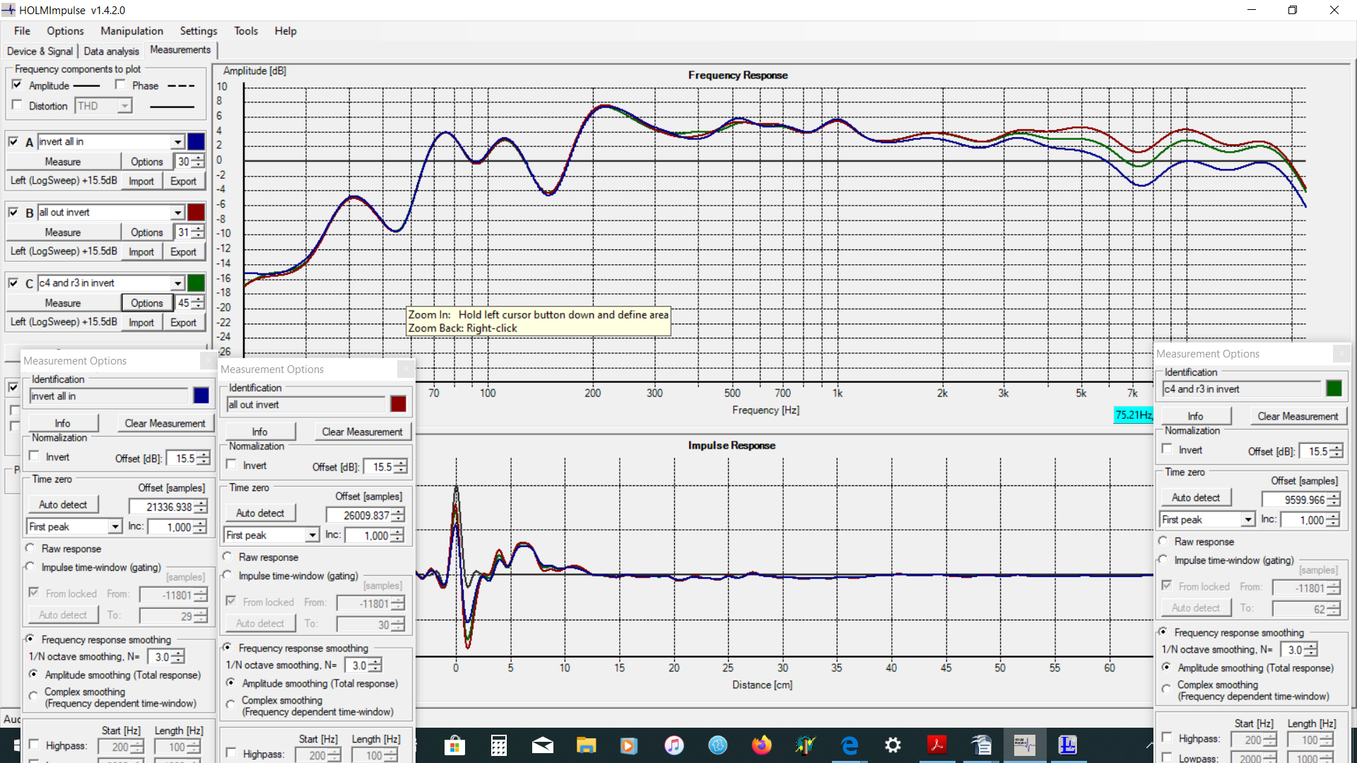

ok here is a little clearer picture. this is all out- all in - and just c4 and r3 in (r2 out) I had to move the gating to get a clear picture. What are we looking for what defines better? I also added the gating at 100 but it is hard to see anything I also wanted to add the data smoothed not the dip at 2k
Ok, now it's clear. The only issue here is to decide which modification will sound better to you. Try listening for awhile with R2 removed, and the rest of the original crossover in place. Then try removing R3,C4 and introduce back R2. If you feel up to further experiment, observe the option 4 of the post #183.
edit: and lower the gating to between 100-400 for observing response. Reverse null is not the issue right now. It could be modified, not without messing with LP filter which is not what you're looking for.
Thank you Lojzek I will listen for awhile I have a 12 gauge wire in place of R2 and c4 and R3 out of the crossover now. This makes sense as the mag are not as sensitive as the nextels. thank you again for your help
Just wanted to thank Allen and Lojzek. I have tried several combinations on the cross over and different configurations on the felt along with changes to the port length and the speakers sound pretty good. the port change helped a little with the bass. and adding a 1cu cap to the 8.2 levels out the upward slope on the upper midrange. the best combination on the tweeter was removing r2 c4 and r3. still a little work to do and I think the cabinets are still too large for these drivers.. Anyway thanks again I do apologize for the poor measurements and taking up your time with the poor measurements through out this process Have a great holiday

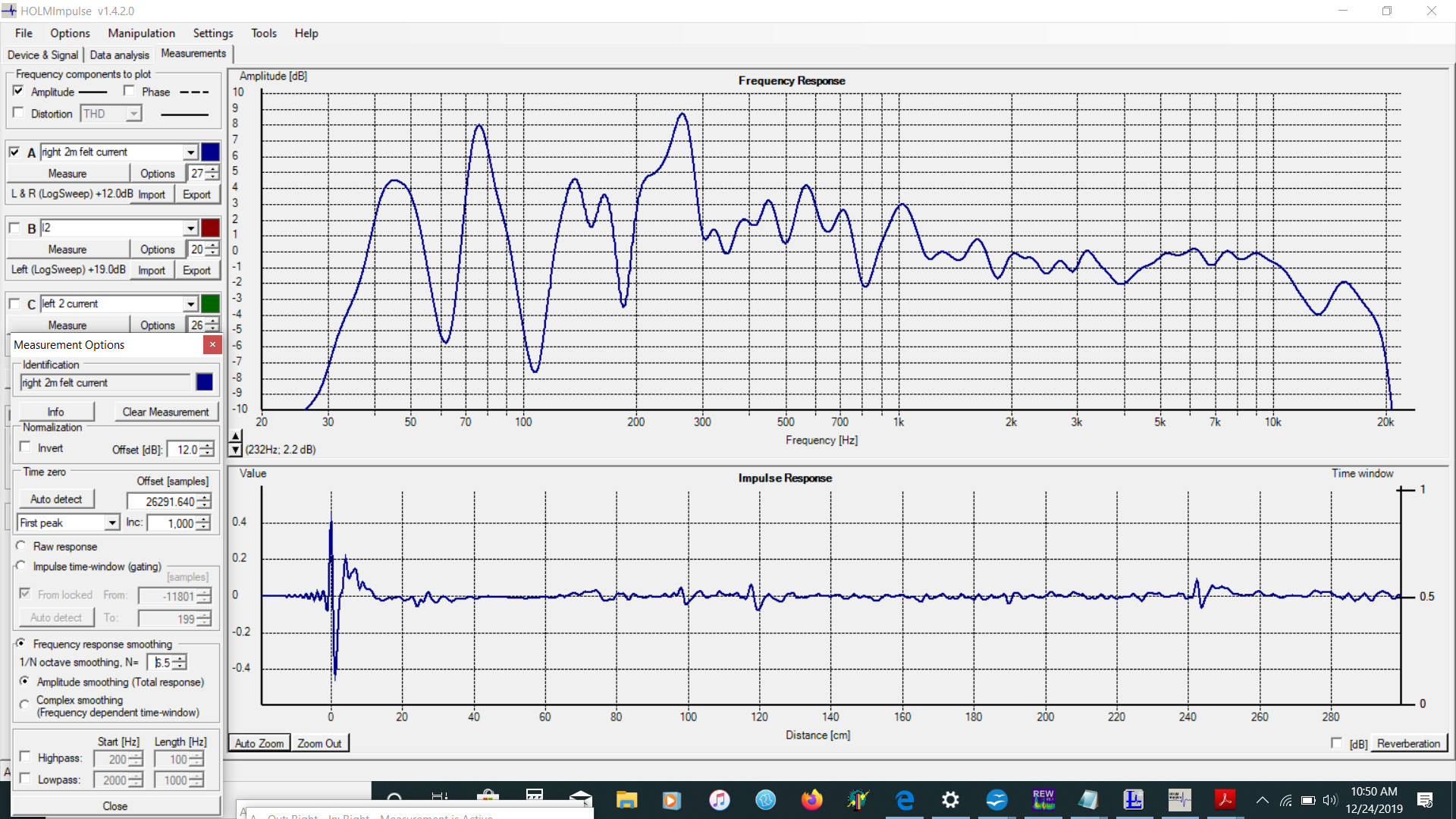

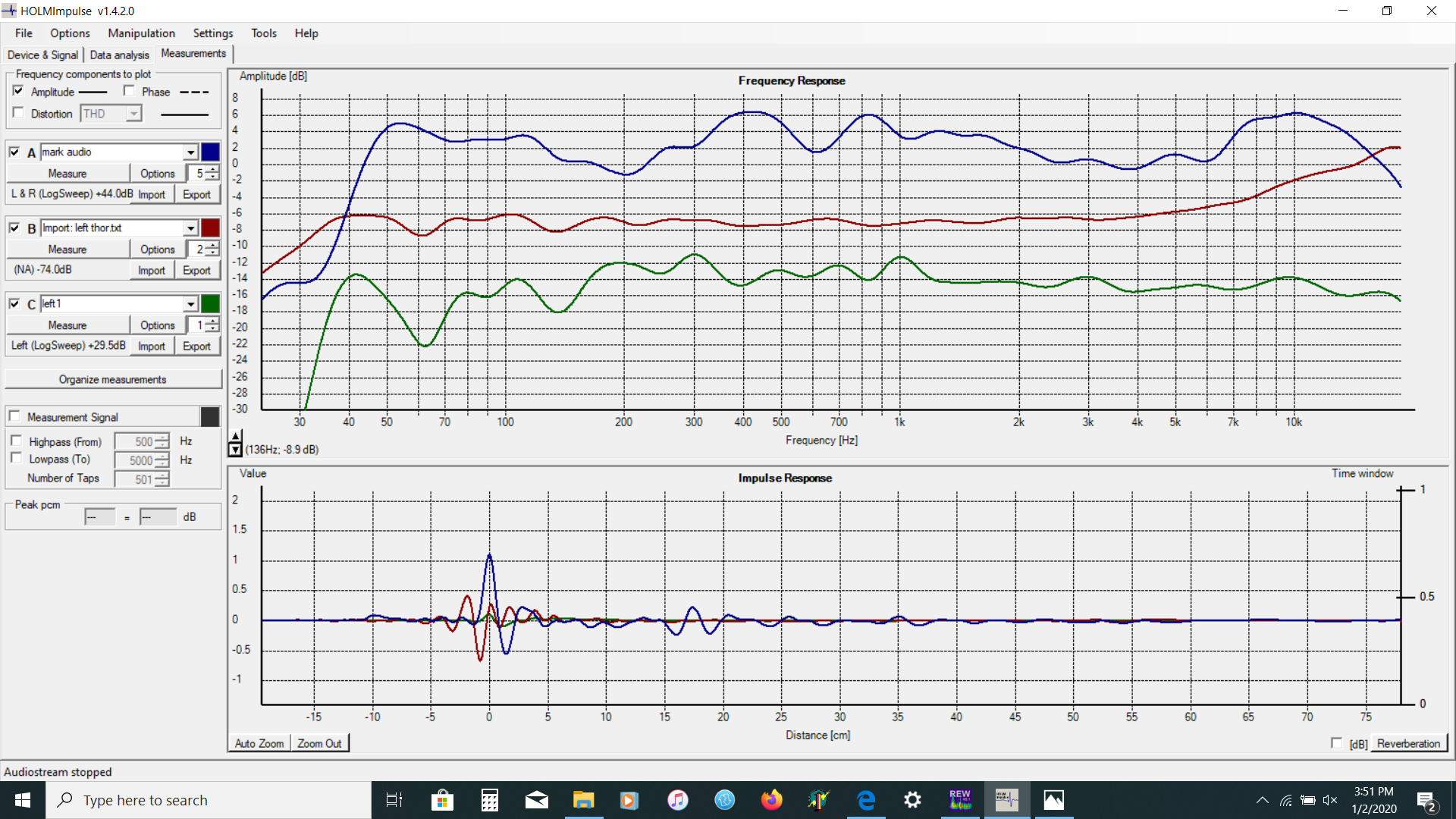

Hi Allen thank you again for all of your help I meant the last post to be funny. I cannot get over the difference the felt makes thank you again for showing me the Holms software. The treble does drop off a little at 2 meters. I worked on the port tuning, felt cut out and speaker position. There is more work to do but here is what I have so far. thank you again and have a great holiday.

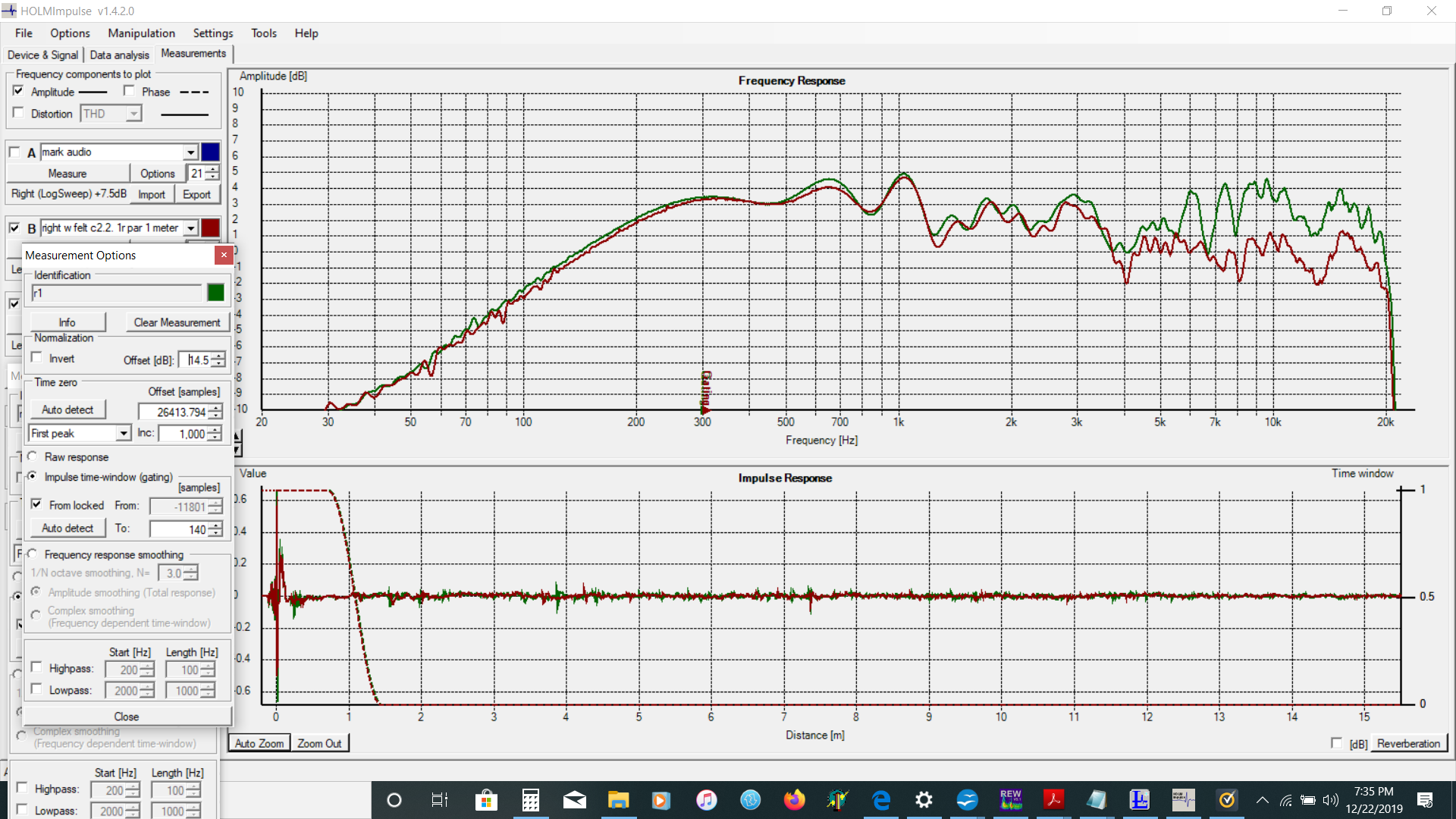

just wanted to comment on the port and the room I shorted the port to 3 3/4 inches and was able to get the bass a little better. I think a big factor is the room at least with that woofer and cabinet combination. the bottom trace is about the best bass reading I can get at 1 meter in the basement room. the top trace is the full range speaker I use upstairs and it was measured upstairs. I think the next move is to make a smaller box for the speakers and move it upstairs. the Nextel drivers do seem to be considerably different than the mag drivers. The middle line is the original thor with the spl meter that explains the upper tilt to the treble. but the original thors where a better speaker in that room.
