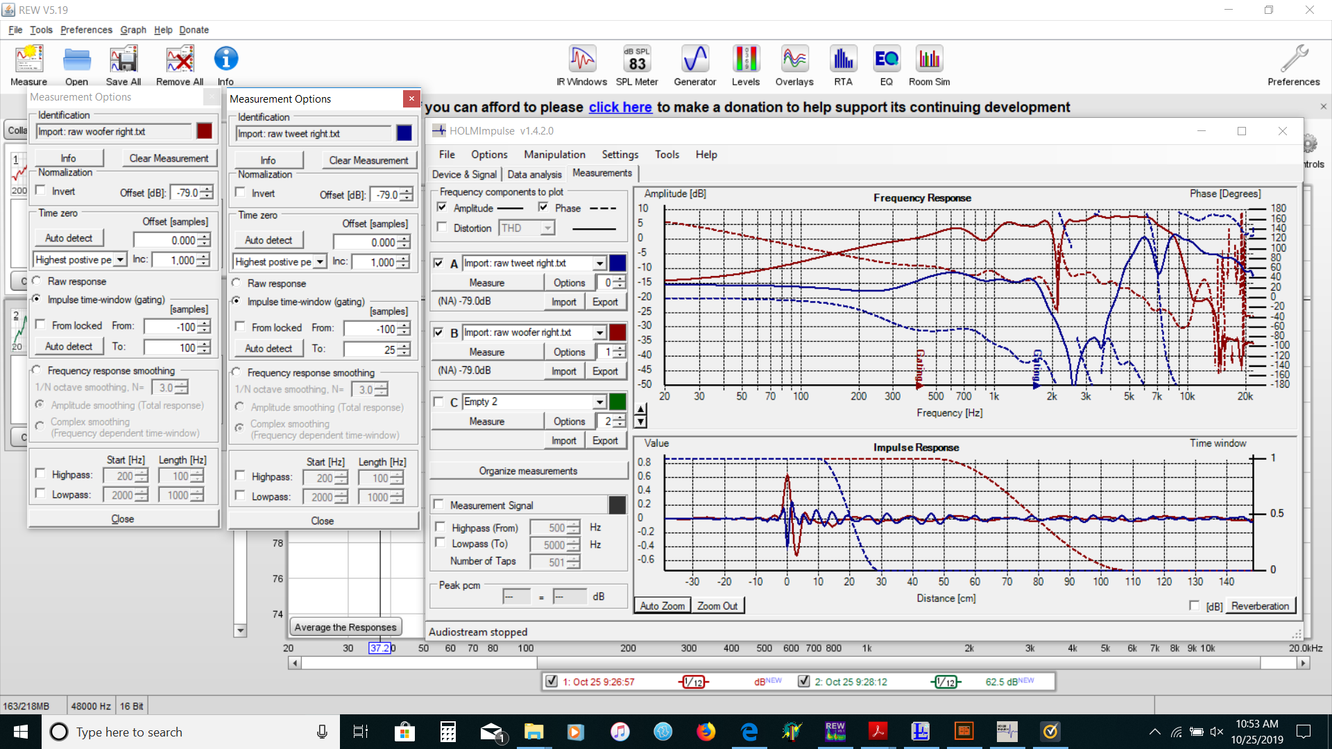

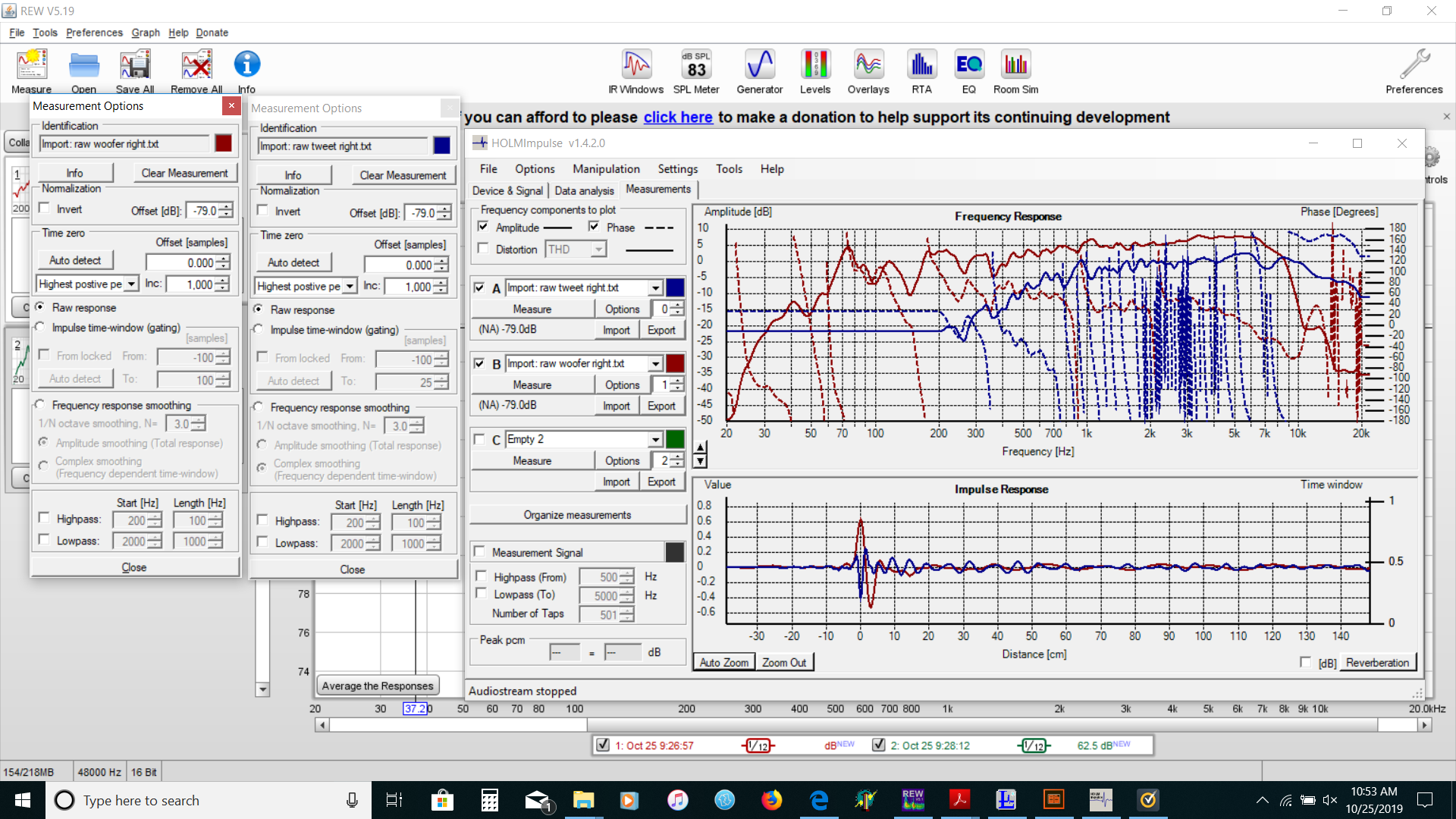

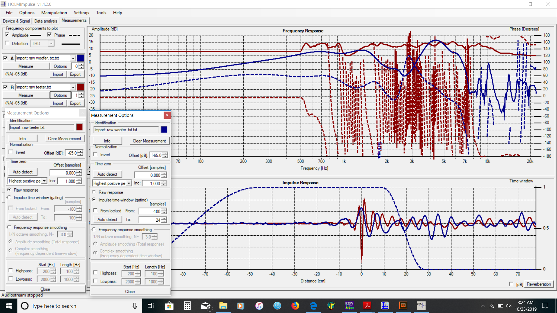

Could you post a screen shot of your Holm window with a measurement, with the small dialogue box from the options button next to the measurement, and the impulse showing and zoomed to partially fill the window?

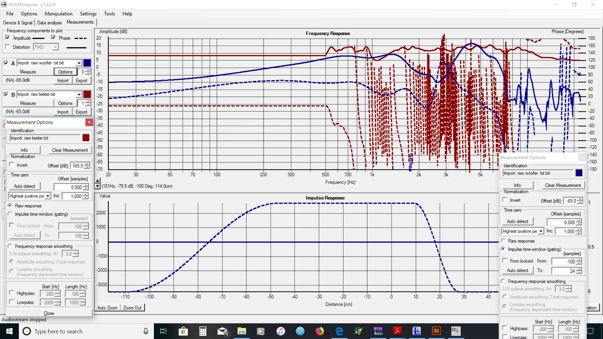

Hi Allen Here is a screen shot I hope I got the info you are looking for thank you. I did switch the speakers right for left and the large dip in the bass on the left speaker is the room. thank you again for your help
Ok, ...

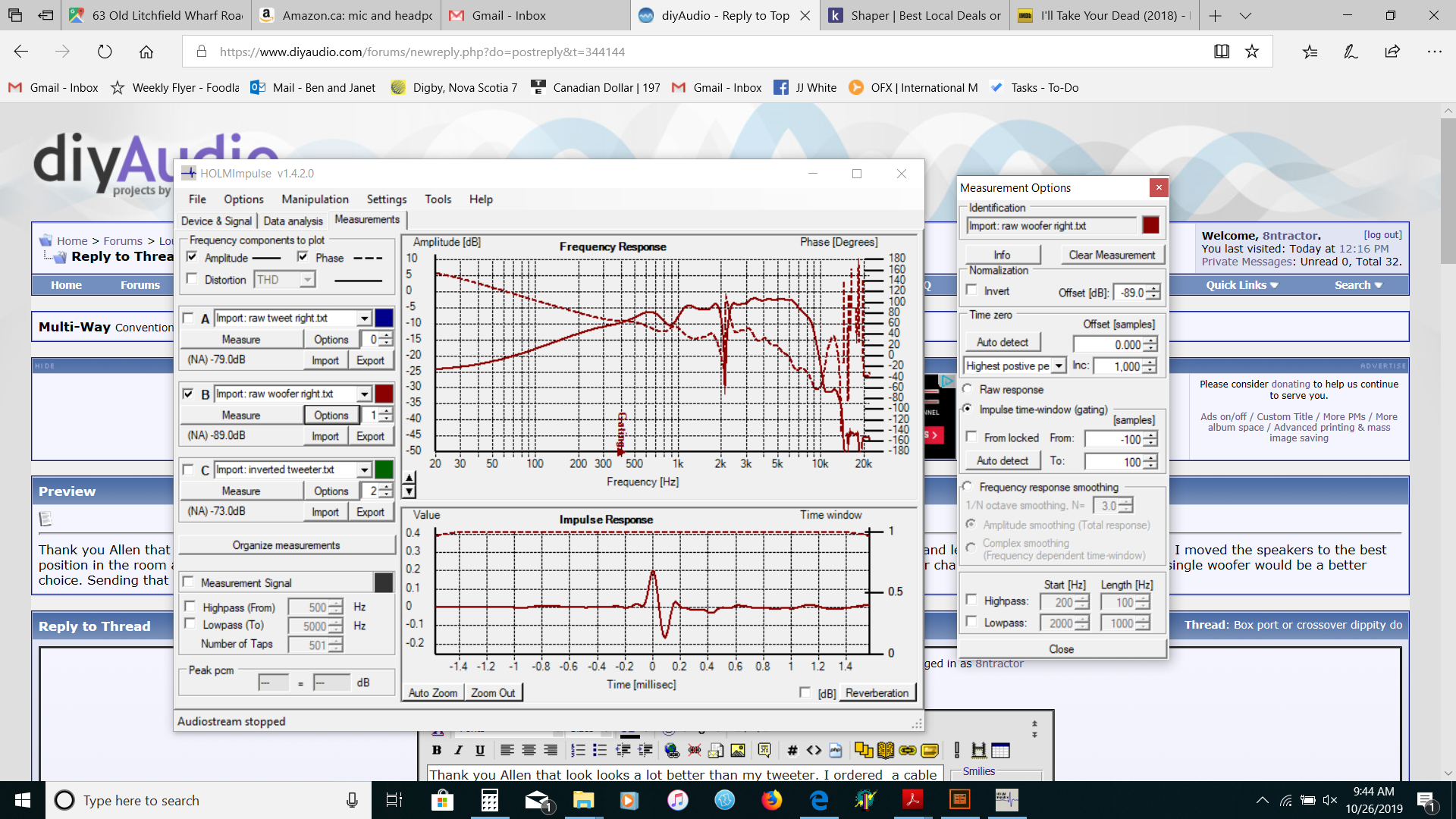

In the measurement options for the tweeter, below 'raw response', choose 'Impulse time-window (gating)'. This explains why moving around the room makes a difference when it shouldn't.
In the impulse response window, you can only see a flat plot. The vertical is zoomed out. Maybe you could click on auto zoom, then zoom out as required and reverse drag across the plot to zoom back in.
The blue arrow just before 2kHz indicates the lowest frequency that your gating window can resolve, which of course you can change. First though, the start point is -100 (from locked) which includes some empty space, which is counted, so you aren't even actually quite getting 2kHz. You might be able to set it to -20, watch that this doesn't affect the measurement by chopping off the start (make sure the response stays close to the same and that both channels are done. Then you can extend the time by either dragging the right side of the dashed line on the impulse plot or setting in the 'To:' box next to 'auto detect'.
It may or may not be an issue that your measurement came in at over 0dB. Noise gets further away, but distortion gets closer. (Just noticed your offset, ouch, unless something isn't calibrated. Not important though as long as you are within a good operating region.)
Learning where to gate and how successful you were in clearing a space, will be easier to see when you fix the tweeter measurement.

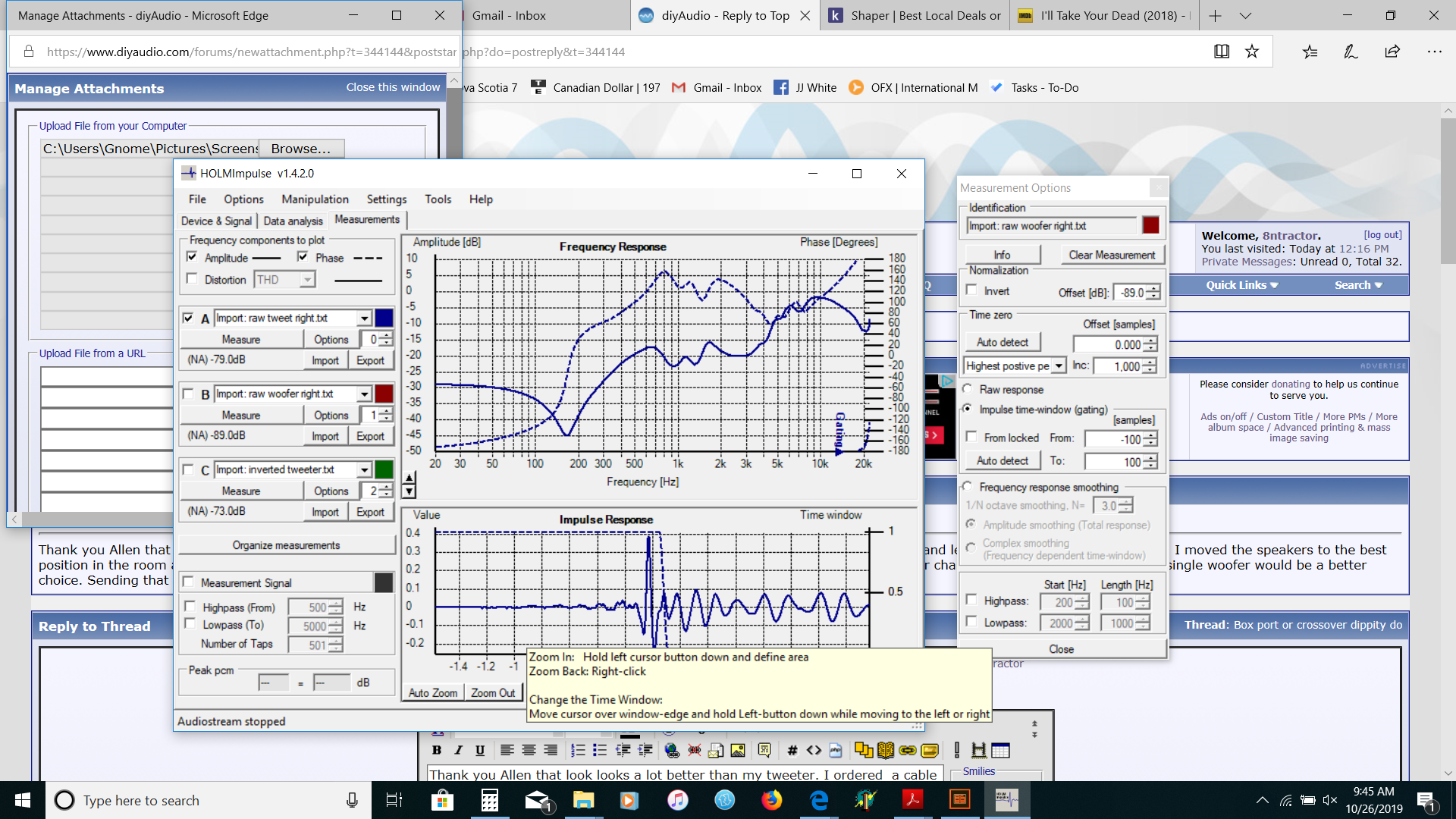

Hi AllenB thank you for taking the time to explain this to me. I reran the tweeter and both woofers I am still running REW for the measurements and need to figure out how to get Holm to do it I have a Primare pre pro and it is pretty old so the usb or hdmi will not work. I am seeing the advantage of the Holm software and there is a learning curve. I am attaching the data but I do not think it can be imported and give accurate results. this is with both woofers no crossover gated and ungated. thank you again for your help. I have finished the audiophile speaker and most of the Weems book. The next thing I am going to do is go back and read your sticky again I read it a few weeks ago but I think I will have a better understanding now. thank you again

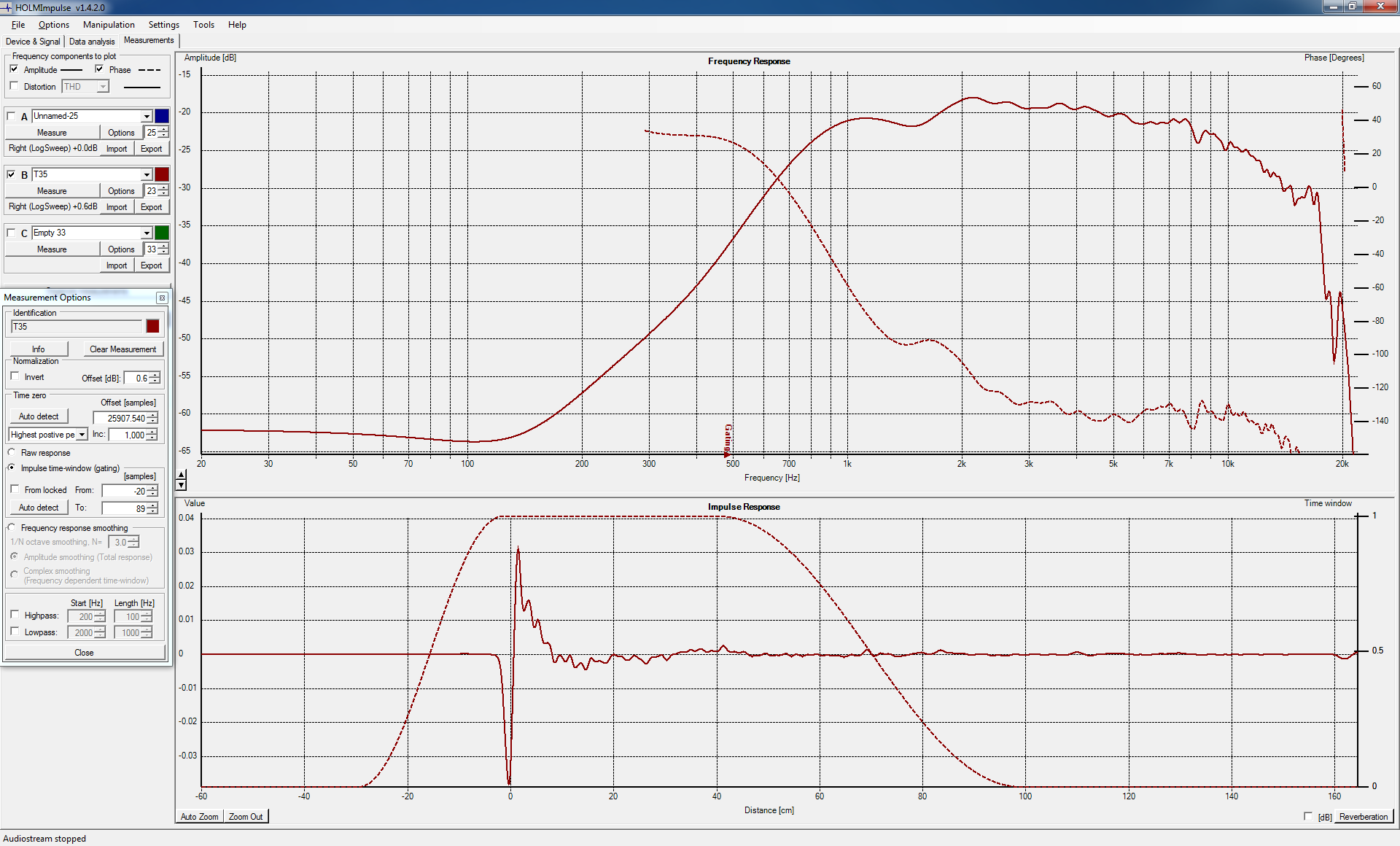

Thank you Allen that look looks a lot better than my tweeter. I ordered a cable that I think will separate the mic from the headphone jack and let me use the windows computer. I moved the speakers to the best position in the room and they are disappointing. almost ready to start from scratch with more room appropriate sized speakers. The woofer chart looks closer to yours maybe a single woofer would be a better choice. Sending that chart was very helpful now I know what I am looking for thank you. I am working thru your non measurement sticky. and will lay it out when I get the chance. I was stuck on keeping the crossover I have and after listening I am unstuck. thank you again for your help
I hope it works. IntelHDA (successor to AC'97 audio standard for PCs) allows jack retasking. I can turn my inputs into outputs and like that.I ordered a cable that I think will separate the mic from the headphone jack and let me use the windows computer.

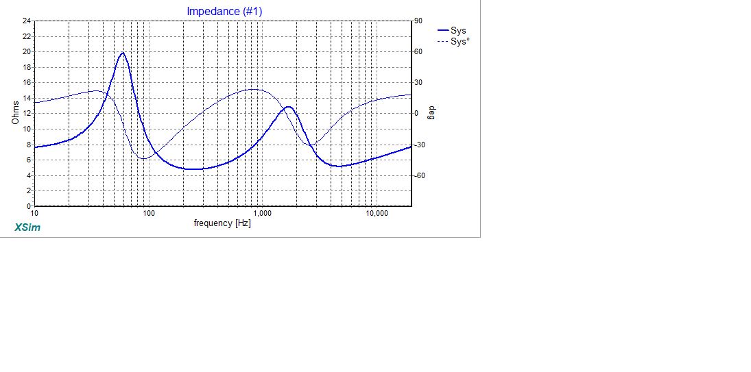

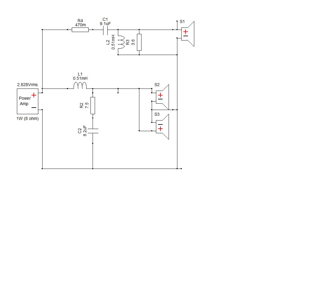

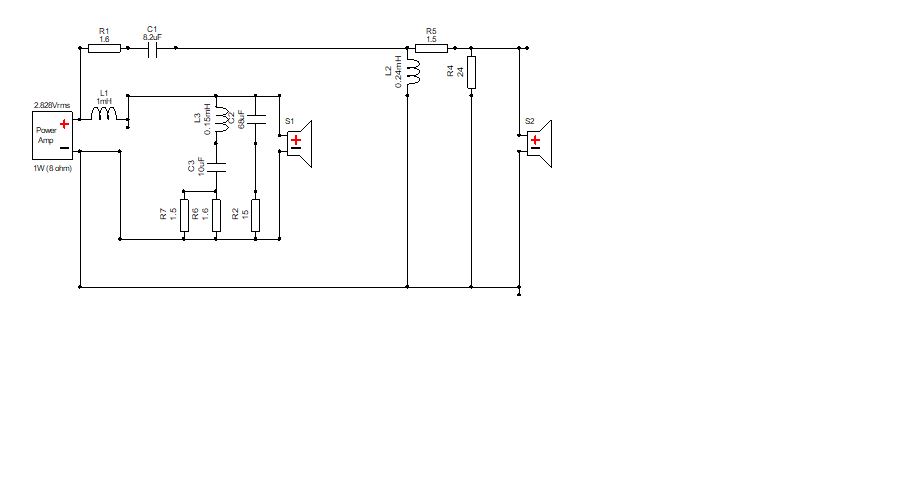

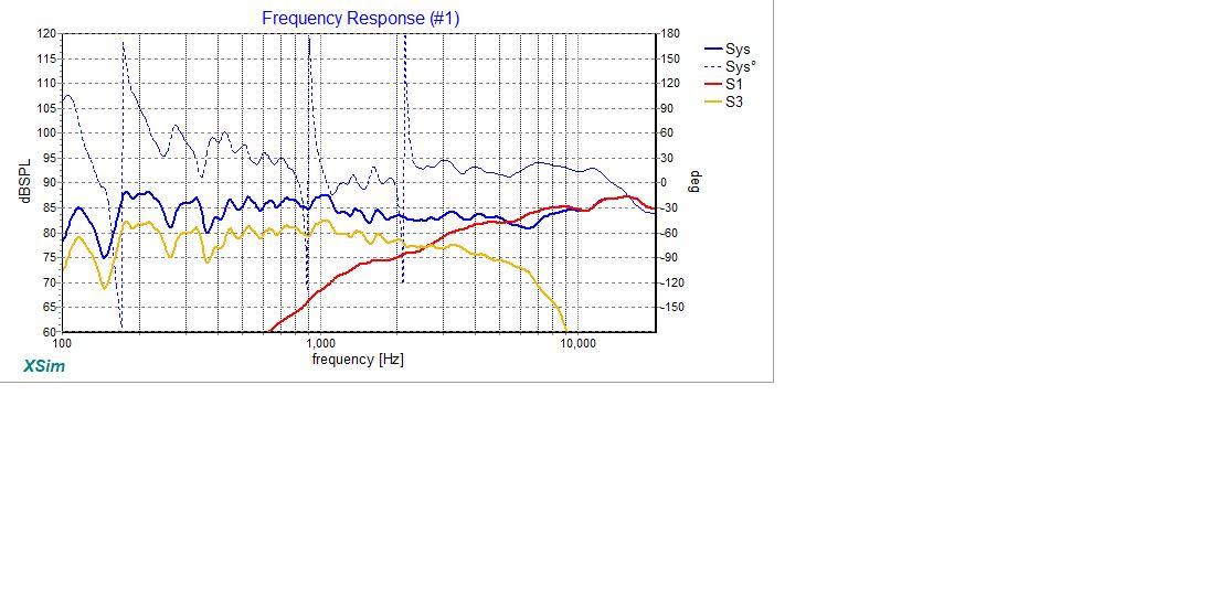

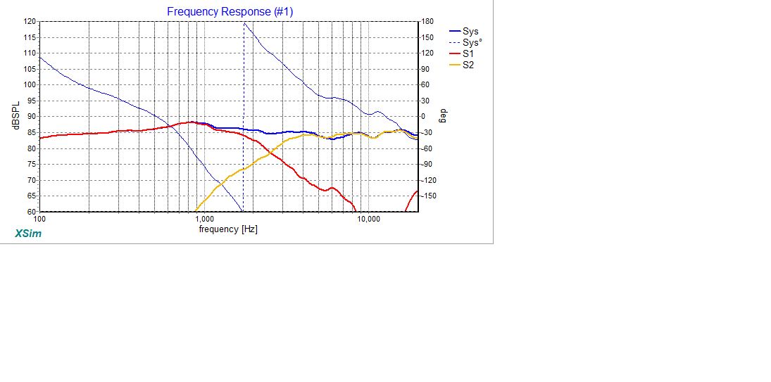

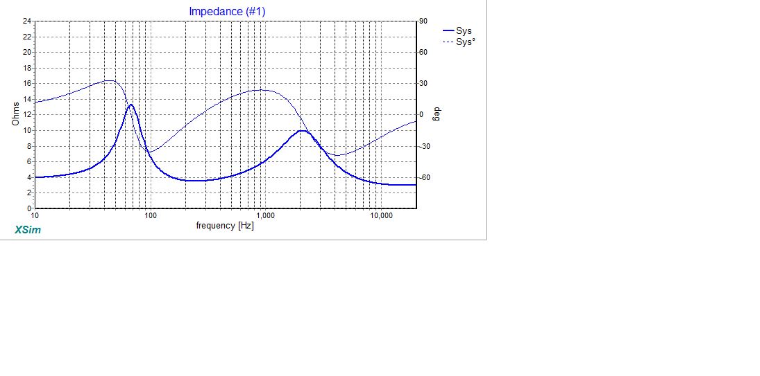

While waiting for the cable to use Holms. I ran thru your procedure on building crossovers and entered it in xsim and a spreadsheet. I used the measured woofers and the sim tweet as that measurement is so bad. looks good. it looks like I cannot load the spreadsheet. the xsim is attached.
I also found a TM madisound design for 2011 using those drivers but the cabinet is only .48 sq ft. not sure if leap is any different than xsim we do not get the same results close though.
