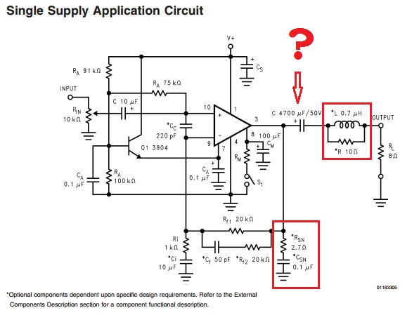

I'm also considering to use the Thiele network in my XY kit, but have some questions about it
- What is the minimal wattage for the Zobel resistor?
- I have some WIMA MKP10 100nf (400V) capacitors left. Are the OK to use for the Zobel?
- Where to put the other half of the Thiele network? close to amp board or close to the speaker connector in the chassis?
- What is the minimal wattage for the resistor in the second part of the Thiele network?
- So the saturation current for the inductor should at least be 4-5 A. Such inductors are hard to find. where can I buy them? Or can I make them easily myself.
- What is the use of the copper wire on the top side that is to be soldered onto the output PIN? Is this nessecary?
In the attachment you'll find a diagram from National Semiconductor. Are the components with the red lines around them by any chance the Thiele Network?
There is also a large capacitor in the output line. Why?

The turns of the output inductor use enameled copper wire.
You will have two layers of that enamel insulation between each touching pair of copper turns. What's the problem?
Yes, the 4 components inside the red outlines are the Thiele Network.
The amplifier should never become unstable. The amplifier should never see a significant RF signal after the input filter.
The resistors in the Thiele Network should never get hot.

So 600 mw for the resistors should be enough then?Yes, the 4 components inside the red outlines are the Thiele Network.
The capacitor is also for stabillizing the amplifier?
