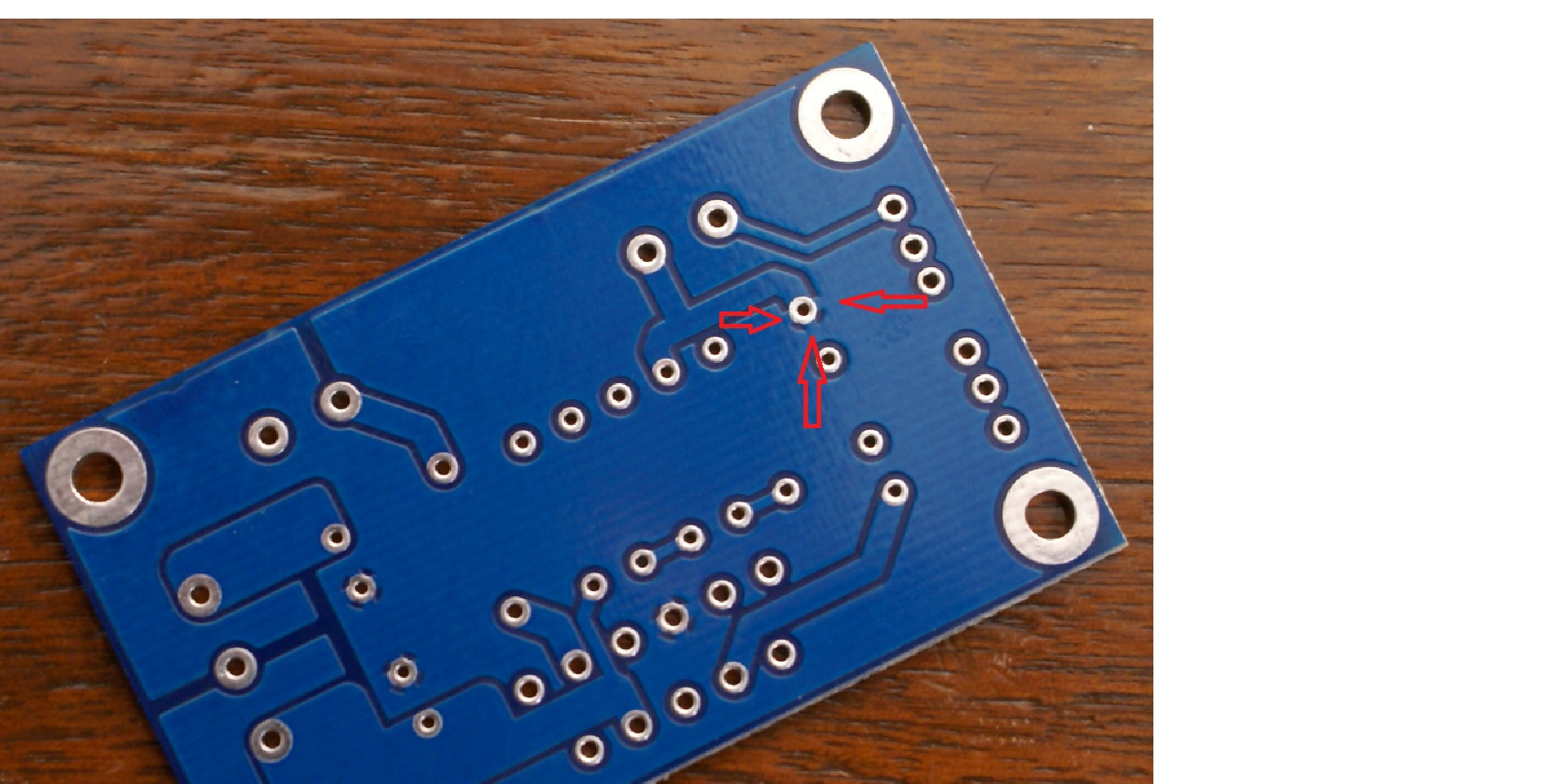

I want to build a two channel amplifier into one chassis. You where telling Aguilabrava that three trace bridges must be cut.
Could you or anybody else explain to me why this is necessary when building a amplifier with more then one channel in the chassis? Others here have build this amp without cutting these traces and their amps seem to work just fine.
I marked some areas with arrows in the image that I borrowed from Aguilabrava. Are this the trace bridges to be cut?
I already have the components soldered to the board, would this be any problem?

Thanks Pacificblue for answering my questions! That's all clear now!

In a monoblock, where one has just one channel of amplification there can never be interchannel currents flowing.
In a multi-channel amplifier, there can be many cross connections for inter-channel currents to flow. The problem is identifying them and ensuring that the currents that do flow, do not cause any audio voltages to be generated.
This is where separating the Signal Ground from the Power Ground becomes of importance.
Thanks for your answer. Could you please also answer my question regarding the bridges that have to be cut. See the image in post 183.

Regarding the bridges that have to be cut, I posted pictures in this thread so AndrewT and Pacificblue don't have to be answering the same questions over and over...
