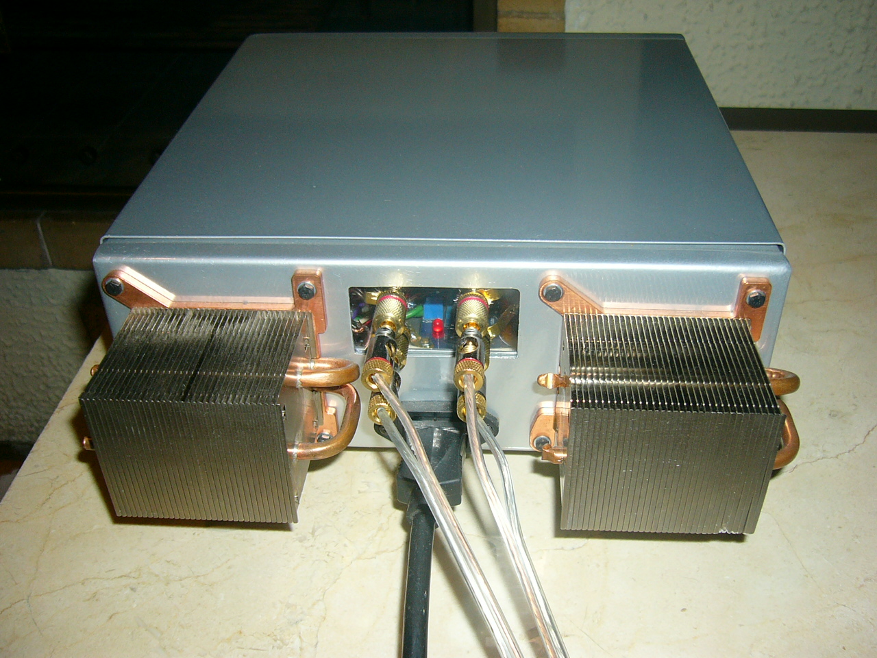

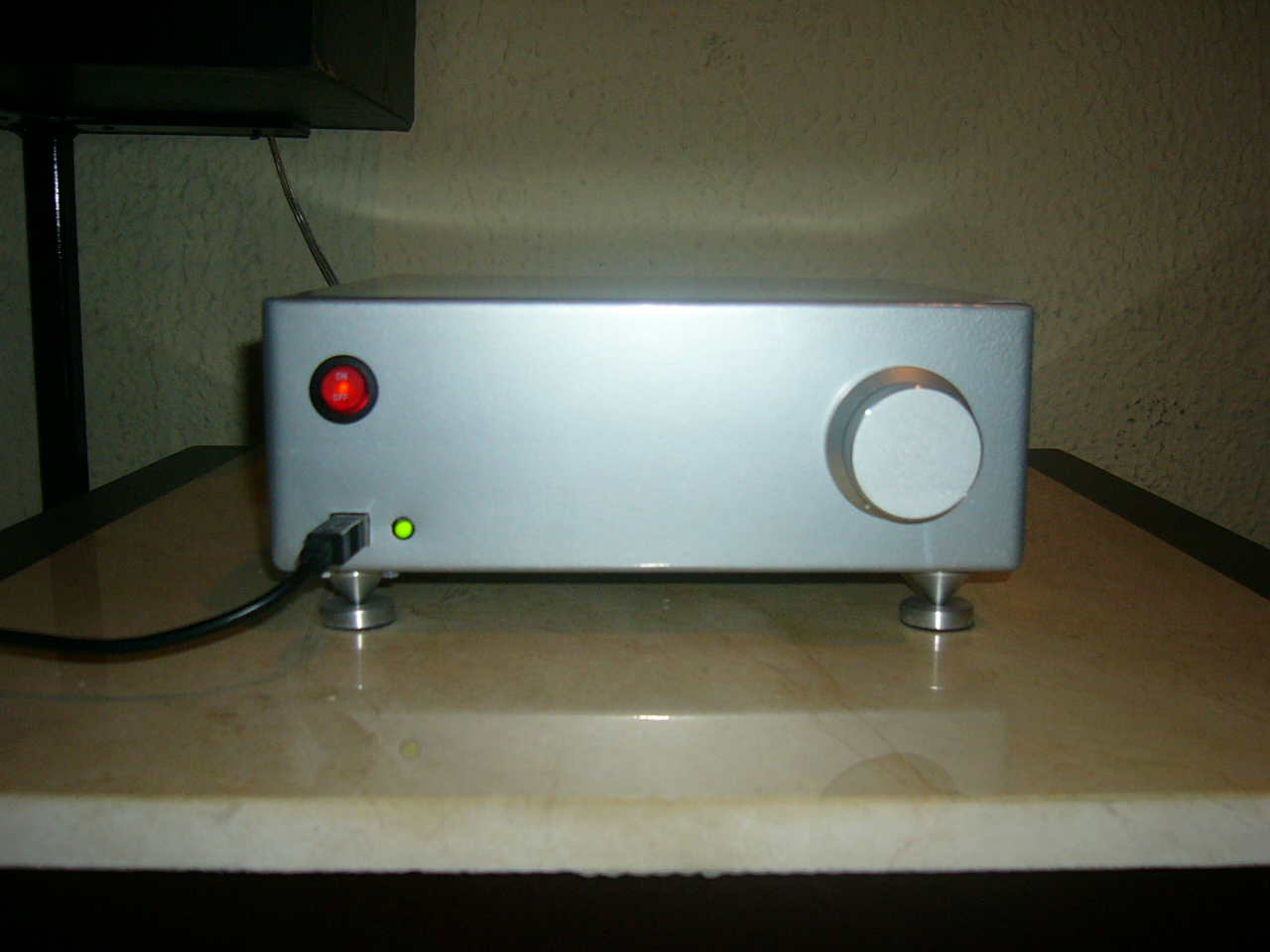

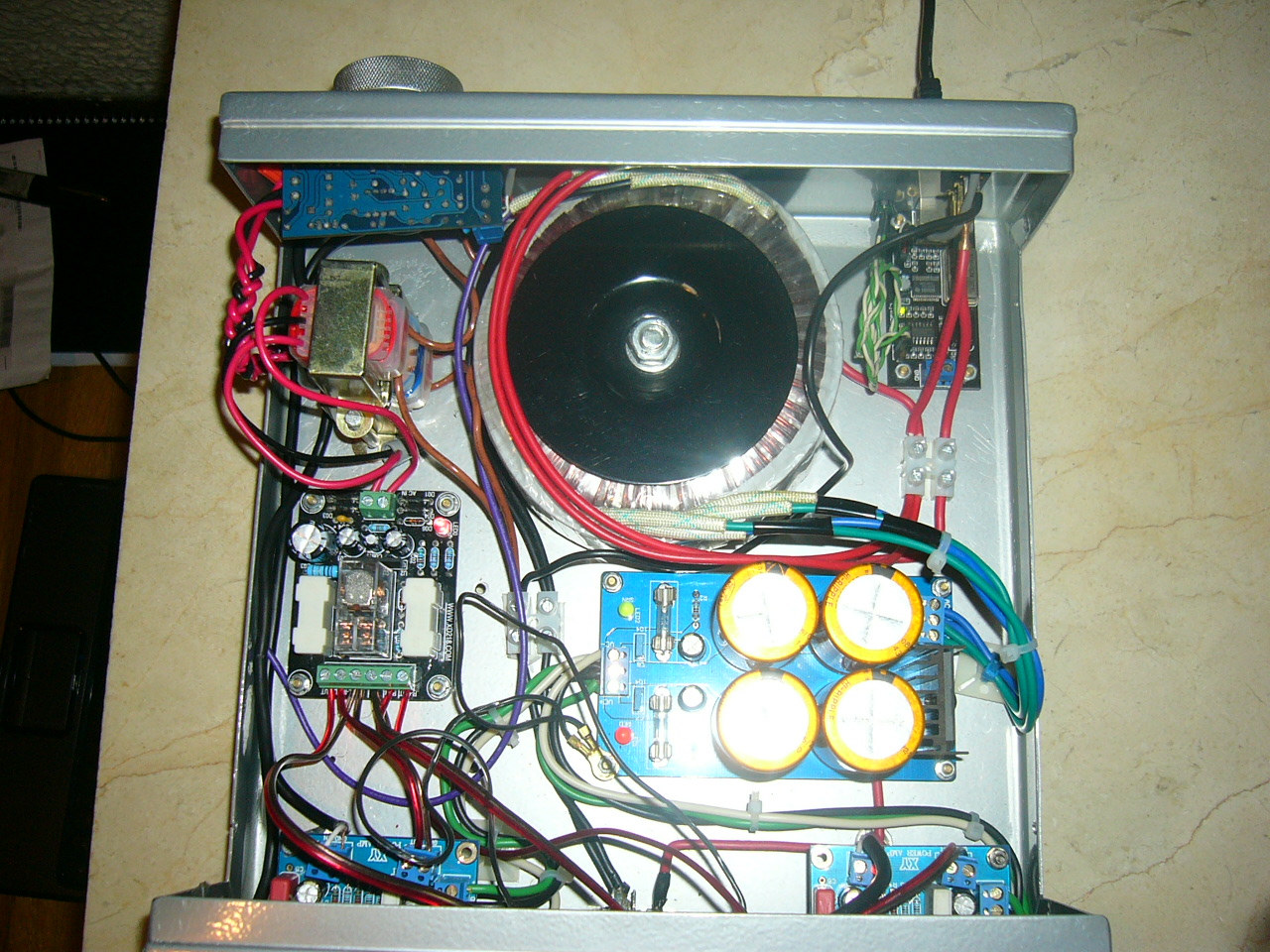

Here are some pics of my first XY 3886.
I might use this new chassis for the XY Plus

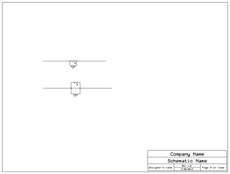

Then I can solder the resistor and inductor together in parallel, attach one end to the + speaker output terminal and the other end to the wire coming from the PCB?
I was thinking about removing two little pieces of insulation from the wire coming from the PCB, like 2mm each, and then solder the inductor on top side and the resistor on the bottom side, then putting some heatshrink to cover both resistor//inductor. My question is, would this work since I am not cutting the wire, just two 2mm sections of its insulation to solder the components, or the wire has to be cut and then joined together by the resistor//inductor?.
I am attaching a picture...
The wire has to be cut, otherwise you short the resistor out and it cannot fulfil its function.

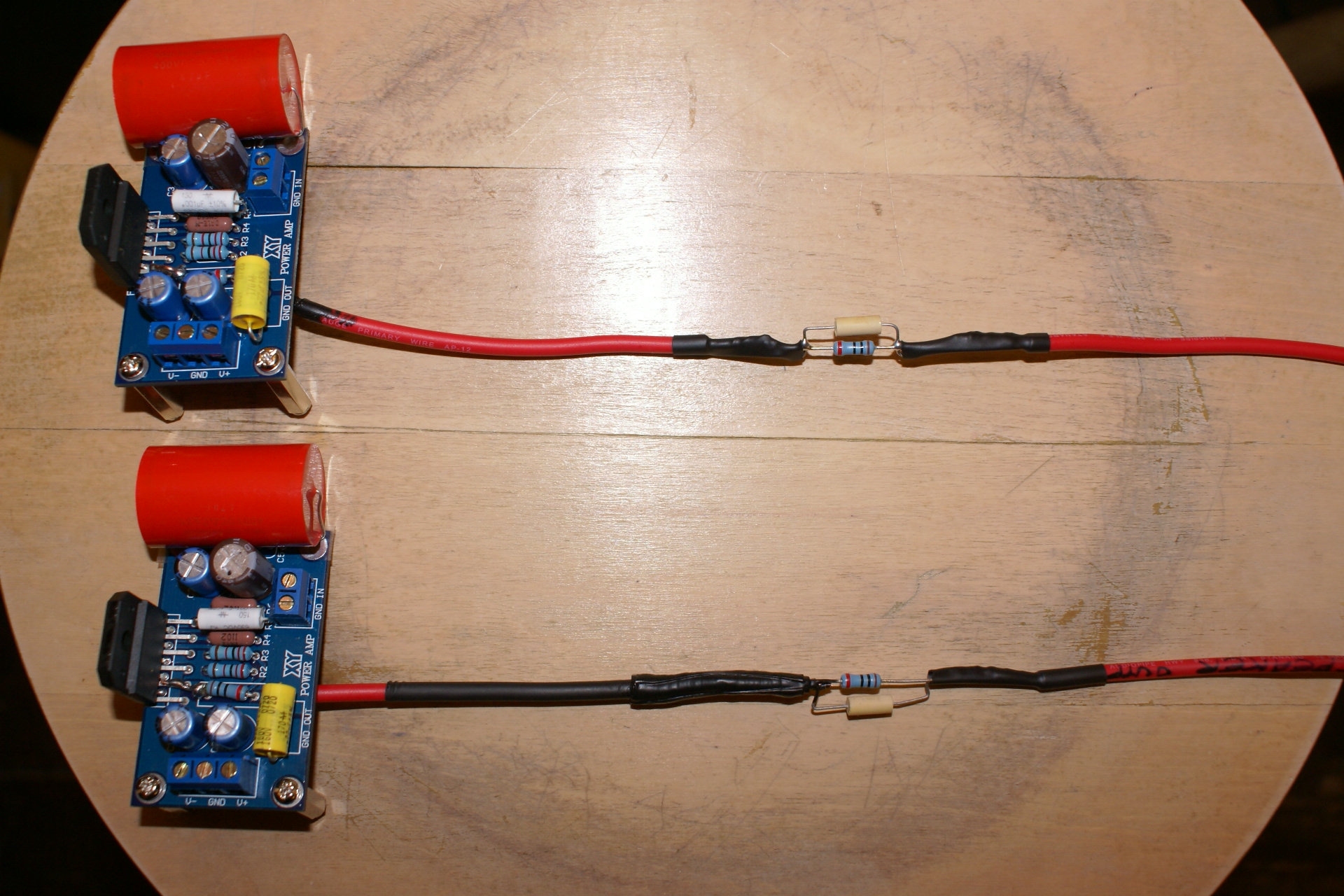

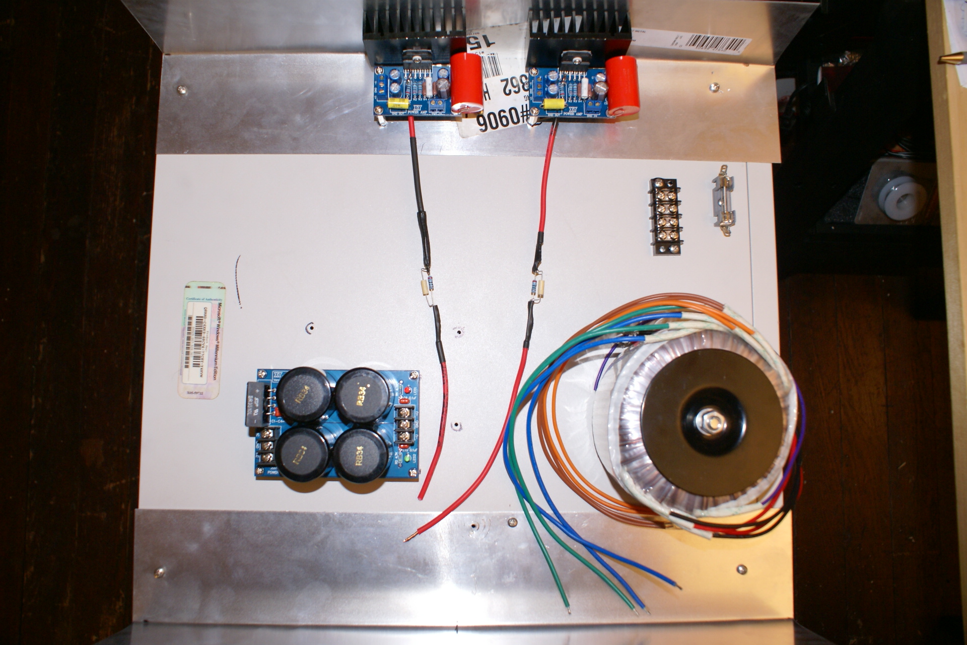

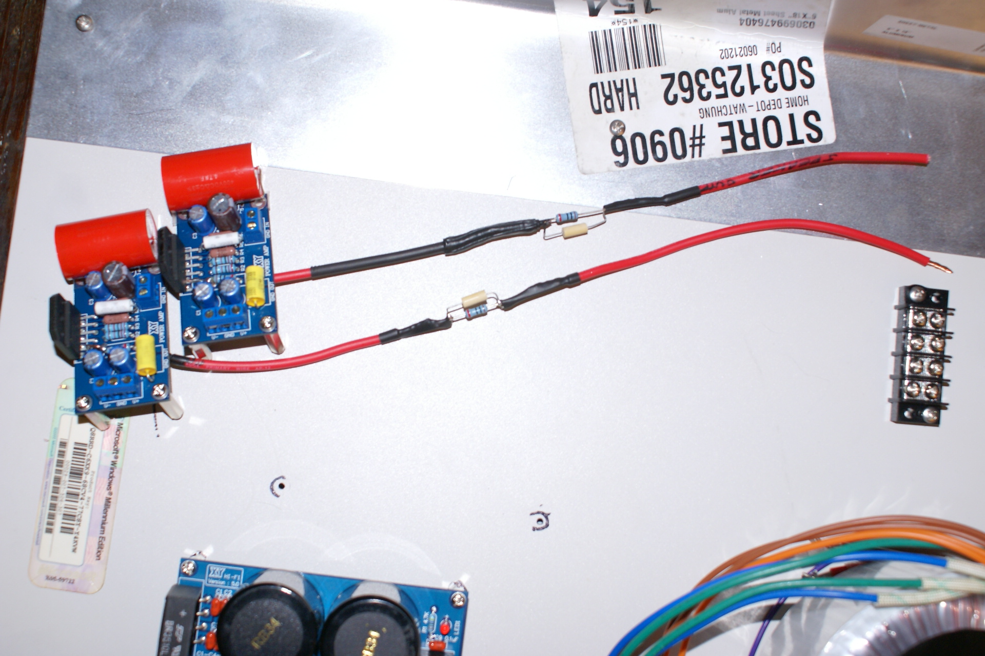

The "Thiele" R//L at the + Speaker Output Cable
Here the pictures of the Thiele network, resistor and inductor connected in parallel in the + output speaker cable. I used a 10 Ohm resistor and a 1.5uH inductor.

That inductor looks a bit small. Is that an iron core indcutor? Did you check the saturation current and DC resistance?
The saturation current should be greater than or equal to the amp output current. If the current drives the inductor core into saturation, you will get audible distortion. With your 40 V rails and 8 Ohm speakers the saturation current should at least be 4-5 A.
About 10Turns of 1.2mm enameled copper wire for the inductor.
It's resistance should read near enough zero ohms on most DMM set to ohmmeter.

API Delevan 1.5uH Inductor.
The inductor is a RF inductor API Delevan 1.5uH, 5% tolerance, maximum dc current 670 mAmps, maximum dc resistance 0.5 Ohms, self resonant frequency 160 Mhz and Q minimum 33, and it is "unshielded". This is the information I found at the place where I bought it from.
Here is the data sheet of the manufacturer:
http://www.delevan.com/seriesPDFs/1537.pdf
The seller of the speaker protection board replied with a *.doc file with instructions. It says that the board can be powered by 12-15 volts AC, the inputs are the holes/pads, and the outputs are the big holes where the speaker terminals connect to the board. I am attaching the *.doc file to this post. Please take a look at it.
I am also attaching a picture of the boards mounted on top of an old PC desktop, this is just to test it, I will get a nice amplifier enclosure for all the stuff, but I'm dying to hear it. I am not using the input selector board yet.
Again, thank you very much AndrewT and Pacificblue, this would have never been possible without your help.
