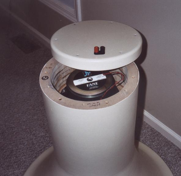

Hi JLH, in looking at the throat and driver mounting section of that horn, does it use an M4? Sorry djn, dont mean to derail your thread.
A M4 as in the Community M4 large scale compression driver? If that is your question, then the answer is no. I would never use that driver in a hi-fi system. Their sound quality is very poor. These horns used the now discontinued Fane Studio 8M.
At a glance it looked like that was what it was cut out to receive. I was going to ask how that worked out.

I can see how you might think that by looking at the pictures. All those holes were for the bolts to hold the back chamber cap in place.
