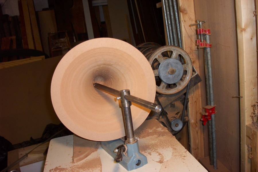

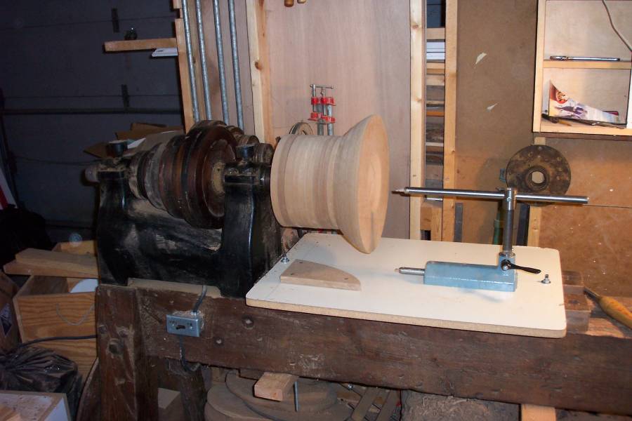

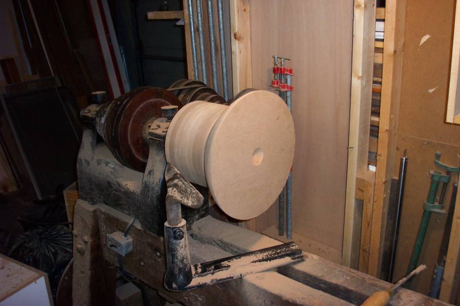

Here are a few pics of how I turned my 345 Hz Tractrix horns. They have a 2" throat,12.5" mouth,and are 9" deep. 14" outside dia.
I cut out and glued circles of MDF,was too lazy to cut out the centers.
The outside was turned freehand,and I used the setup shown to cut the inside.
The 3/4" boring bar was a bit flimsy,so light cuts had to be taken to prevent chatter. While I was turning,I wished I had taken the time to cut out the inside circles.

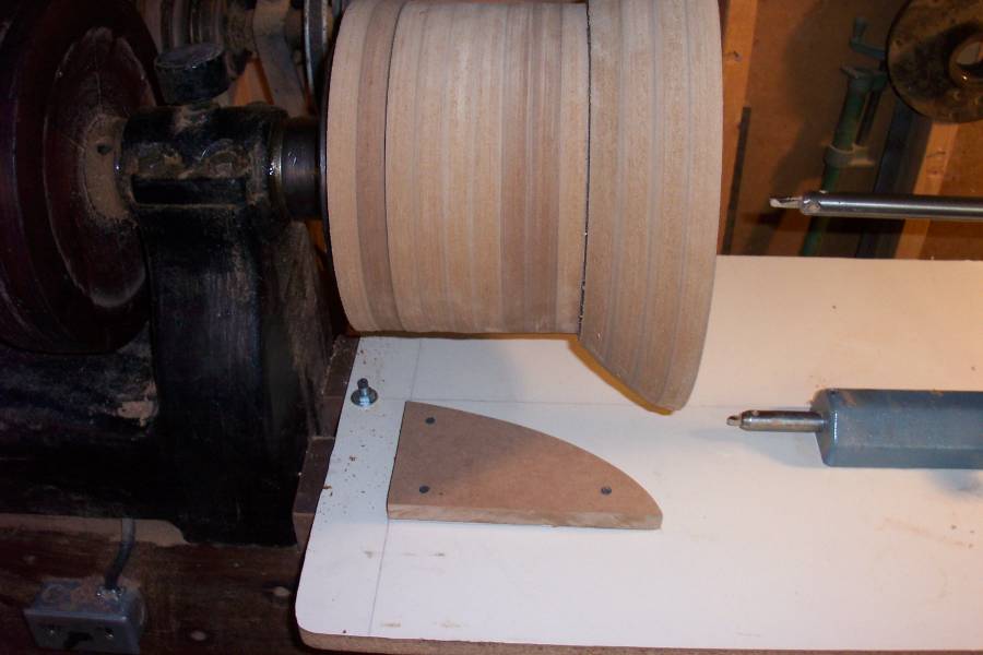

The pattern and follower at the bottom prevents the tool from cutting too deep,so you don't have to constantly stop to check your progress with a template.
Love your lathe Don!!! I really like that pattern you use. I'll have to give that a try. I use a 1/4" plywood template now and have to keep holding it up to check progress.

No "add to cart" yet. I am just messing around combining my two passions.
The sidewalls on the rectangular horns don't have much profile to them. And, yes, one disc will give me a pair of horns.
