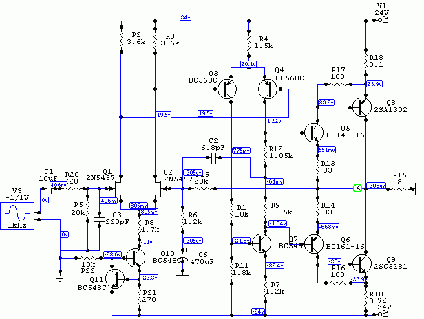

"This days I've finished amplifier Techno with output stage done according
to schematics from Borivoje Jagodic. You can find that schematic on his
site: http://bas.elitesecurity.org/mojiprojekti1.html . Preamplifier stage
is my own idea with SMD OPAMP-s TLE2071.
Here are some photographs of progress of that project:
http://img.photobucket.com/albums/v...an/IMG_0878.jpg
http://img.photobucket.com/albums/v.../IMG_0877_1.jpg
http://img.photobucket.com/albums/v...ecijan/amp1.jpg
Here is how it looks today:
http://img.photobucket.com/albums/v.../IMG_1080_1.jpg
and here is how it will look when I finally close the case-enclosure:
http://img.photobucket.com/albums/v.../IMG_1077_1.jpg
Some technical aspects:
Output transistors are ONSEMI 2SA1302/2SC3281 (thanks to "Pinco"), and the
rest is all according to schematic. Because those transistors have high GBW
it is necessary to put capacitor of between 150-330pF in parallel to
existing 10k resistor at the input of amp. Otherwise it might oscillate!
Everything else should be done by schematic.
Mains transformers were 29V/200VA per channel + separate transformer for
preamp.
Amplifier posses power in abundance. Control is immaculate, and in my tests
it was working with Focal Electra 1028, and with Electra 905, Diapason
Micra and JBL CM42. Amp is biased at 90mA and if anyone is going to build it
I suggest bigger heatsinks than mine.

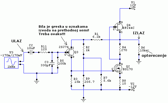

This one is called 3FET line BV
