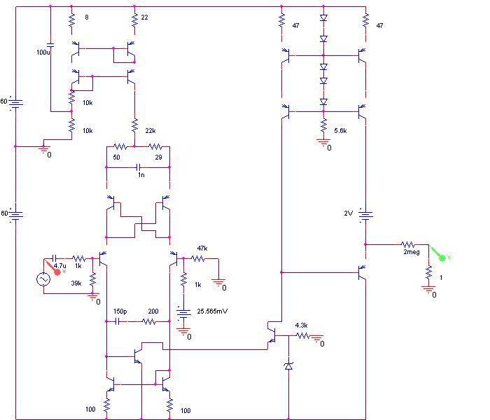

boraomega said:
Damn... "darkfenriz"! I was hoping that no one would recognize it! Yes, it was started as an audio amp. idea, but ended as High-End Schmidt trigger... of course, high power one.
Are you being sarcastic here?
Or joking? Laughing at me or what?
Or you don't mind wrong circuits signed with your name?
Please answer clearly that either I am wrong (and why?) or "delta" is wrong and nobody should even try to build it the way it is drawn on attached schematic.
And if I am wrong, forgive me picking on.

So I think, that these differential and voltage amplification stages of "delta" ...

Ultima Thule said:
Thank you also Bora and Ilimzn for pointing into the Hawksford direction.
In one of the Hawksford papers I see on p.509 pic.15 that he uses two CCS instead of one as in the Delta design, Bora have you seen any Hawksford paper with the crossconnected transistors using only one CCS or is this your own idea?
I don't have much paper from Hawksford so maybe somewhere else it's maybe explained?
Ultima Thule is pointing at: J4 DISTORTION CORRECTION CIRCUITS FOR AUDIO AMPLIFIERS, M.O.J. Hawksford, JAES, vol.29, no.7.

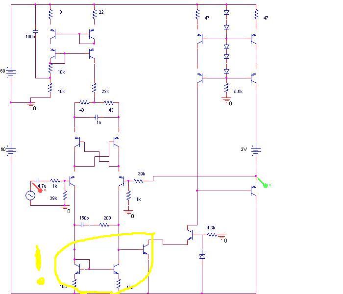

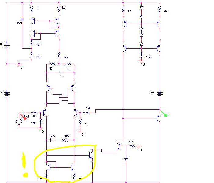

Hi Darkfenriz,
I think you are right.
Also to my understanding this Hawksford error canceling diff amp turns signal polarity to the opposite of a normal diff amp.
...see figure 15 in Hawksford papers Chapter "5 Indirect Distorsion Cancellation Topologies"....
Let's go stage by stage:
When the input signal moves upwards:
==> Ic of Q1 increases, due to error cancelling diff arrangement.
==> Ube of Q11 increases.
==> Ic of Q11 increases.
==> Ic of Q12 increases.
==> Output moves downwards.
Input at Q1 is inverting.
Base of Q2 is noninverting input and getting the feedback signal.
...urghs... !!
Great that you noticed this point !
