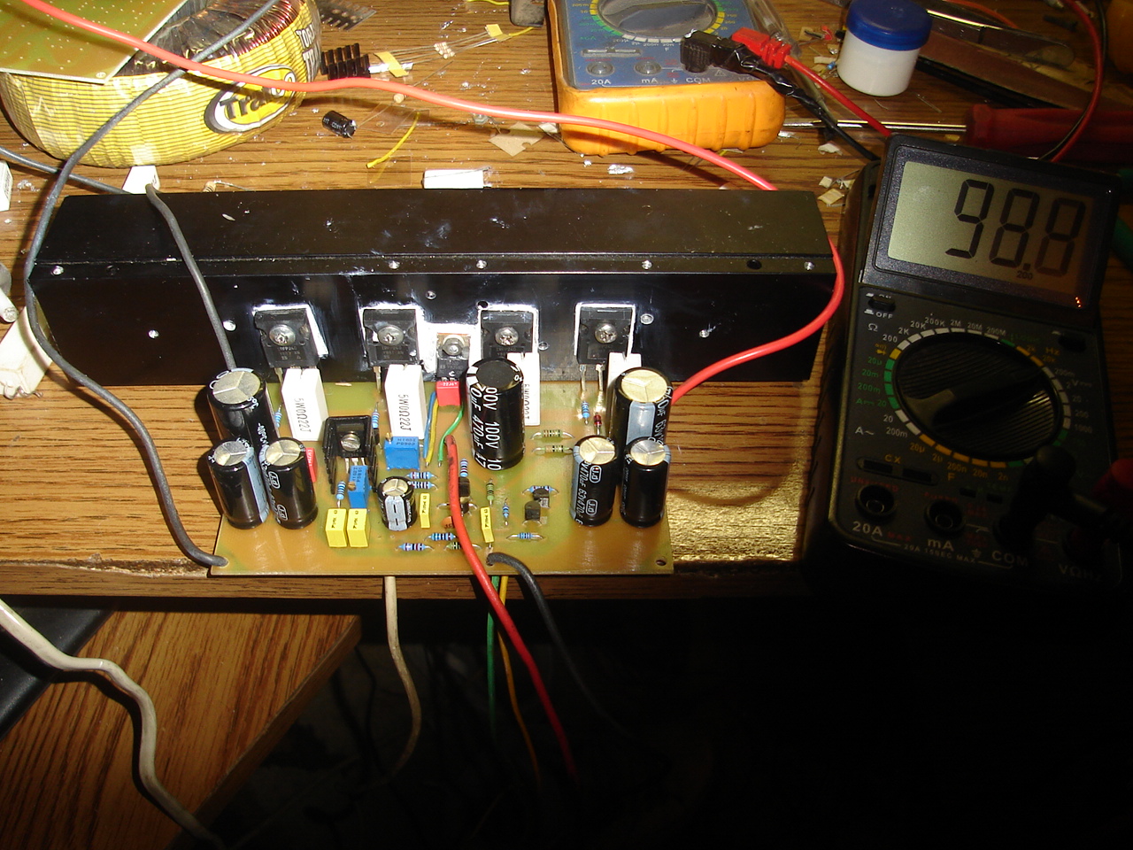

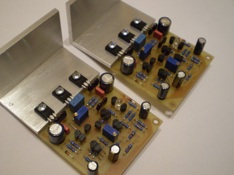

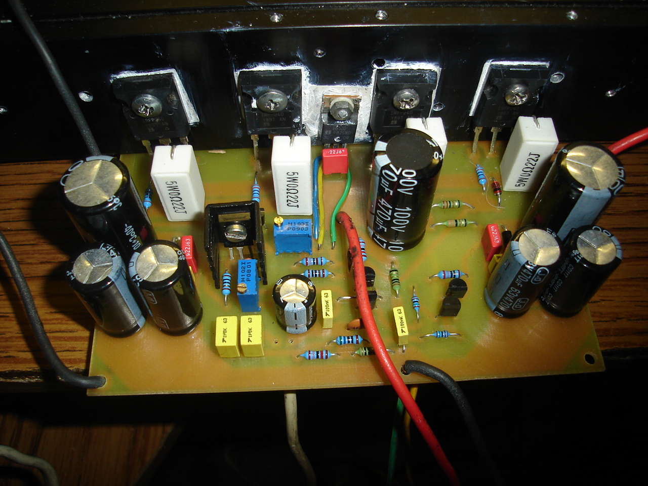

Hi all,
Thanks to Dr Bora's advices, I have completed my Sigma Lateral-MOSFET amplifier and had been listening to it for a couple of weeks. I am impressed with the sound quality and it is one of best amplifiers that I have listened to on my home setup.
The bass is tight and controlled; the vocal is sweet & clear and the high is detailed. Overall the amp is musical and it does not exhibit any harshness at any frequency. I love the sound of this amplifier.
I used the Sigma schematics as published on :::Borina Amaterska Svastara:::
I used the recommended semi devices as detailed in the schema & I made my own PCB.
My supply voltage is 63V
I biased the output MOSFET to 100mA
The amp is dead quiet with no hiss or AC hum.
There is no turn-on or turn-off thumps.
I used an old E-I core transformer & the acoustic noise from this transformer is the most annoying source of noise of this build.
Cheers, Stanley

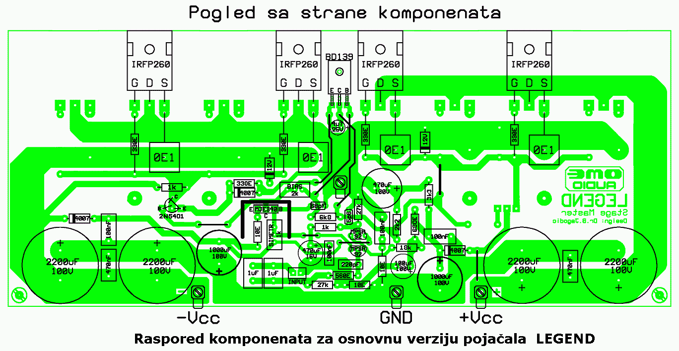

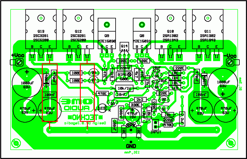

thank u victor for this pcb.
is this new version or old version?
did u made this amp?
how many watts for this amp?
what is maximum voltage of dc?
there are two pots in this pcb and i think one is for bias and other one is for dc offset am i correct.
how to adjust these pots pls explain.
1. This is the latest version
2. No, but others did
3. 100W 8ohm
4. Should be used +/-50V DC power supply
First of all make pcb, solder all the elements and then we'll adjust easily to.🙂
