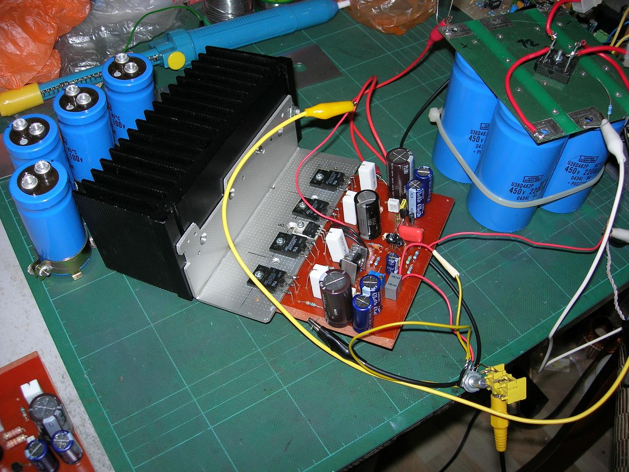

Legend testing
Fired up one chanel of Legend amp.
1)Absolutely quite at full volume even at this kind of wiring.
2)Direct input from cd player(50K pot)
3)No turn on and off "thumb"
4)Bass incredible and extended.
Thank you to Bora.
Cheers.......Raj

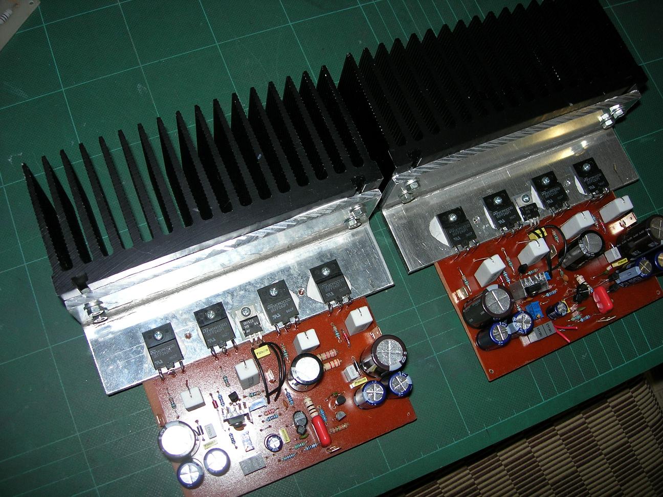

Legend Bora
Here it is the actual build.
Been testing for 24 hours and no problem at all even with the plastic packed output transistors. The heatsink(165 x 70mm with fins 60mm x 4mm thick) is just warm.
True diy, using whatever is available in hand. Now waiting to have the casing done up.
