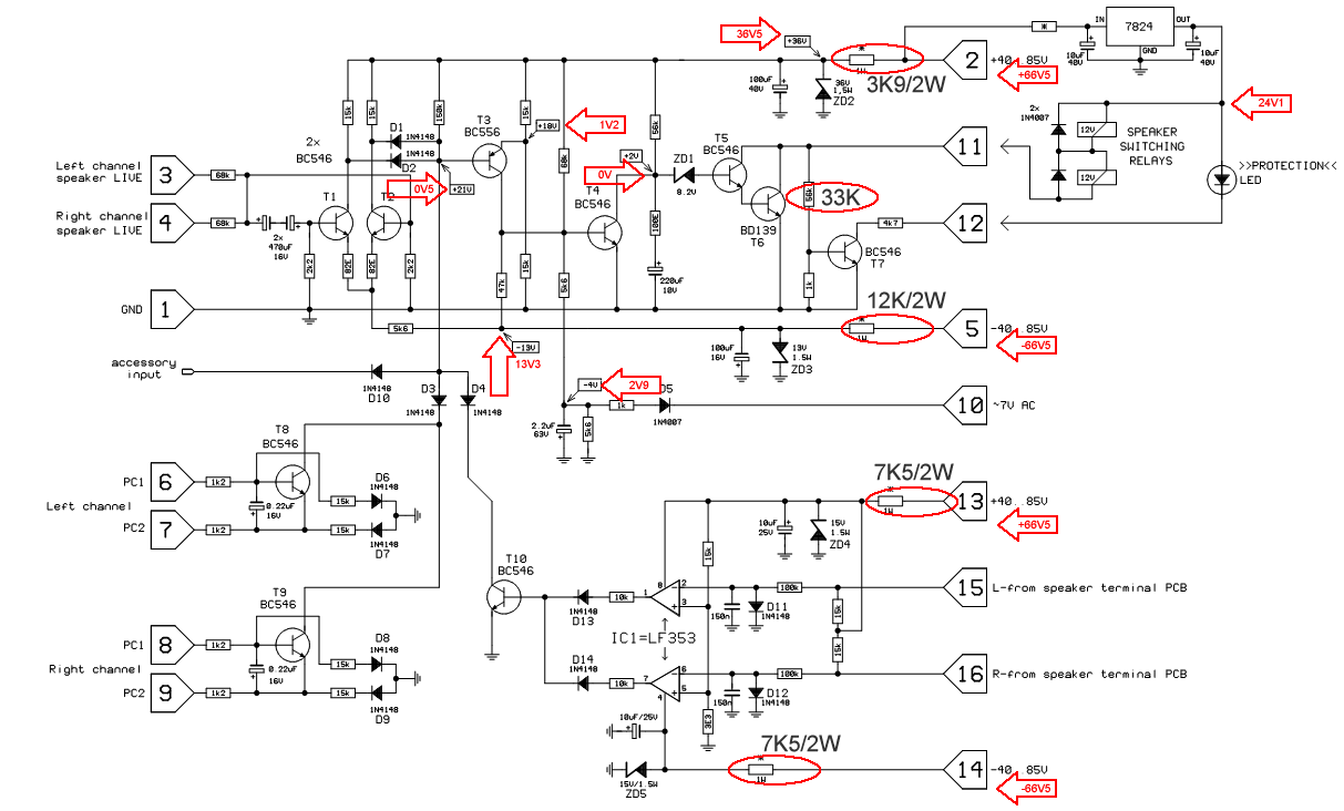

Dear Dr. Bora
I produce yr. OMNI protection circuit but unfortunately couldn't able to work it yet.😕 led is always lightening and relays never switched on. I was already red following voltages and used resistors as per attached diagram. Relay brand is "SONGLE" ,"SRD-12VDC-SL-C"
Could give me yr. most valuable advices as designer of this circuits?
Thank you very much in advance.
Best regards
Something is very wrong in your unit Duran!!! How do you explain that you have measured +36,5V across ZD2 (that voltage is OK) but then only +1,2V on the upper wire of the 68k resistor? That is the very same wire!!! Also, you have +13,3V across ZD3 when you should measure -13V there (voltage there should be negative with respect to ground!).
For your info, that unit has been done successfully at least several hundred times up to now… “Viktor1986” is one of them, he can tell you that.
