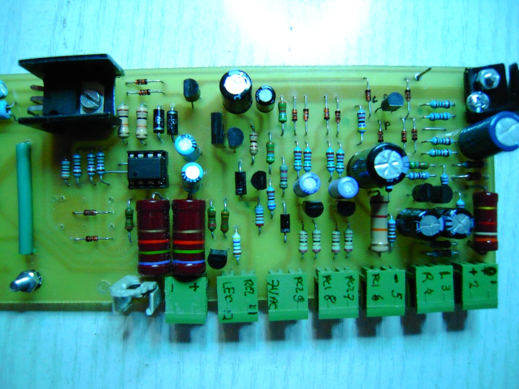

Something is very wrong in your unit Duran!!! How do you explain that you have measured +36,5V across ZD2 (that voltage is OK) but then only +1,2V on the upper wire of the 68k resistor? That is the very same wire!!! Also, you have +13,3V across ZD3 when you should measure -13V there (voltage there should be negative with respect to ground!).

I'll check again all voltages and parts once more. Do you have any pre-test procedure of it before the hook up into amp. different then checking the voltage and finding the wrong parts??
Best regards
Set the image in high resolution and also photograph plate from the bottom. Thus I do not see almost anything and especially those two 1N4148 diodes which are in parallel with 150nF(yellow blocks).
What I see, you're wrong turn LF353?
LF 353 pic.
I'll de solder of them for taking good picture.

It seems all OK in the picture. No you can get a voltage of 13V where there are marked, there must be -13V DC. I have personally made several omni protections and there are no mistakes, except of course if you're somewhere wrong around the value resistor or perhaps a faulty components.
How many volts are relays and that resistance spool? What is the value of the resistor that goes to the entrance LM7824, from +66 V to the input 7824?

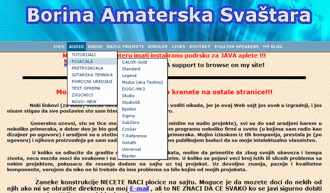

I’ve done some modifications of appearance and functionality of my WEB site recently, and I also added a link to my BLOG for visitors willing to leave comments about me or my site.
Now entry page is:
:::Borina Amaterska Svastara:::
Now entry page is:
