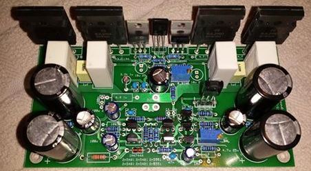

Looking good! Always a good feeling when the boards arrive and the first one is finished and ready for testing.

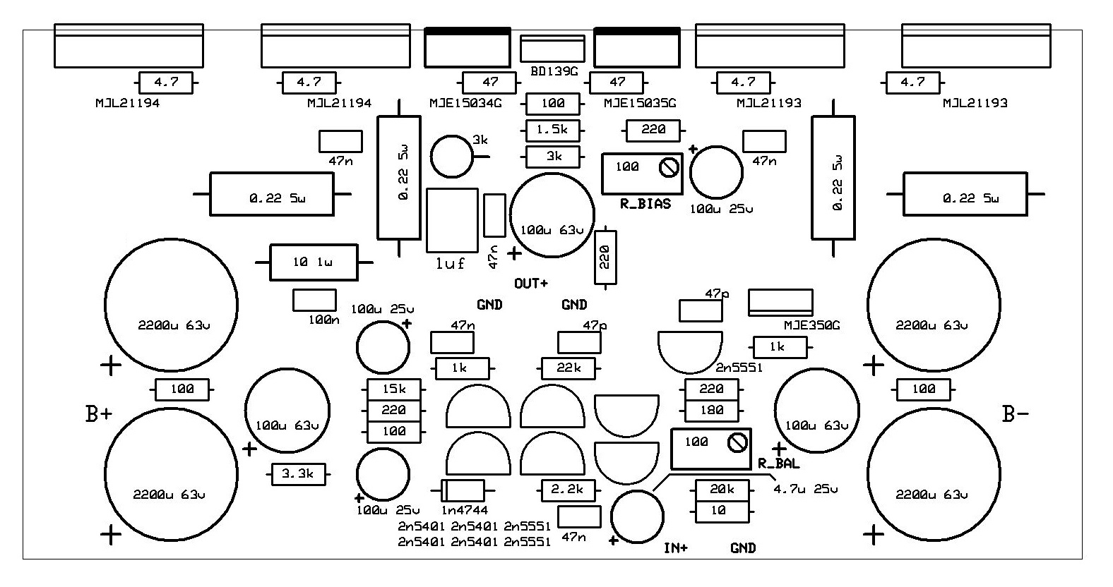

Thanks. It's nothing to special though. A bootstrapped amplifier but with CCS, LTP, and CM (current mirror) on the front end. Buffered VAS. Cdom and Cbypass are 47pf. Cbypass is supposed to be 10p but I can't find the bag of 10p capacitors.
So far so good. It plays. I had a ~20mv+ offset issue that turned out to be my mistake of putting a 100r resistor where a 180r should be. The \ through the 0 in the PCB software makes it look like an 8. Couldn't have been 188 so it must have been 100, right? Nope. Was 180. 🙂 Offset now 0.5mv but I'm sure it'll drift around. The adjustment range is good though. I need a good way to measure idle current. Maybe 1r in series with one of the rails?
I don't have a THD analyzer but I can get some scope pics soon.

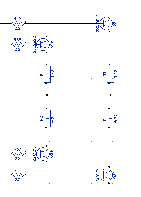

You've got an emitter resistor for each output device - just measure the voltage drop over them (with no signal) and divide by the resistor value - that will be a quiescent current through a single output pair - just what you need.

You mean current through a single device right?

You can measure each resistor one by one, however, you will get more precision if you measure across the pairs - R1 + R2 and / or R3 + R4 (see attached example).
Then, divide the voltage by the total resistance (0.44R for the example here).
It will give you the quiescent current through a single pair.
We assume that you've got zero offset at the output.
It's better to measure with no load connected.

Ok I see what you mean now. So just probe a pair of output emitters? Offset can be adjusted to 0v. I'm really happy with how well that adjustment is working.

Yes, exactly - just measure the voltage between the emitters.
Some mV offset will not affect your voltage measurement (so, "close to zero" is ok), especially with no load connected.
