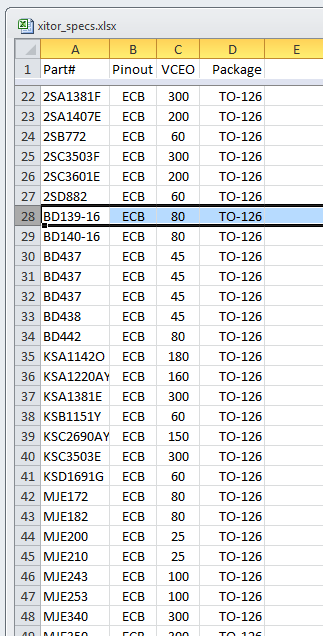

What it is with the BD139 and BD140 pinouts? EBC? ECB? WTF? BBQ?

I get that 3 2 1 are E C B but when the pinout numbering is backwards, you have to question. Or not, and design a board layout and order 500pcs just to realize you goofed up when it fries. 😛

I'm not angry about it. My comment was more for entertainment purpose then explanation. As far as I knew, terminals were labeled from left to right.
Imagine an IC having the pins numbered backwards but the pin definitions are correct in the datasheet.

Is the BD140G safe with +/-45v rails? I feel I'm close to the limits of that device.
No, not safe at all. Both VAS and driver transistors may see up to rail-to-rail voltage (90V in your case), which is higher than the limit for BD140 (80V).
MJE340/350 pair is good in this case.
2SC3503/A1381 pair is even better, but in the circuit, initially designed for BD139/140 it's just a bit of an overkill.

C3503/A1381 are 4.3X faster than MJE340/350 (using fT as a proxy for speed), and their datasheets value of Cob is a factor of 3.2 lower.

As I mentioned, 2SC3503/A1381 are better transistors in general (initially designed for video applications), than MJE340/350.
Low Cob, high fT, high enough hFE. I use them extensively in my designs.

Ok. It seems close to the BD140G but higher voltage. What's the Ft of a BD140G?
Not specified.
