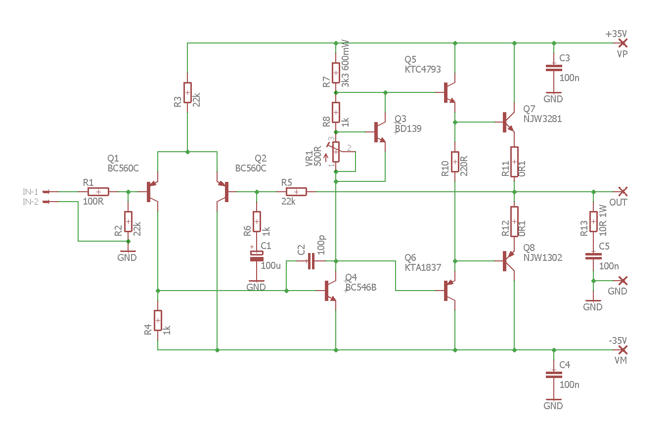

I don't like using zeners in audio circuits if I can avoid it and I can see no good reason why you've used one there. The diode next to it can go too IMHO. I like the 1k and 100u RC filter feeding the tail because its going to clean up all the hash and most of the hum on that rail. So why don't you just take a 47k resistor and connect it directly from the filtered rail to the LTP emitters and do away with that active CCS altogether? Sure it won't have the Meg ohm+ output impedance, but I bet that's not really helping that much, after all the collector load is quite high so the stage isn't going to generate much gain anyway.
I'd also get rid of the RC filter to the right, 220u and 100R - its redundant. You understand that the bootstrap is going to do a very good job preventing hum and hash injection at that point. Make C5 bigger if it makes you feel good, but its fine as is IMHO.
Edit; your C6 is still too small. If this were your "as built" schematic it would have blown up on the test bench.
I was downstairs listening to my workshop amp last night. It sounds real nice especially fed from a modest CRC linear supply and biased warm. R10 kinda goes against my philosophy because I generally like run these driver stages to ~20mA but this is all on a 2x2 inch pcb and I didn't have room for big onboard heatsinks.

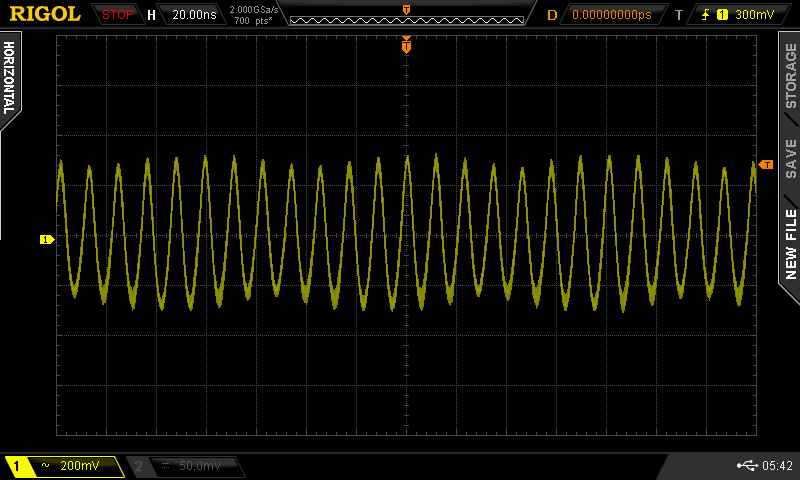

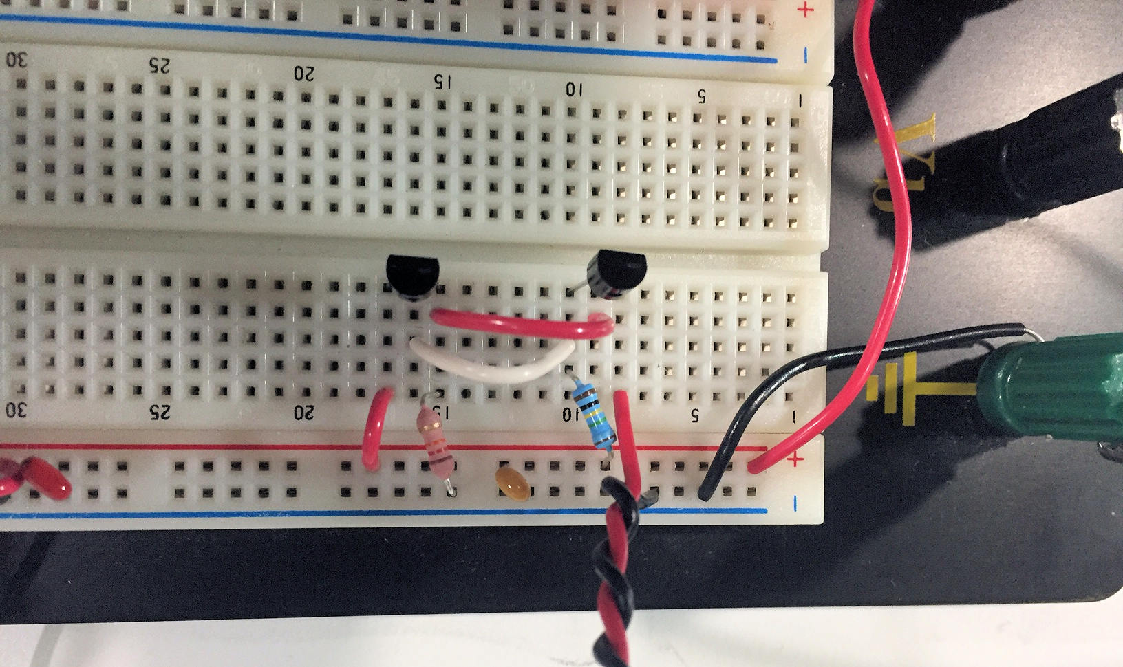

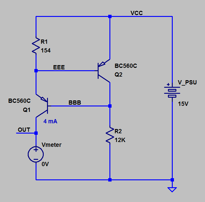

People keep saying this [2T shunt feedback current sources oscillate] but I've never had a problem personally.
Here's an experiment I performed 15 minutes ago. The scope probe is connected to node OUT which is oscillating quite badly.
Q2 is on the left (emitter tied to VCC) and Q1 is on the right.
node EEE is the horizontal white wire
node BBB is the horizontal red wire
12K collector resistor (brown body) at left
154R emitter resistor (blue body) at right
0.1uF bypass capacitor, yellow body
The same circuit with the same component values is on a 2 layer PCB with ground pours, and it oscillates too. I copied it to the solderless breadboard seen here, to experiment with base stoppers. As you can see it oscillates on the solderless breadboard too.

C6 has a huge impact on high frequency distortion. At 20khz, 0.018% to 0.033% if I increase it from 47p to 100p for example. I did move C6's right leg from the emitter of Q5 to the emitter of Q6.
This amp has to be fairly stable operating from a wide range of voltages. I haven't tried yet. Voltage regulation to the LTP, I thought, may help this. Perhaps just the CCS is enough.
My supply is an SMPS.

You made a pcb to test it?
Did u try placing a capacitor across collector and emitter to slow it down? Hopefully to DC.
I lol'd at a thought I just had. K.I.S.S. Keep It Stable Stupid.
This is not directed at you in any way. It was just twist on the old saying. 😀

What if you put a 0.1uF capacitor between the collector and emitter of Q2?
Valery

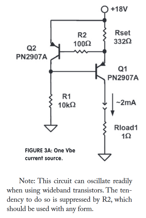

Below is a snip from Walt Jung's article "Sources 101"
_
Well, I know the result ))
I'm using this kind of arrangement with 2 x 2N5551, no base stopper and the cap across the voltage reference transistor. It never oscillates.
However, both Walt Jung and you are right for sure - wide bandwidth transistors must be used with caution here and both the base stopper and reference-shunting capacitor are the good things to have.
