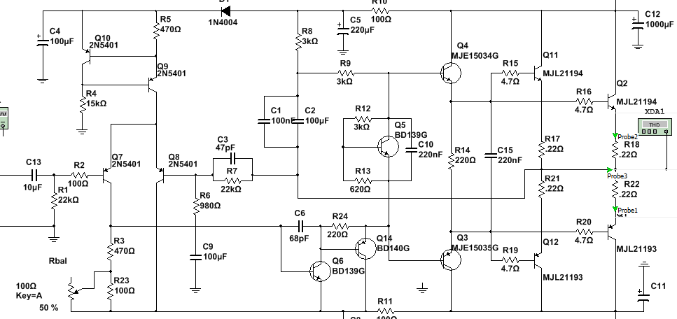

I built a variation of this amplifier with good results. I decided to start over with this and do two pairs output transistors. I intend to drive a 4 ohm load.
R13 will have a trimmer in series with it before I do a PCB layout. For simulation, I try to use as few variables as possible to avoid confusing myself or getting lost.
R18 has 10.7mv. Idle current is 48.7ma in each output device. This should be ok for the MJL21193/4.
C10 raised to 220n in the emulator. I think my working boards had 100n across the idle servo. Layout is good and very stable.
How do you feel about the choice of MJE15034/5 as drivers? They are TO220. I don't think a BD139/140 would drive 2 pair MJE21193/4.
Those output transistors are very stout and two pairs will have no problems with 45V rails driving 4 ohm speakers. Those 50W MJE's are also very robust and adequately heatsinked will be able to drive a lot of current into those outputs, which is essential, because one drawback of the MJL's is that their hFE isn't particularly wonderful.
In fact the hFE of those drivers isn't that great either, so the one real problem with this OPS is that it doesn't have a lot of current gain, particularly for the stated usage.
I generally bias the driver stage HOT and eliminate the speed up cap, C15, altogether, although your arrangement is probably more conventional.
I'd buffer the VA stage with something like a BD140, which increase the Zin of OPS and increase loop gain. Then the VA transistor, Q6, can be changed to something smaller, faster and generally more suitable such as a KSC1845 running at about 2-3mA and bootstrapped to the VAS buffer with a 220 or 330 ohm resistor.
You absolutely need a zobel on the output and probably also the usual output inductor. I hardly ever both with the inductor but its best to include it if unsure. You probably want some HF rail decoupling caps.
All-in-all this is a very conventional and straight-forward design.

That was my next worry was if the VAS would provide enough current. Could a darlington be used in a VAS?
Something like this?
The above modification did reduce distortion.
10hz 147w .025%
20hz 148.8w .025%
100hz 150w .025%
1khz 150w .026%
10khz 149w .041%
20khz 144w .054%
30khz 137.5w .098%
EDIT - Those numbers are wrong. I forgot to re-balance the LTP. Here are the correct figures.

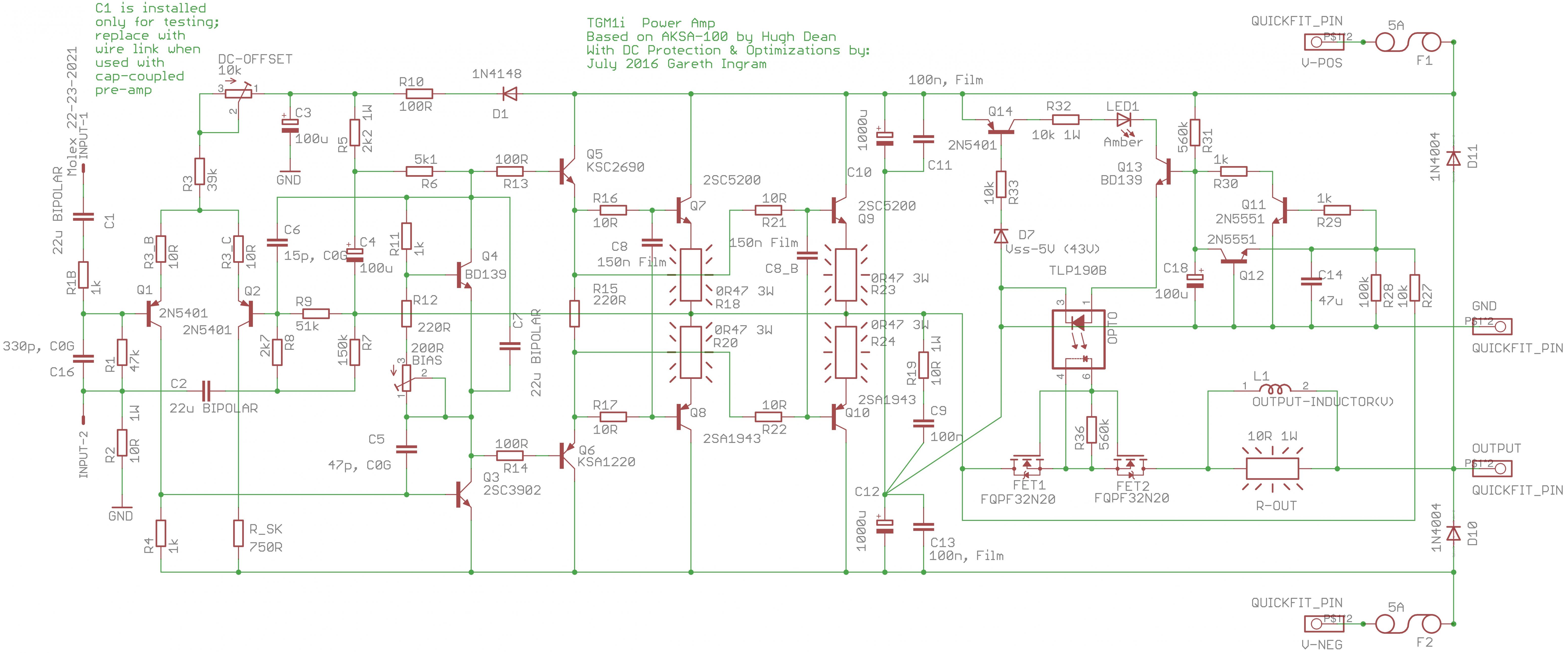

How do you like the sound and performance? Which drivers did you use? Schematic available?
I've only run it briefly and I liked what I heard. I have previously built a clone of the lower power AKSA, many years ago and like that one too.
I ended up using TO-126 footprint drivers because my pcb layout had it baked-in. That was not my original intention - I have the AKSA drivers and was going to use them but used the wrong footprint. I did a bit of research on TO-126 drivers and after comparing different spec. sheets and reading all the recommendations on this forum I decided on the KSC2690 / KSA1220 pair available from DigiKey.
The schematic I used is essentially the AKSA 100W power amp. However, I find that I like to have dc-speaker protection built-in so my design includes that onto the pcb. It not only provides dc-protection but a modest turn-on delay and quick speaker disconnect when powered-off. This additional circuitry makes the schematic look more complicated than the basic amplifier but it takes up relatively little space on the pcb.
My goal was the AKSA sound. There are many 'improvements' you can make to the circuit. The buffered (Darlington) VAS adds greatly to the open loop gain and will reduce distortion but it's no longer the AKSA (I do have the provision for an additional transistor on my pcb but do not use it for this reason). In the end, if you want something with very low distortion that sounds amazing then I'd point you in a different direction altogether (search for TGM8) but if you like the bootstrap AKSA then I'd say 'go for it'.

small correction - I ended up using a 10uf cap for C1 (not 22uF) and 2k2 from R9 (not 2k7) and I think I have 3A fuses (instead of 5A).
You mean R8?
What is C6 for?
Thanks for the schematic. I'll have to look into those drivers but I think I'll be ok with the MJE15034/5.
I intended on using a couple UPC1237 protection boards off ebay. Sort of a quick and easy solution to that. What are the pros and cons of shunting the driver's base using a transistor and driving that with the voltage across the emitter resistor? Current limiting I guess.

yes R8You mean R8?
phase lead compensation, works in concert with C5 allowing more stability with lower values of C5 - you can try different values of C5 to suit your ears over a range of about 30pF to 100pF. I liked 47pF when using C0G capacitors. The AKSA uses silva-mica capacitors.What is C6 for?
The design already has low enough distortion in my opinion, for this topology, so better to focus on the practical things.
Referring to your most recently posted schematic:
R17,18,21 and 22 are fairly low, good for minimal distortion, but makes device matching more critical and thermal stability less robust. If you've done this before then no problem, but if not, I'd recommend starting with 0R47.
You could add the provision for base stopper resistors on the drivers (Q3 and Q4); I used 100R but you might do fine with half that.
The bias is set by R13? - you want to put a potentiometer in series with R13. Don't remove R13, just add a potentiometer of, say 500R max with 25 turns (sealed unit) and reduce R13 to 470R.
R8 needs to be at least a 1W rated resistor, it takes the brunt of the bootstrap swinging up and down. Where's your zobel (R + C) on the output and an output inductor ? (look at my schematic)
You could add the provision for emitter degeneration on the LTP devices, Q7 and Q8. Even if you don't want any degeneration you could put a low value resistor in there (e.g. 2R2) to allow you to at least measure the current through each device so you can see if they are roughly balanced.
You want an r.f. filter on the input, i.e. a small capacitor (e.g. 330pF ceramic C0G) from the base of Q7 to signal ground. In conjunction with R2 (which would be better at 1K) you have a low-pass filter to stop the local radio station appearing at the input and getting 'detected' by the diode that Q7 will represent.
I'm not sure about your VAS, look at some published designs. I suspect you want C6 to go from the base of Q6 to the collector of Q14 but I'm not confident about that as I've never used a buffer after the VAS, only before it. I would recommend you read up on 'beta enhanced VAS' which places the buffer before the VAS and wraps the Cdom capacitor around the combination.
You might also want a ground-lift resistor at the input - again, look at my schematic, I think it's labelled R2.
You have your phase lead compensation, C3 from the output of the power stage. Some folk say that allows r.f. into the feedback network (r.f. picked up by your long speaker cables). I don't know if that's a real issue, but I've also placed my phase lead feedback cap from the output of the VAS (either below or above the Vbe multiplier) rather than the from the output of the power devices.
I've read that two-transistor current sources can have stability challenges and to mitigate this you put a small cap (e.g. 33p) between their bases.

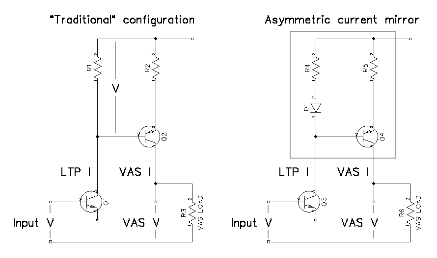

Hi Hugh, Gareth, Christian and All -
A few thoughts on the topic, if I may.
This is not something really new, however ... many designers don't use this approach.
Consider Q1, Q3 are part of LTP (can be singleton as well); Q2, Q4 are VAS transistors. R3, R6 are the VAS load equivalents (can be CCS, 2-nd push-pull shoulder, bootstrapped load, etc.).
Picture on the left - let say, traditional approach.
1) V-to-I in Q1 (non-linearity),
2) I-to-V on R1 (complex load - Cdom),
3) V-to-I in Q2 (non-linearity),
4) I-to-V on VAS load (good enough).
Two transconductance stages.
Miller capacitor is normal compensation approach in this case.
Picture on the right - current mirror as LTP load.
1) V-to-I in Q1 (non-linearity, same as before),
2) I-to-I with scaling (good enough, Cdom is not an issue any more),
3) I-to-V on VAS load (good enough).
Single transconductance stage.
This one is what I call "current drive" for myself (just one of its variants).
The only difference is D1, but now you can consider D1, Q4, R4, R5 as a single "building block" - a current mirror.
It can be improved further on - Wilson mirror, cascoded VAS output, allowing good matched small signal transistors in the mirror, etc.
This approach does not require miller capacitor - a small shunt cap in parallel with VAS load is enough for unconditional stability of the whole thing.
Overall result - better linearity and wider open loop bandwidth at the same time. As a "side effect" - all "current drive" designs are much less sensitive to external EMF, they are simply "more quiet" - just a practical observation.
What do you think?
