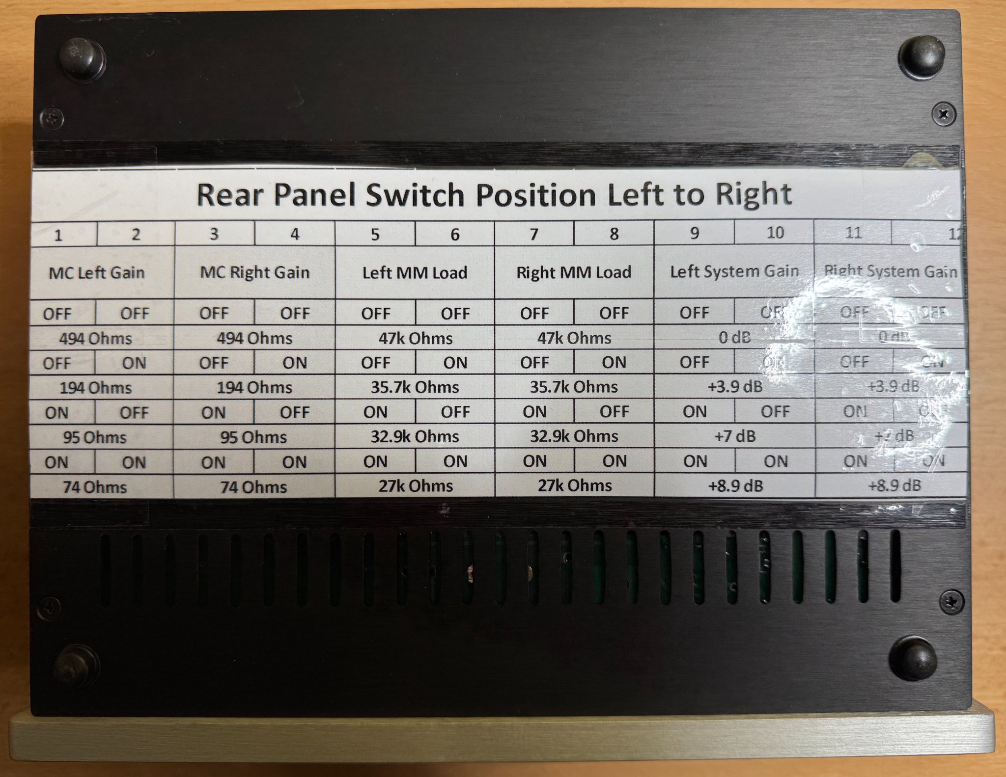

Switch 9 - 12 is only the gain of the output amplifier. I was referring to the gain of the MC input preamplifier.

There is a gain selection option! The first 4 switches set the MC amplifier gain. If you look at the user manual which is in the supplementary data pack on the AX webpage, it will show you how to set them.

The MC gain works by changing load resistor on the output of the complementary common base amplifier. So you can cater for cartridges from about 10uA output to about 100uA (in this last case, assuming you have a low coil resistance MC cart). If the switches 1-4 are all off, this leaves the load resistor at 494 ohms which is the max value. For your cart, the output is below 10uA, so we also need set the system gain stage at max gain (+9dB).

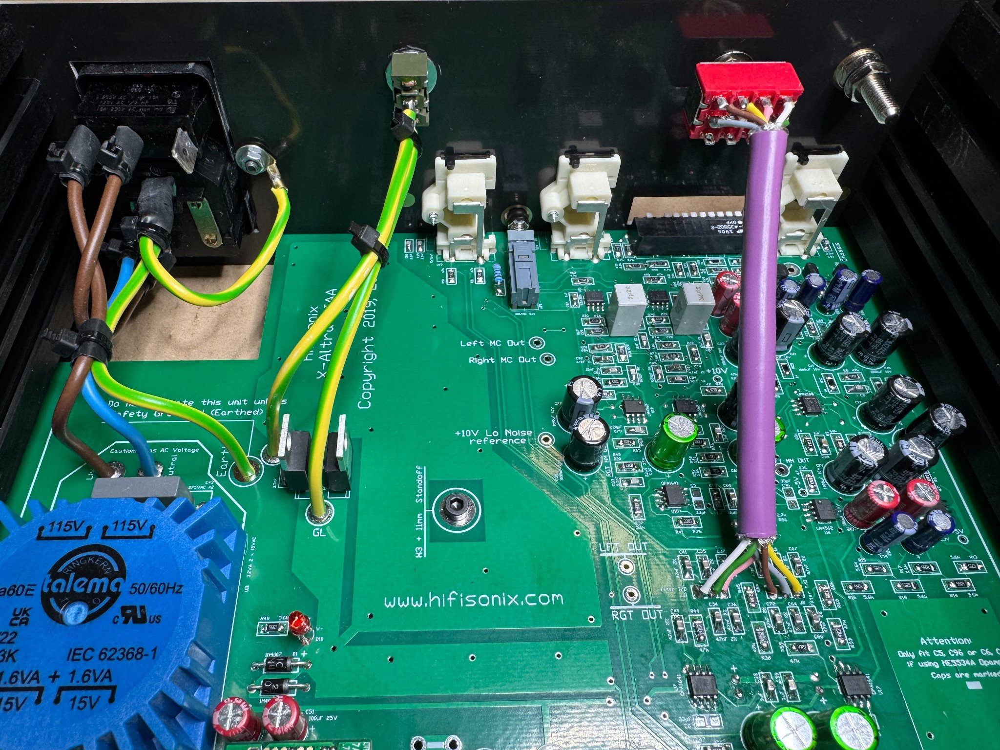

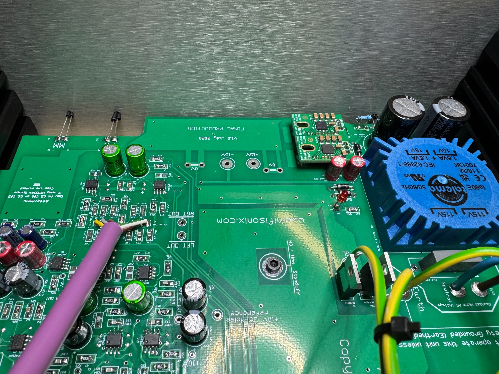

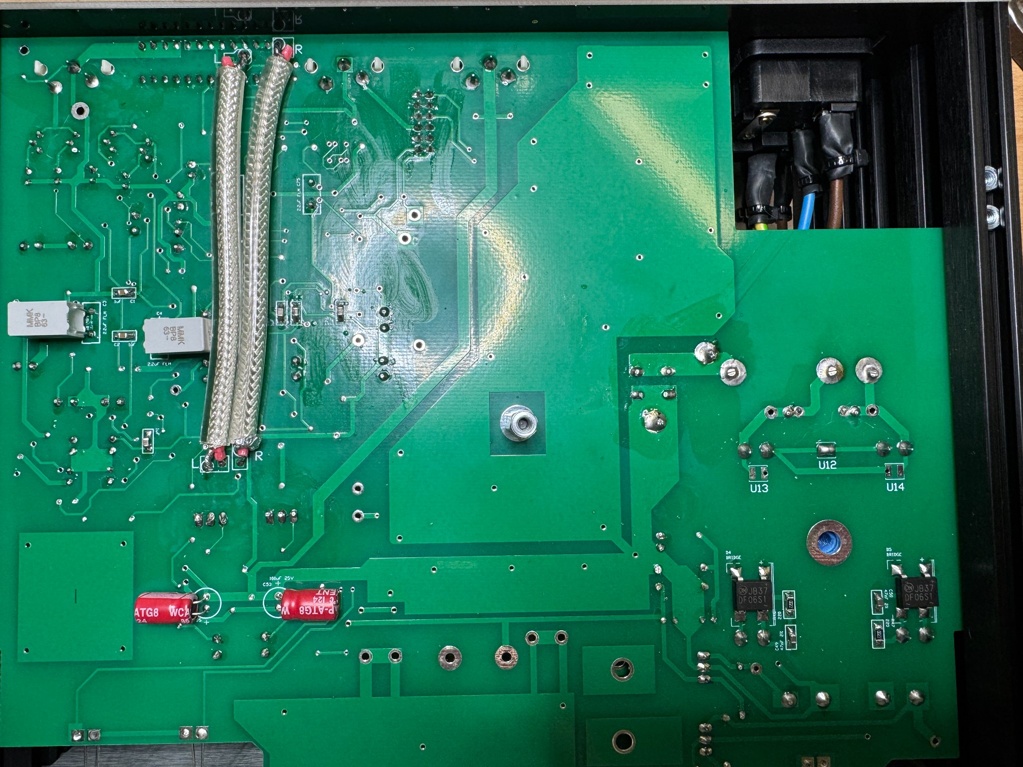

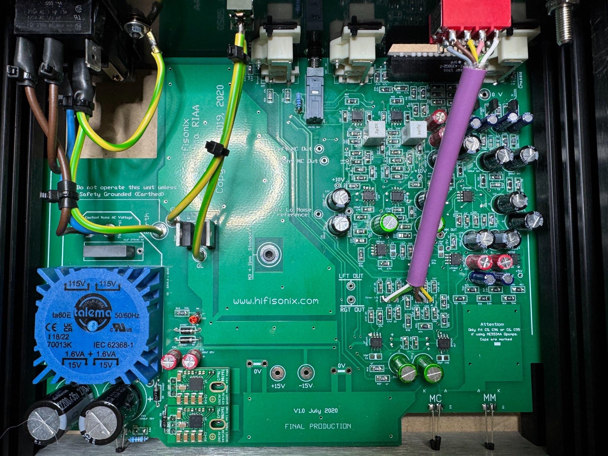

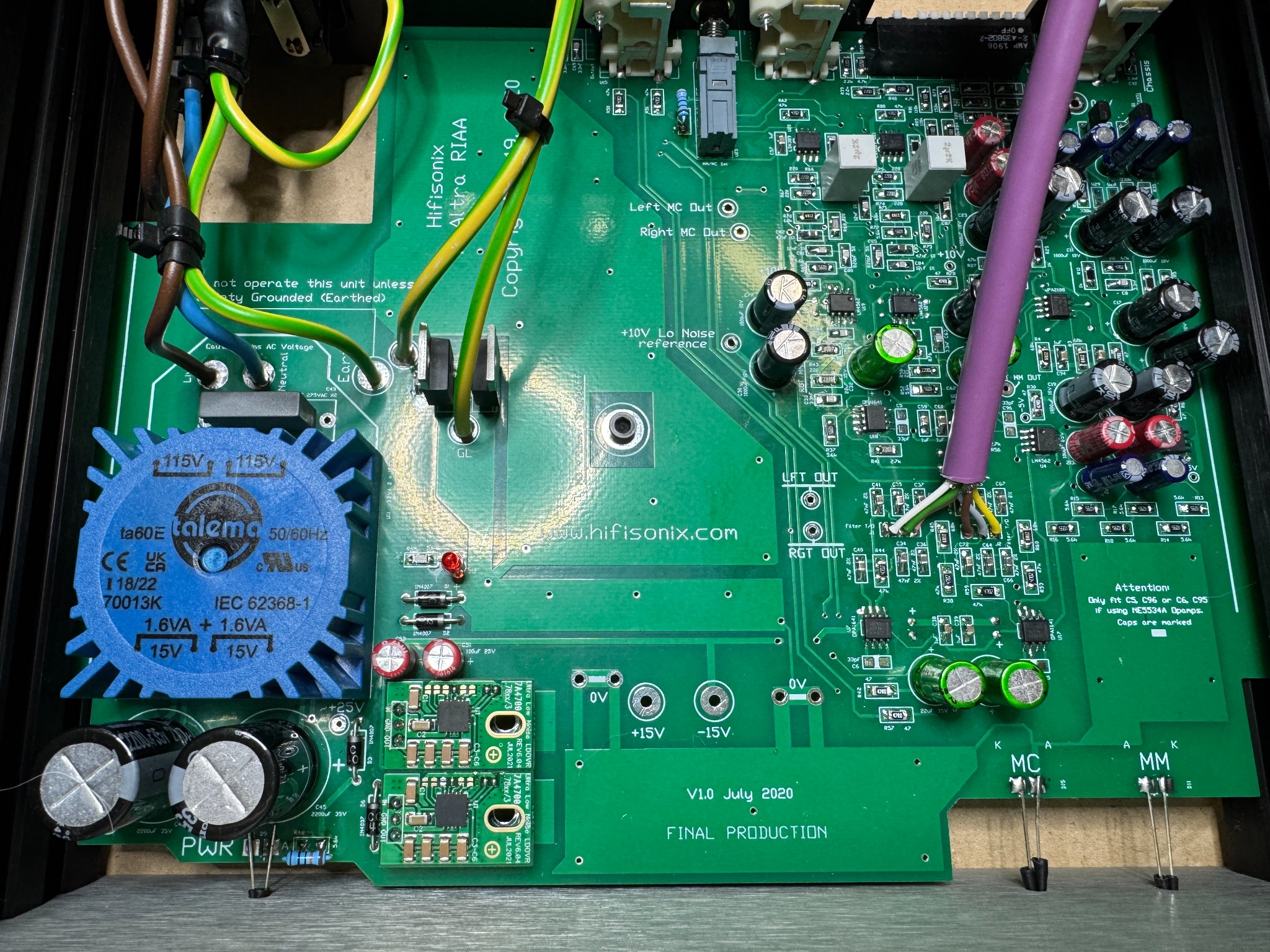

Hi.
So I finished the project last week. Yesterday and today I subjected the preamp to a listening test and I can say with a clear conscience that it is the best preamp I have heard so far.
The absolute silence is shocking. MC input and the silence is absolute. My amp is humming more too. I guess it's because I manually select and match the input transistors to the MC input. And sonically, it's really a treat. It plays really well and I highly recommend anyone interested in building to start building...
Here are some photos.

Fantastic Jardalukas! I am very happy you like the preamp and hope you will get a lot of pleasure listening to it!Hi.

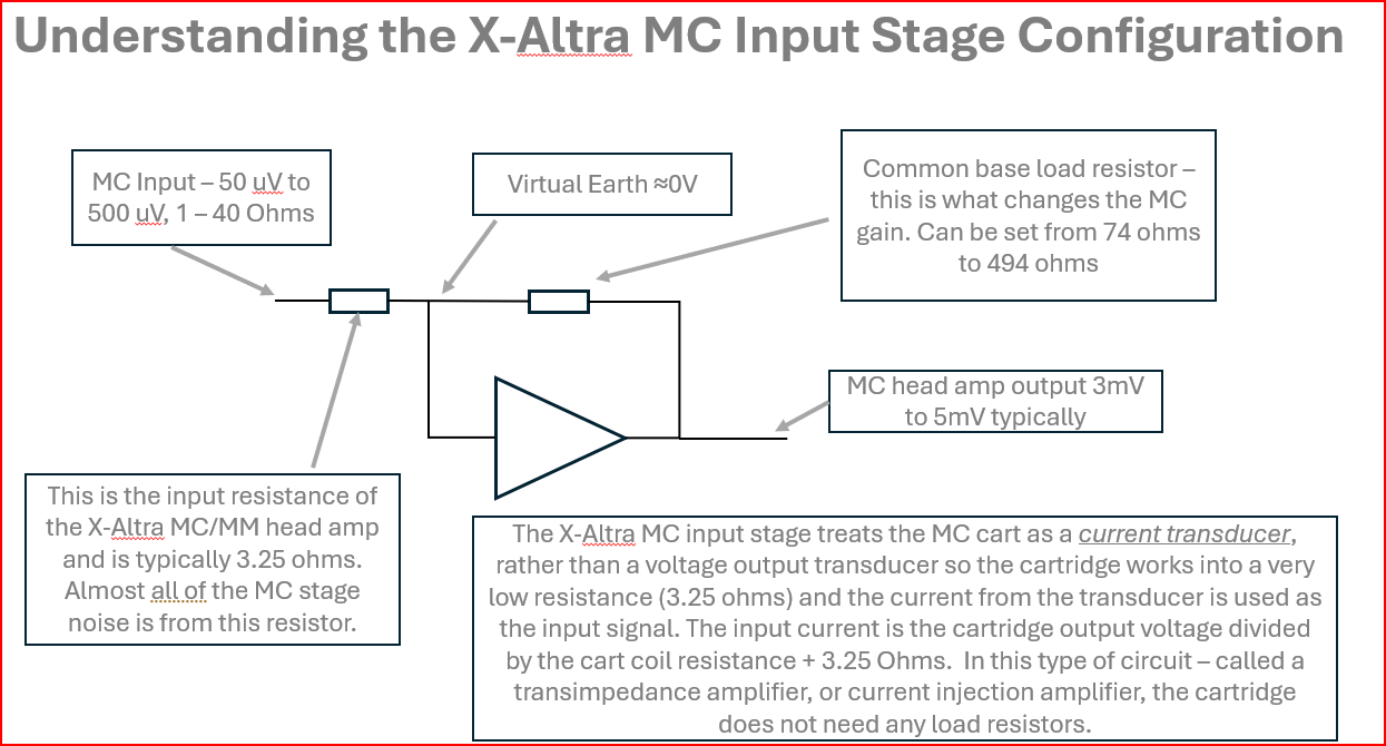

I would like to make this preamp and use it with an MC cell which is recommended to be used with a load of over 400 ohms.
Is it possible to provide an adjustable resistive load and if so at what level should this modification be carried out?
On the other hand, the same for capacitives loads. On this subject, what are the capacitives loads of the MM and MC inputs of the preamp?
Regards.
Regards.
Jean-Marc, this picture explains how the MC transimpedance aka current injection input stage works. You do not need the normal load resistor (usually 100-400 ohms) for this circuit topology that conventional voltage-type MC preamplifiers use. To calculate the input current to the X-Altra MC, take your cartridge output voltage and divide it by the [coil resistance + 3.25] ohms. This current flows through the amplifier output load resistor (switchable between 74 and 494 Ohms) and generates the output voltage which in most cases lies between 3 and 5 mV, but even up to 10mV is ok because the following stage (the MM RIAA amp) has 31 dB overload at 5mV - so even at 10mV you still have 24 dB overload.

Very nice looking build BTW! 👍 👍Hi.
